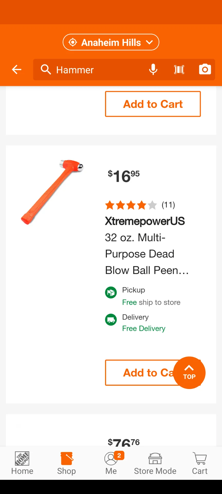

Anyway, I'm in the market for a good general purpose, primarily for automotive use type of hammer.
What do you guys recommend weight wise and any other things I should consider?
Edit.: would something like this be a good all around choice?

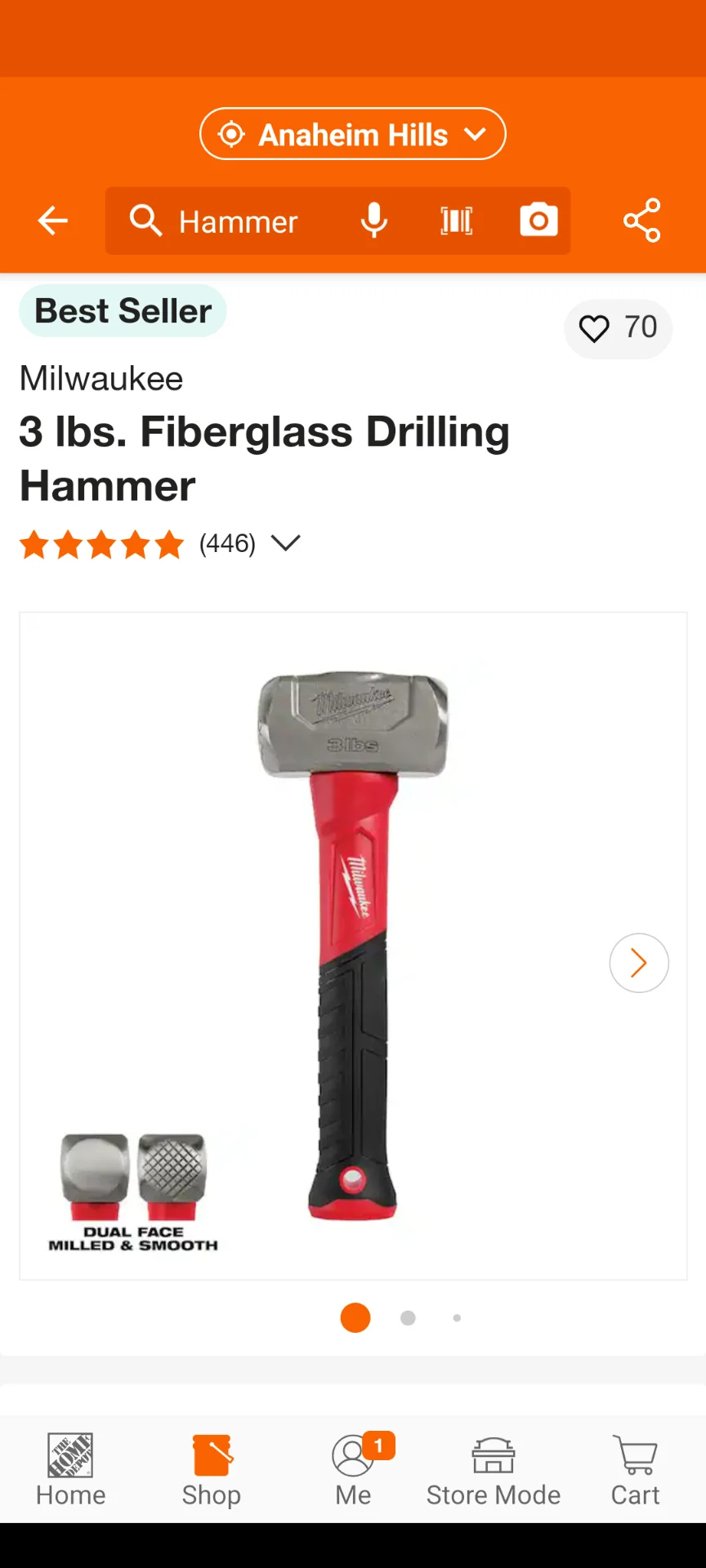

For the knuckles, I like two hammers: 3# and 5#. I set the 3# on the knuckle and hit with the 5#. Seems to keep the knuckle in better shape. Hammers are nothing special--HF or HD. Agree with longer handle on the heavier hammer.
Reactions: GregBelleville
If your first task is to get the knuckles off, then I think lighter than 3# would not be a good idea.
Yeah the last thing I want is to go back to home Depot with my tail between my legs to go look for a heavier hammer. 3 pounds+ it will be then.
Would a dead blow be a good choice for a general purpose hammer, or are they for more specialized situations?
Hitting a hammer with a hammer is not a good idea.

Personally, I wouldn’t use a dead blow hammer for what you’re trying to do. You’re looking for impact force, not energy transfer.
look up a dead blow ball peen. They are very nice for the type of work you’re doing. I have an icon I like, but it’s not that old, so no idea if it will last.
I'm on my second Mac Tools 32oz ball peen dead blow. The first lasted over 20 years and eventually failed because the plastic dried out enough that it cracked badly. Mac's warranty covered it, but they required me to ship it to them, so it cost me a few bucks. That said, I don't reach for that hammer when I want to use impact to break things loose. I've found a 32oz non-dead blow hammer to work better. My theory, which is just that - a theory, is that you want the highest impulse force you can get in that case, and a dead blow is designed to impart more total energy, but the peak force is less. Has my thinking been wrong all these years? (honest question)

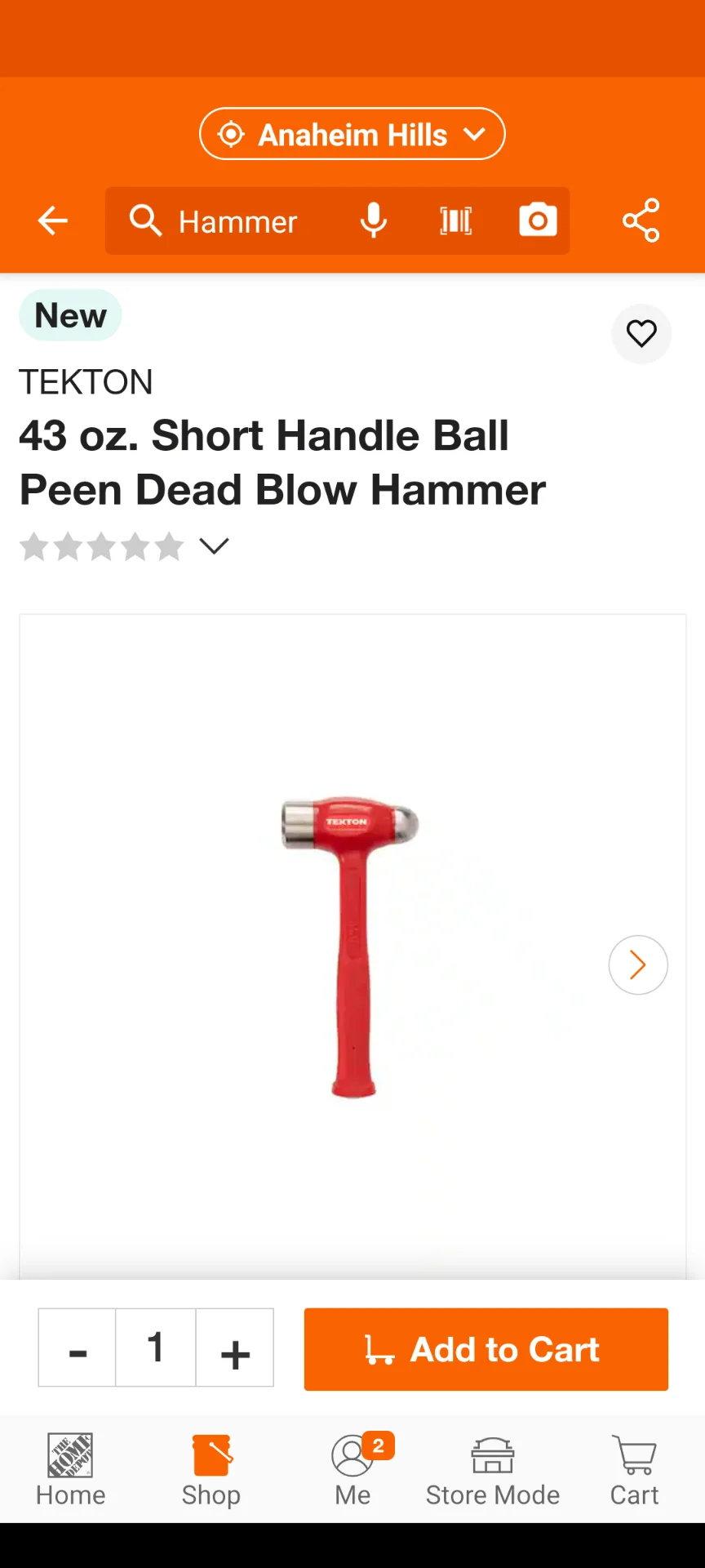

I prefer to refer to my build as lean, not skinny. 😜 I can do 15 pullups but I only weigh 175 lbs.
I think I'll be looking for a dead blow ball peen in the 40+ oz range.
I don't know that its wrong, but my hands sure appreciate the lack of vibration that translates up the handle with the dead blow vs a traditional sledge. I've got both, and I grab the dead blow 9 out of 10 times now. I also feel like the last time I did ball joints, I hit the knuckle far less aggressively and fewer times with the dead blow vs using my traditional sledge.
@Rickyd's suggestion of using a bit of pressure from a prybar while striking is a good one too. Popping tie rod ends out of the knuckles is a one swing affair with a prybar and a dead blow.
