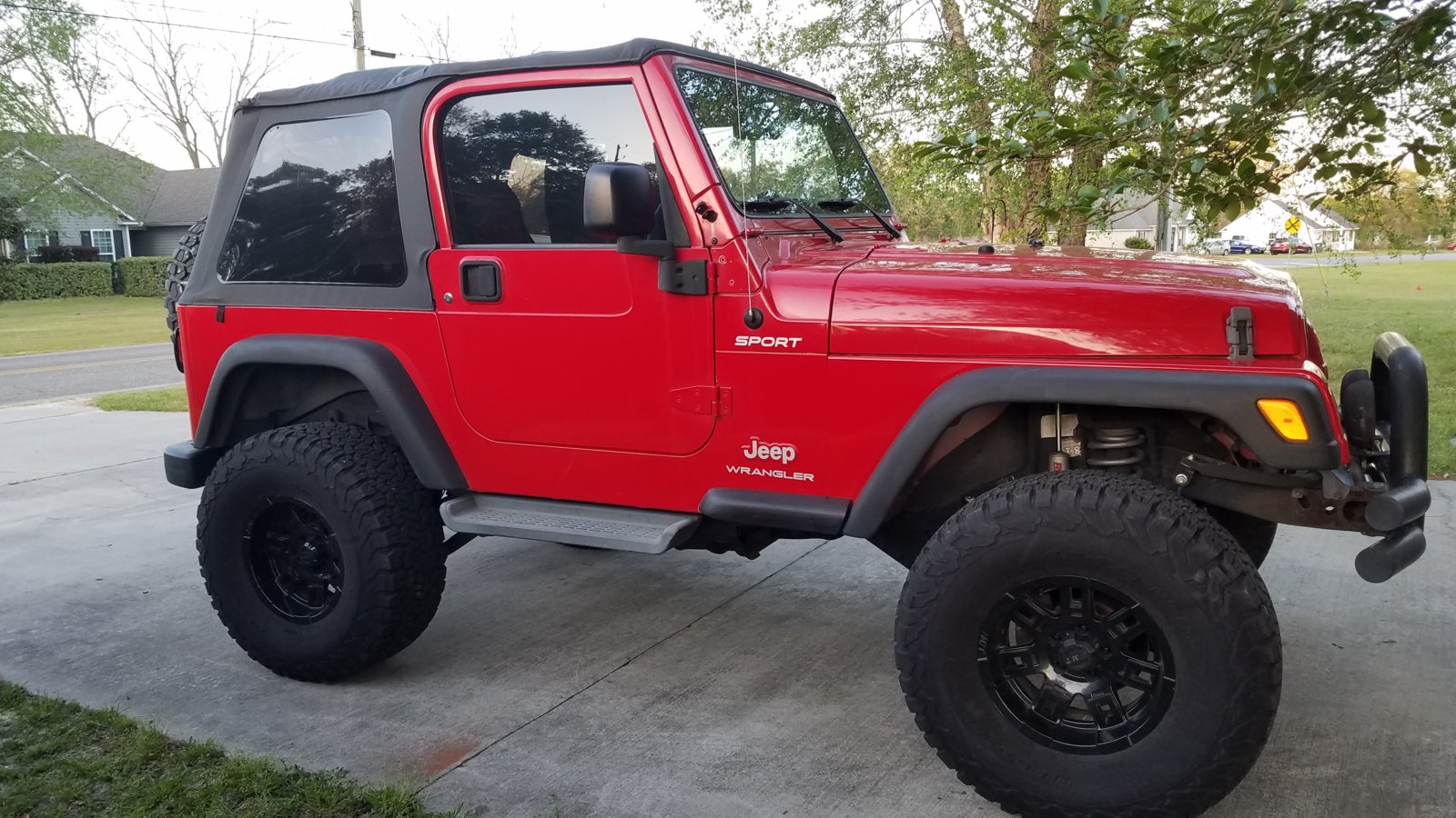

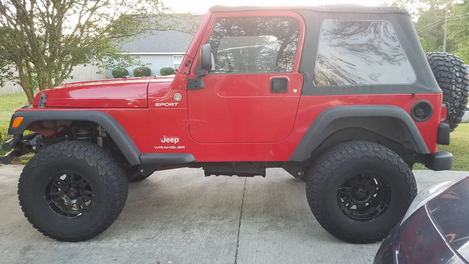

Never had a Jeep before, we bought a 2005 Wrangler, it is lifted, I am guessing 4"s And I have now learned by the cheap and crappy Rough Country lift kit, Guess I should have read the boards here first (will start by changing the shocks and go from there later) Anyway, I have bad knees and my better half can barely get in it with the regular sidestep. I bought one brand but it was only an inch lower or so.
So my ?? what is a good step that will be about 8"-10" lower than the side of the jeep or lower by 6" -8" than the stock steps? TIA

Indeed and thanks. I'm guessing without yet measuring the lift kit on it being 4". I'm not sure how to tell exactly, as we bought it that way. It has new 33" bf Goodrich all terrain tires. I'm 5'7" and Renee an inch shorter. With my height and bad knees I have to pull myself in with the steering wheel. I put the step on the passenger side. The pressed in nuts on my side of the frame slip and spin, so it won't tighten. I'll take some pics and maybe someone can help with a step.
We are also strongly considering lowering it to stick also. Not sure what parts we would need besides shocks. I have no other original suspension parts (if any came off for the lift kit)
Step on passenger side needs to be 3"-6" lower
