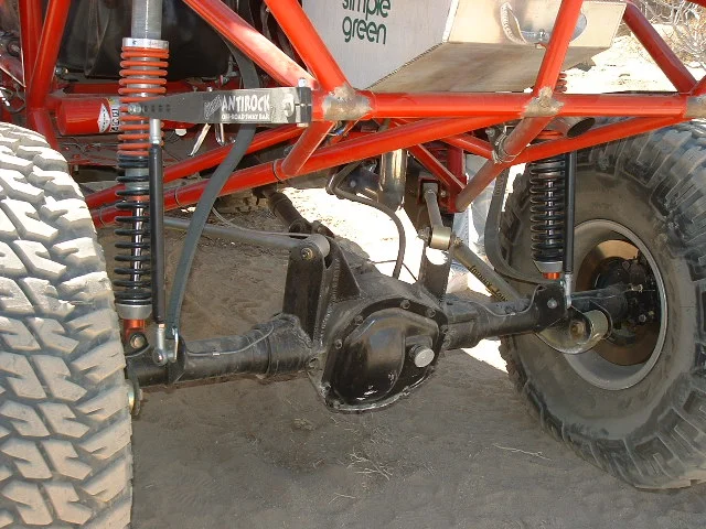

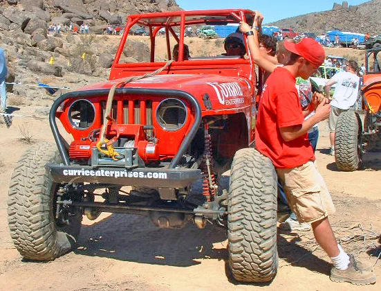

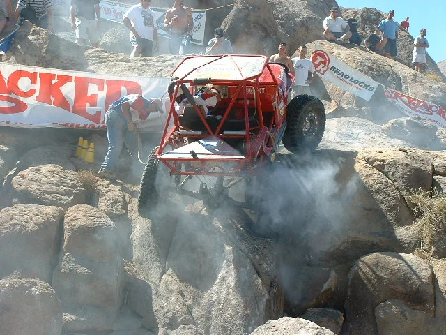

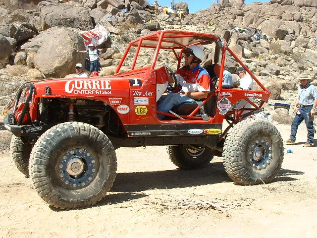

An Antirock definitely does NOT reduce usable articulation. If it did it wouldn't have helped John Currie to win the overall ARCA series rock crawling national championship. He was running Antirocks front and rear on his Fireant TJ, I was fortunate to have been there to have taken these photos.Will the AR front still allow full articulation? Say using all available travel from a 12” shock?
I understand how valuable it is and why it is used. Not doubting it effectiveness. Just wondering if all 12” of shock would still be utilized?An Antirock definitely does NOT reduce usable articulation. If it did it wouldn't have helped John Currie to win the overall ARCA series rock crawling national championship. He was running Antirocks front and rear on his Fireant TJ, I was fortunate to have been there to have taken these photos.
View attachment 253931View attachment 253932View attachment 253933View attachment 253934
YesWill the AR front still allow full articulation? Say using all available travel from a 12” shock?
Yes... Just wondering if all 12” of shock would still be utilized?
The key is to understand that if everything else is set up properly, an Antirock will not restrict the axle's ability to provide all the usable flex the suspension can produce. There is a limit to usable flex where you still have downforce available from the springs to help the tire maintain contact with the ground. Without sufficient downforce available on the tire, that is when flex/articulation becomes unusable.I understand how valuable it is and why it is used. Not doubting it effectiveness. Just wondering if all 12” of shock would still be utilized?
Thanks. Was just curious if there was a point at which we could have too much shock travel. More than the AR would ever allow? Again was not stirring the pot. At least not this time.......The key is to understand that if everything else is set up properly, an Antirock will not restrict the axle's ability to provide all the usable flex the suspension can produce. There is a limit to usable flex where you still have downforce available from the springs to help the tire maintain contact with the ground. Without sufficient downforce available on the tire, that is when flex/articulation becomes unusable.
Wow thats hardly a TJ after all those mods! HahaAn Antirock definitely does NOT reduce usable articulation. If it did it wouldn't have helped John Currie to win the overall ARCA series rock crawling national championship. He was running Antirocks front and rear on his Fireant TJ, I was fortunate to have been there to have taken these photos.
4.7L Jeep V-8, Grand Cherokee 5-speed automatic, 3.01:1 Atlas II tcase. Yep it was a bitchin' work of art for sure, I loved seeing it there. At one point he rolled it upside-down and ATF leaked out through the dipstick tube and formed a large red stain on the dirt. It reminded me of a bleeding beast lol.Wow thats hardly a TJ after all those mods! Haha
What engine was he using?
It is kinda odd having 5 vs 7 lines in the grill

Ha yeah I it only barely managed to maintain the look of a TJ. By far one of the very coolest looking "TJs" ever, too bad it's relegated to life living inside of one of Currie's warehouses now.What's left of a TJ there?
