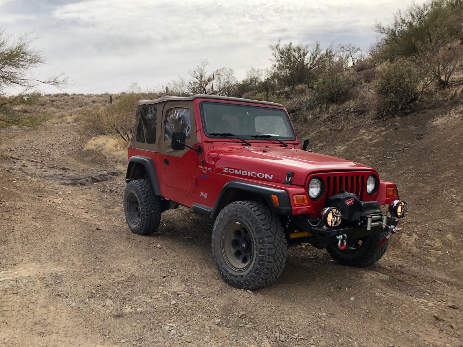

It is hard to tell with your small picture, but I am running 31x10.5x15's and mine stick out almost and inch if not an inch because my rim has a 3.75 BackSpace If I had a more positive rim they would suck in further. I kind of like my tires sticking out a bit and nobody has hassled me yet for it, so I am going to keep on keeping on, but it looks like your rims have a dish to them and I am not positive by the looks of it that a 10.5 will actually suck it into your fender.
Here is what mine looks like with a 2" lift 31x10.5x15's
Reactions: YellaTJ

I did, I competed with you with that picture, and lost! But I don't mind losing to a fine looking Jeep like yours!
Ah heck, I must have been self-consumed during that contest. Sorry! Still love the picture!
