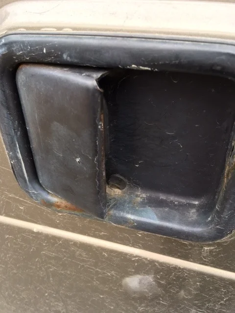

So I noticed that both of my door handles are a little floppy and makes some noise when driving and closing the doors. Before I take the doors apart to see what can be done I wanted to see if this is a common issue with an easy fix??? In the pic you can see how far they are out before engaging the mechanism.

Does this cause your door to not open on the outside? Im having that issue with my half doors, I just need to tear into it.

Yes, a simple adjustment. The clip may be broken also, necessitating replacement
Maybe I will try that tonight then, I usually have to give the door a good whack and it will open, but the last two weeks Ive been having to open via the passenger door, getting a little old that way.

May I recommend taking the door off and putting it flat on a table. it will make working on it a lot easier.

I went after mine this afternoon. This threaded piece needed to be lengthened. My handle seems a little tighter as a result
