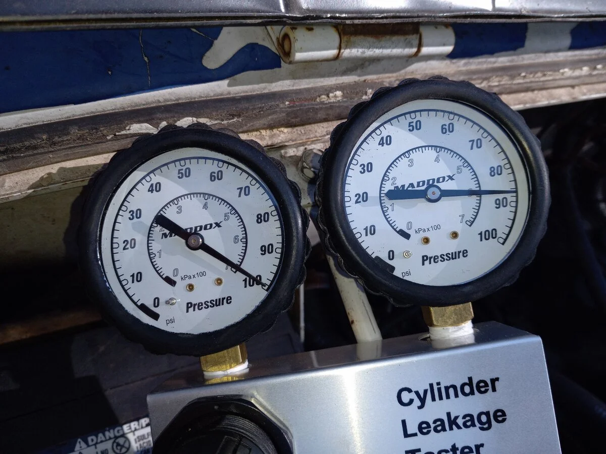

I bought a Maddoxx Leak Down Tester from Harbor Freight. I am confident I did it right. Here is what I did:
1. Turned on compressor
2. Warmed up motor
3. Insert hose into 6 cyl. I used a balloon on the other end to find the compression stroke while manually cranking
4. Remove hose. Here I used a screw driver to find TDC of the piston, while someone else cranked.
5. Attached compressor to the leak down tester. Here I calibrated the gauges to where they both read 100%
6. Attach other end from leak down tester to 6 cyl.
Result:
If I did this right, it looks like I have a 13% leak? I don't know it makes no sense. I figured I would have a bigger leak if my compression was 110.

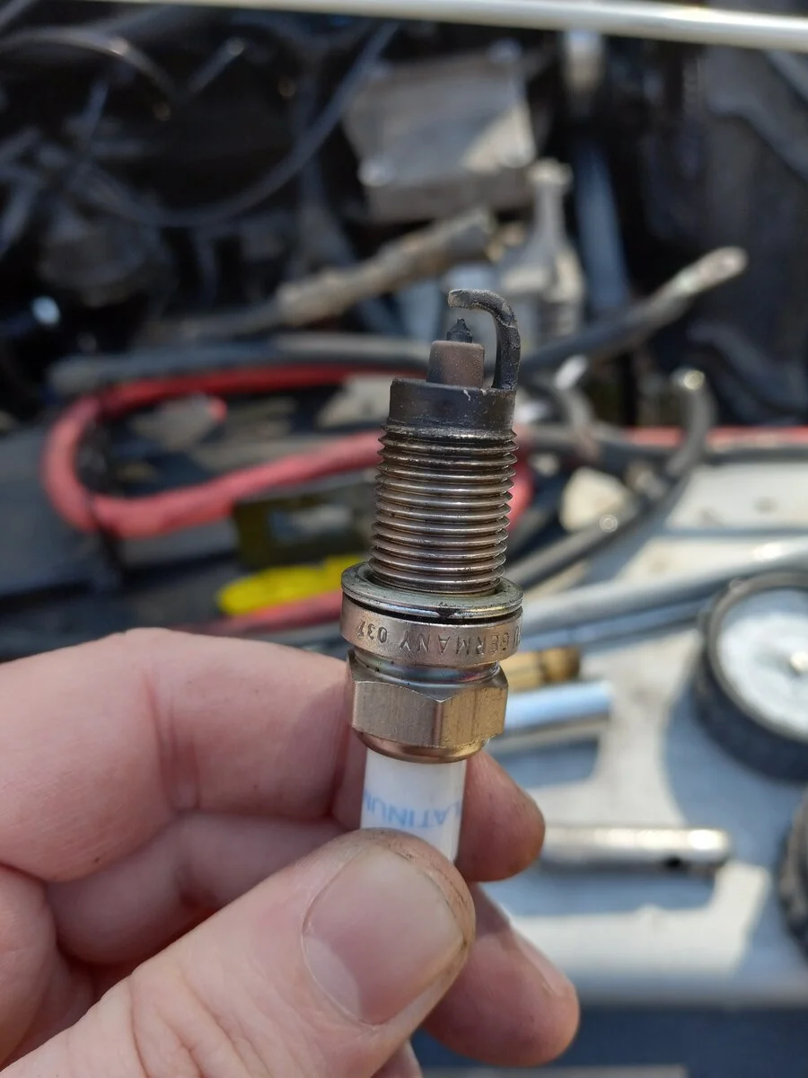

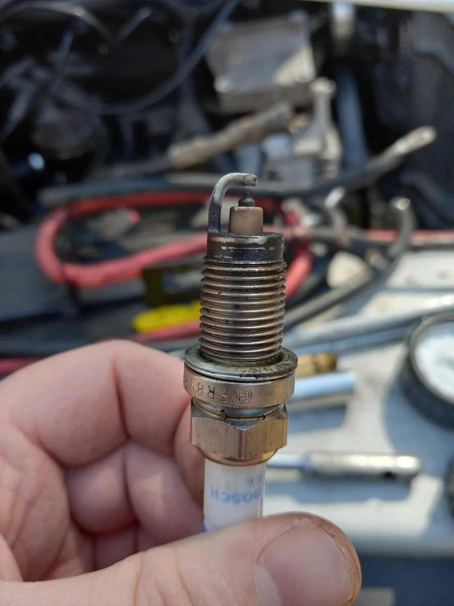

Just in case this helps any, photos of my spark plug rom 6 cyl. They are less than a year old.
