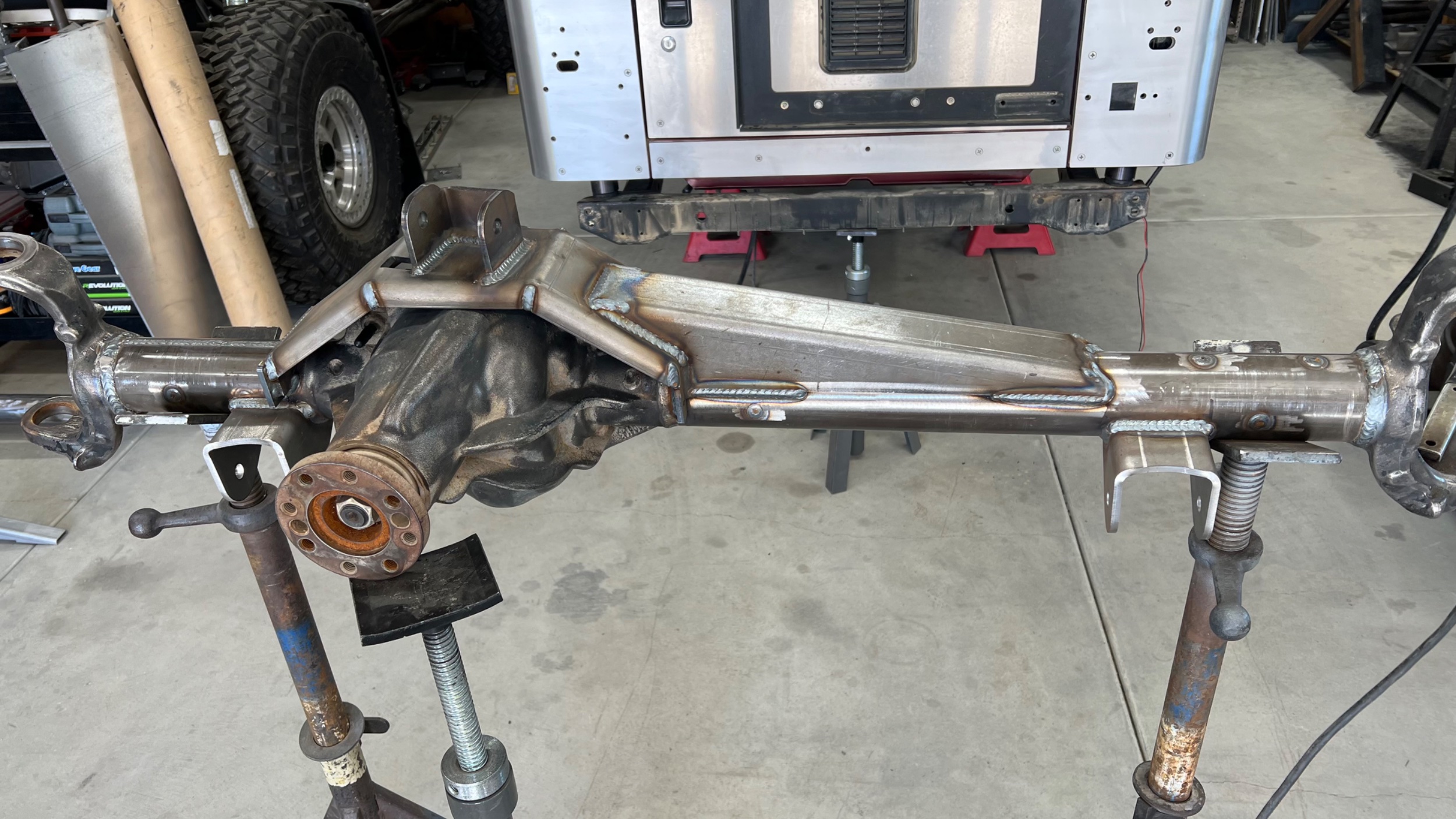

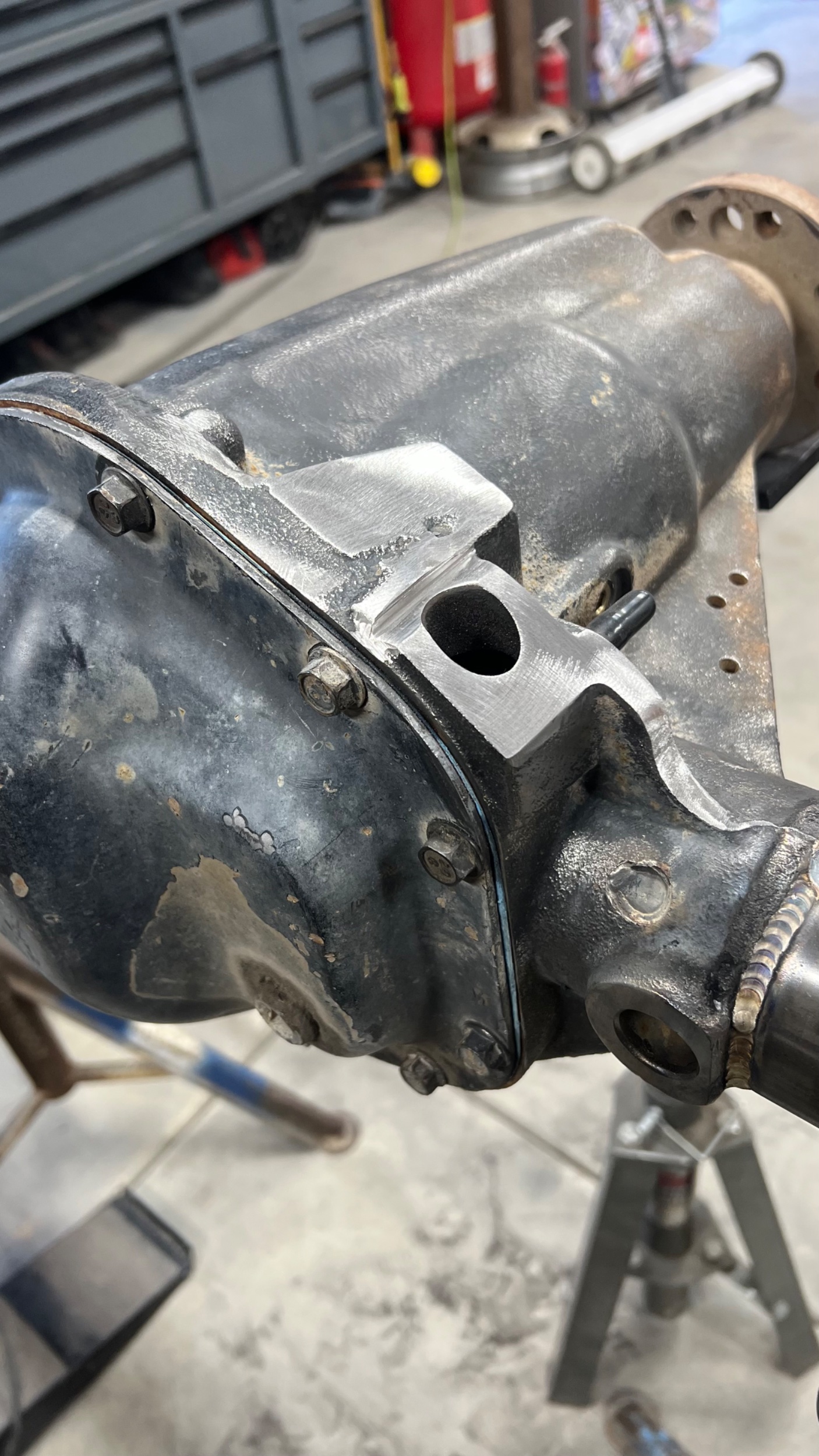

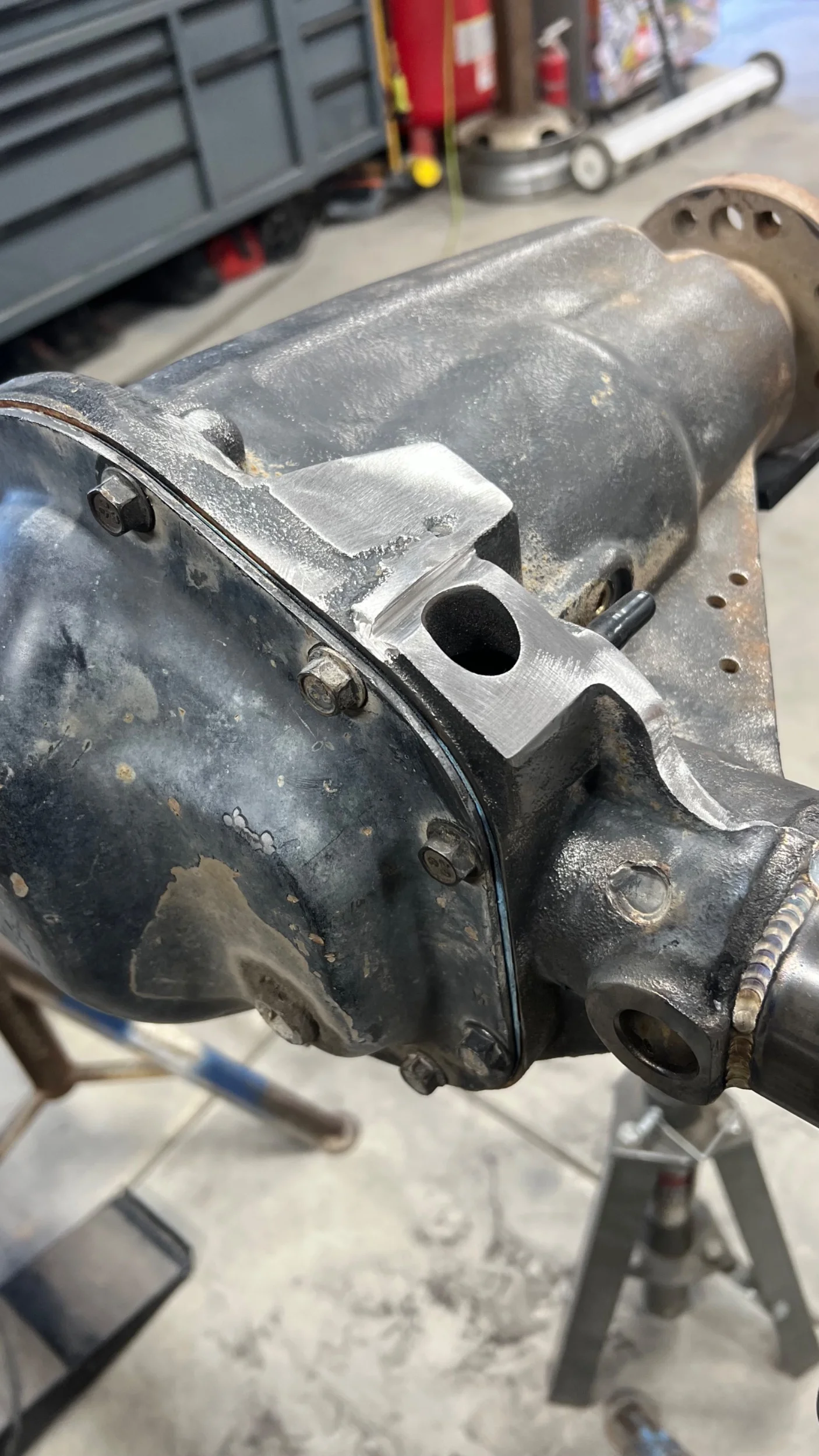

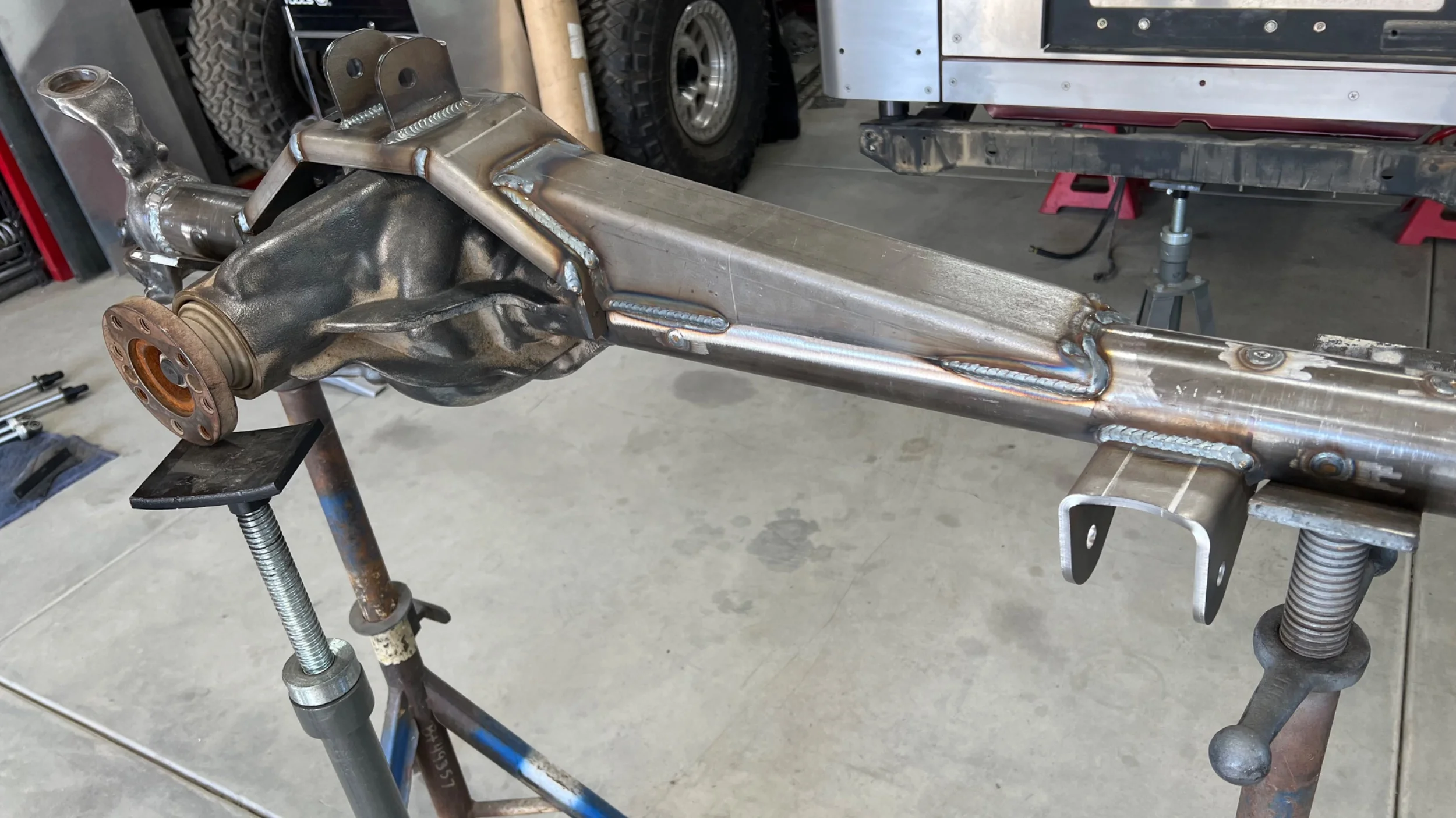

Got a free jk44 front housing that was broke in half. 3” .250 wall tube was used to sleeve the long and short sides. Got her nice and straight.

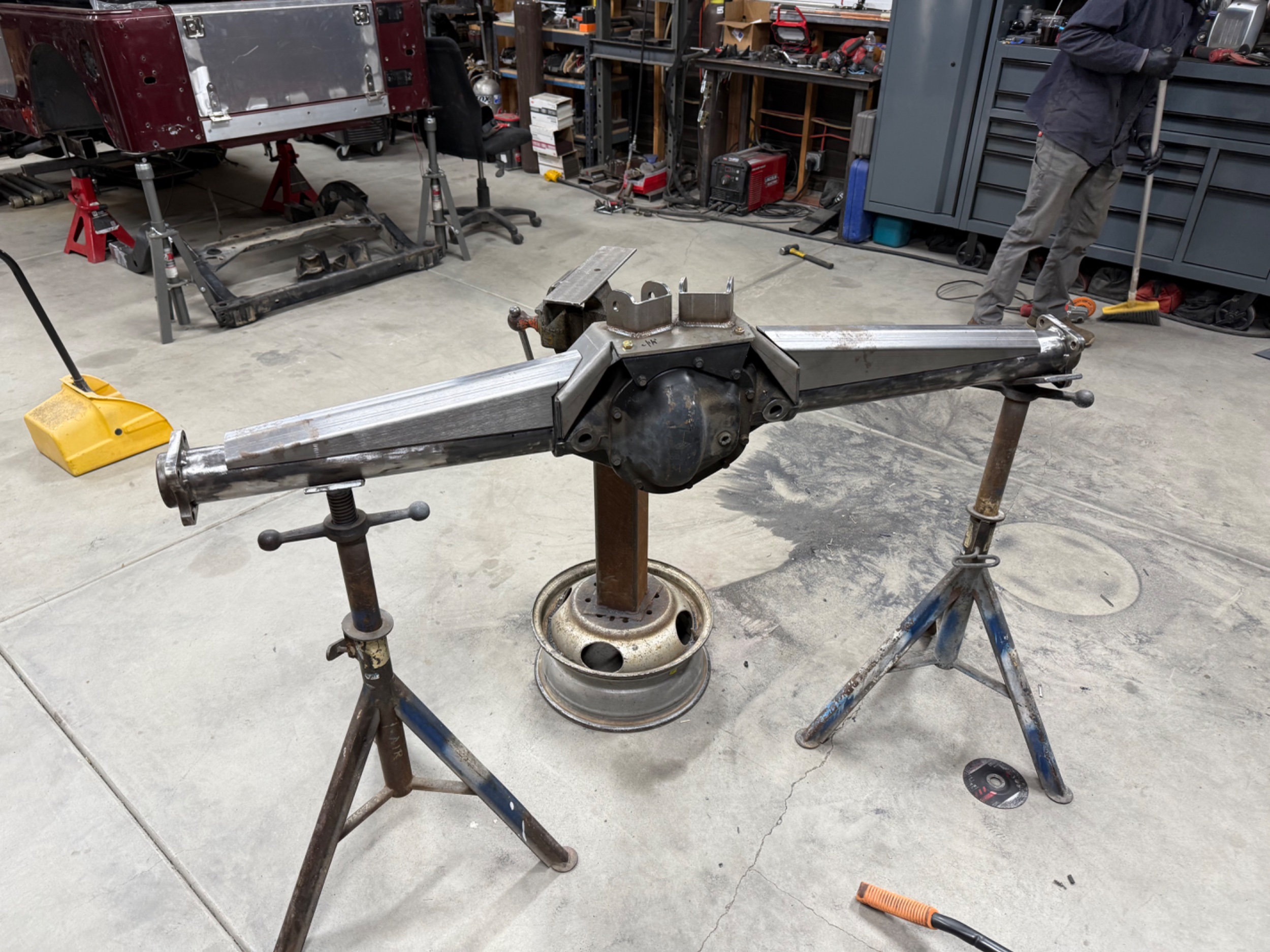

Onto the rear housing.

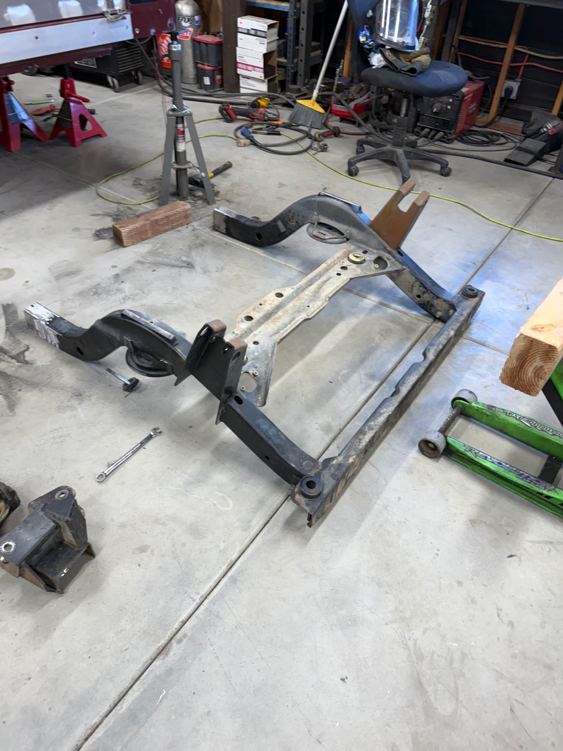

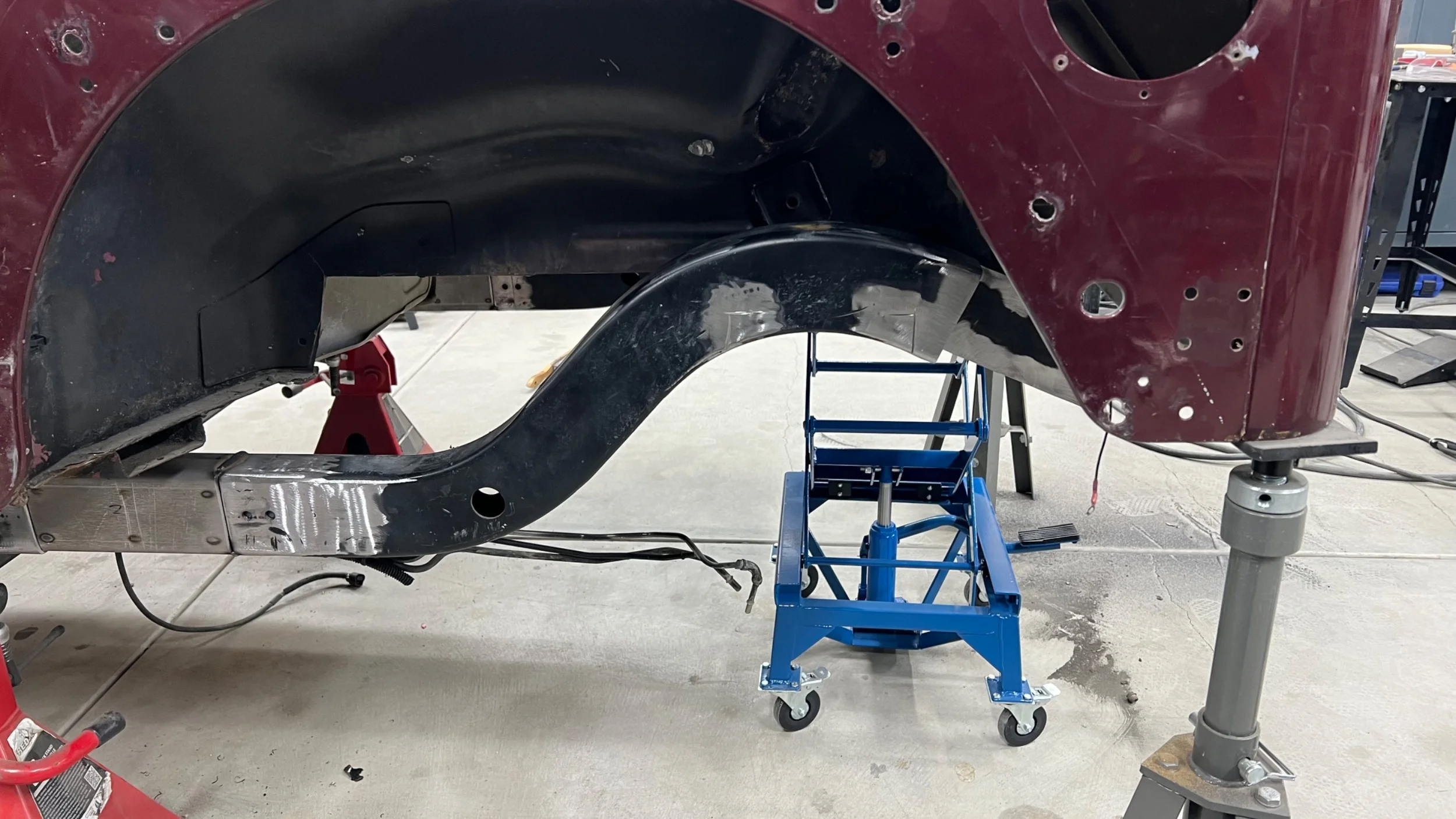

Then to cut the frame.
Good deal if you have the tools to fix it. Those welds look 🔥 where did the axle break?
Reactions: Wildman
It was broke on the long side. Didn’t quite get the full story on exactly what happened but it was a clean break. Cut out the bad section and pressed the 3” tube over the existing, straight material.
Can’t take credit for the welds but I agree they are purdy.

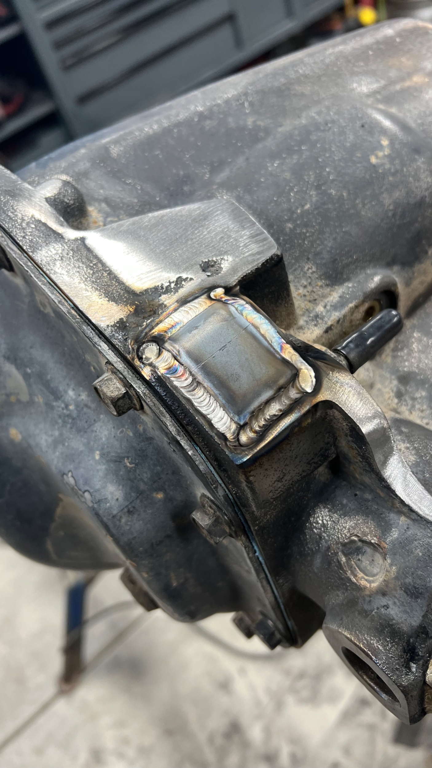

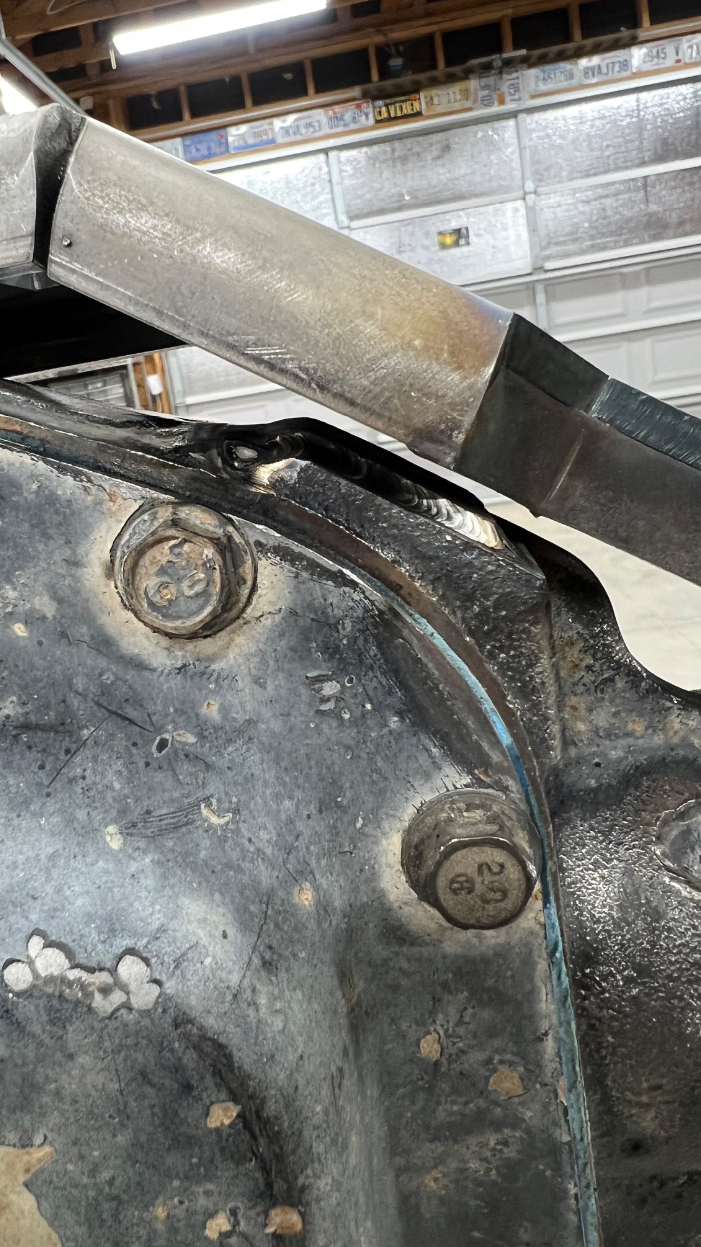

Had some interference with the JK casting for the stock Locker wiring and the truss.

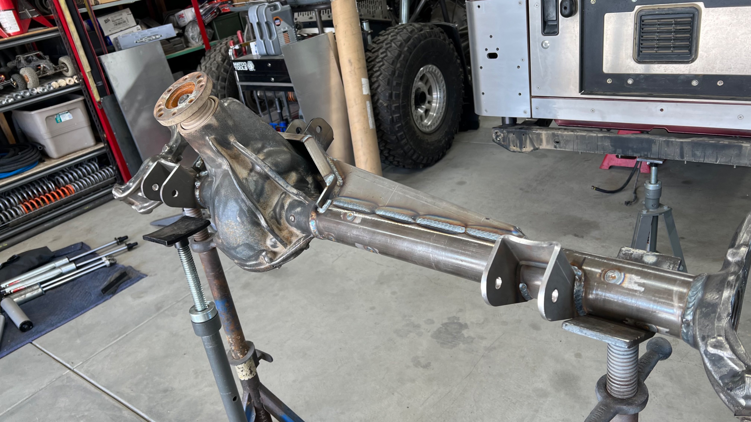

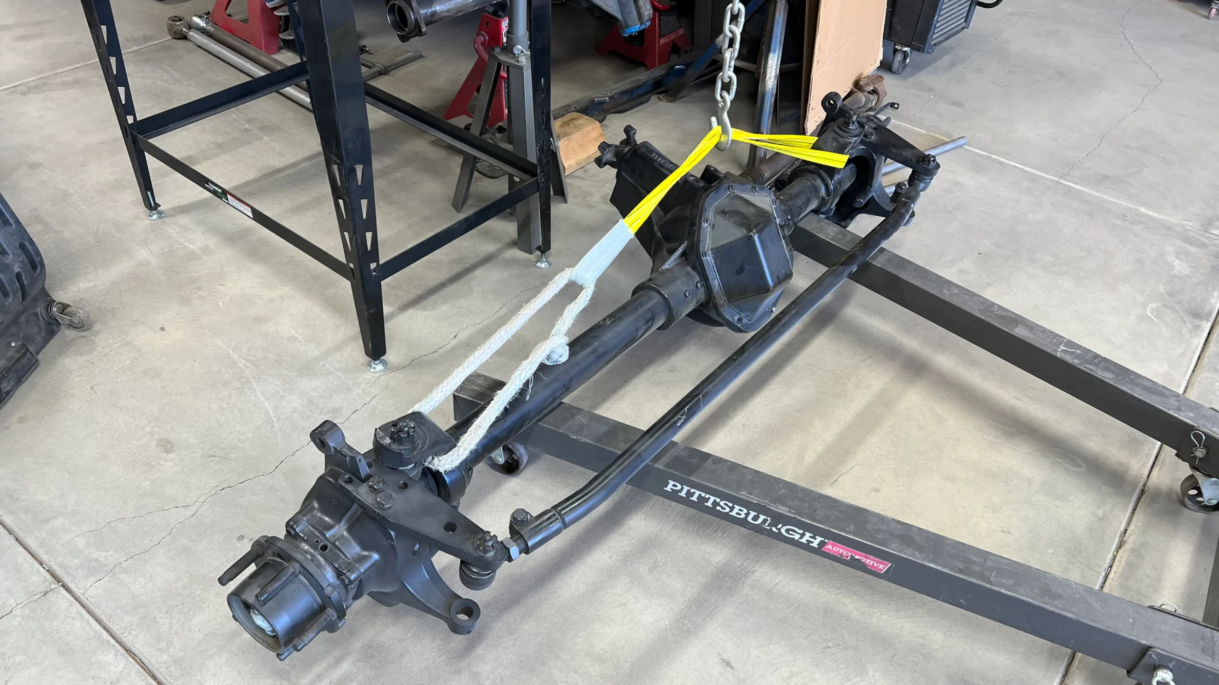

Front axle is dialed minus the track bar, sway bar, and coilover mounts which will go on when it’s fitted under the rig.
Rear axle will require modification to fit the truss over the casting. Hoping to do some fancy “stiffeners” to match the styling of the front.
The JK axles will be getting 5.38 revolution gears. Running a 30 spline arb up front with Revolution USA shafts, with their chromoly U joint which I’ve been running for a few years on my TJ width axles with success.
The rear will be getting a 35 spline ARB, Revolution discovery shafts(USA was not available at the time). Stock JK brakes for now (with special pads), if I need more brakes I will go with the Ram brake upgrade up front.

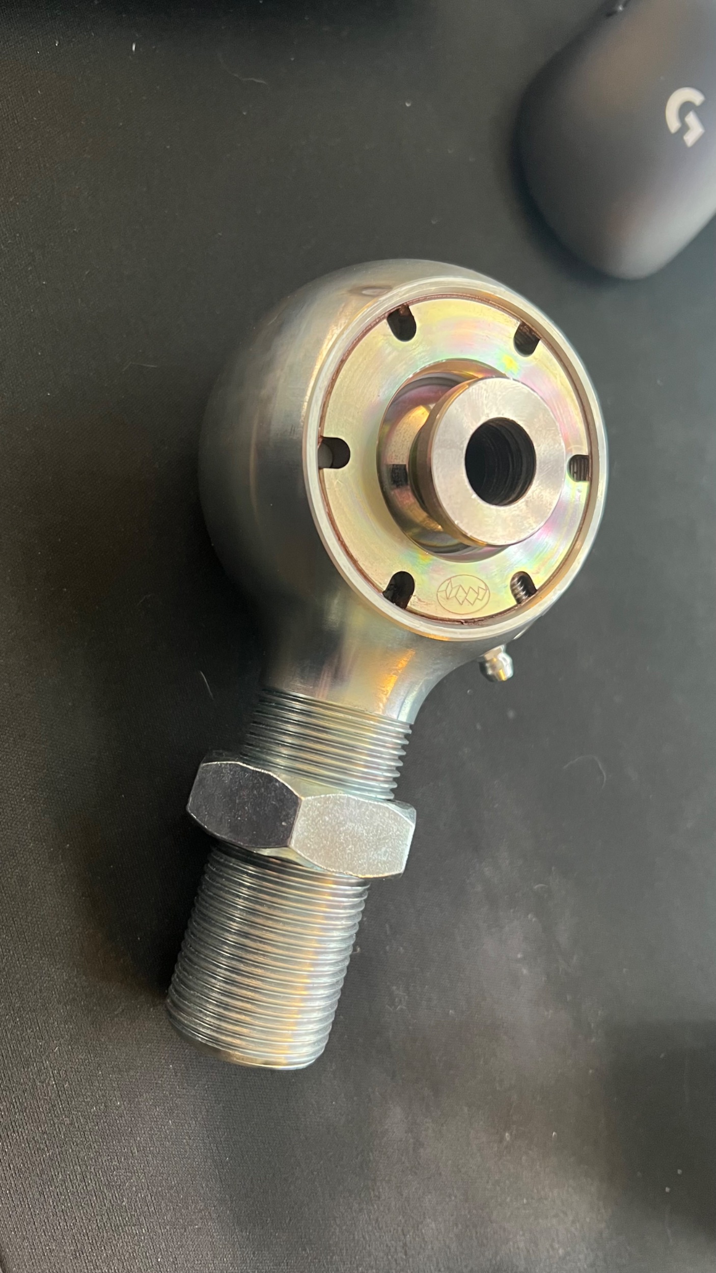

Rancho knuckles, mevotech lower BJ, custom steering with 7/8” FK Heims. I plan to run summit machine joints instead of Johnny joints. We have had good luck with them on other rigs. I’ll be keeping the swaylock and rear antirock, with custom links using 5/8” FK heims.
