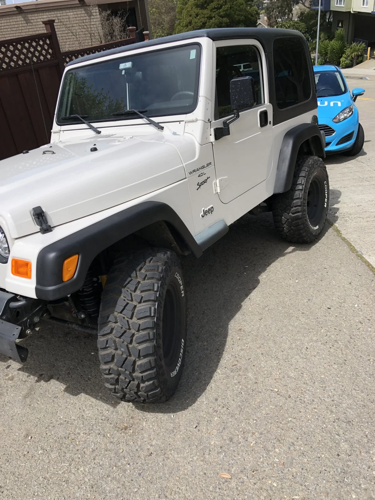

Found a good street parking spot today where I wouldn’t get run over working on the drivers side and installed the rubicon fenders. The rear ones were a PITA. The paint I did on my balcony isn’t perfect but going to tape them off and give them another coat and paint the extensions on the Jeep.

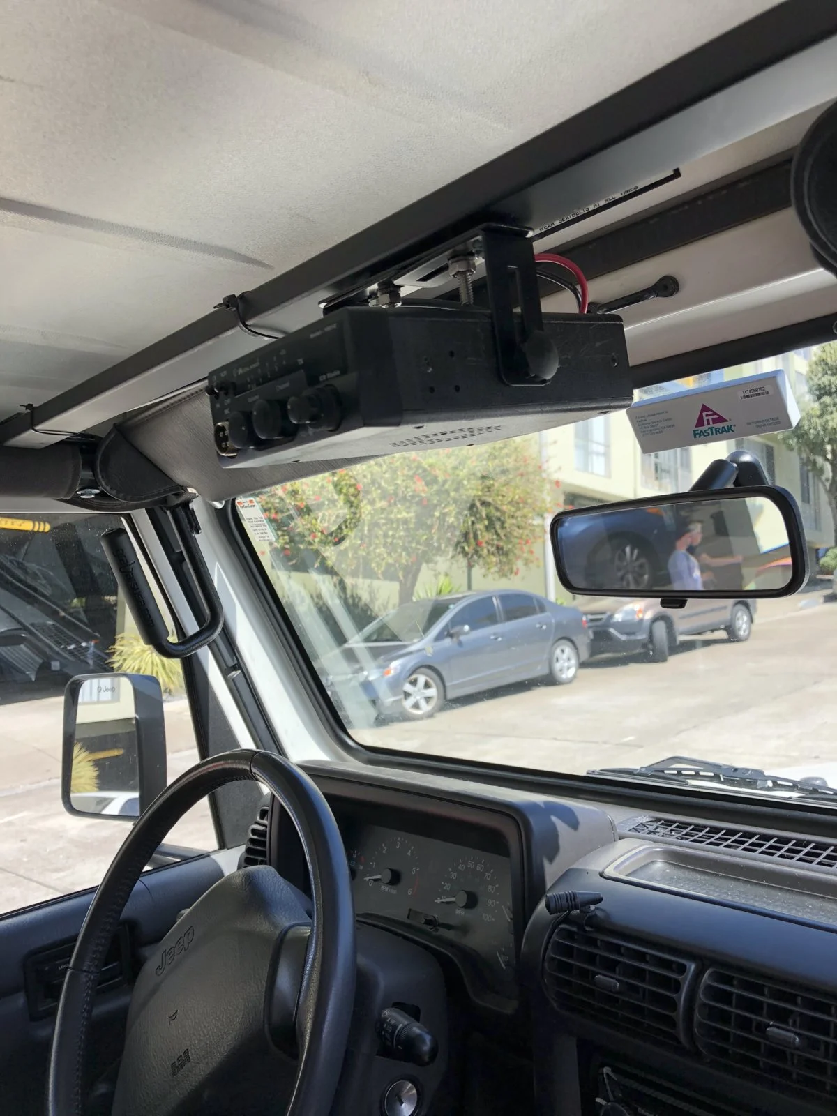

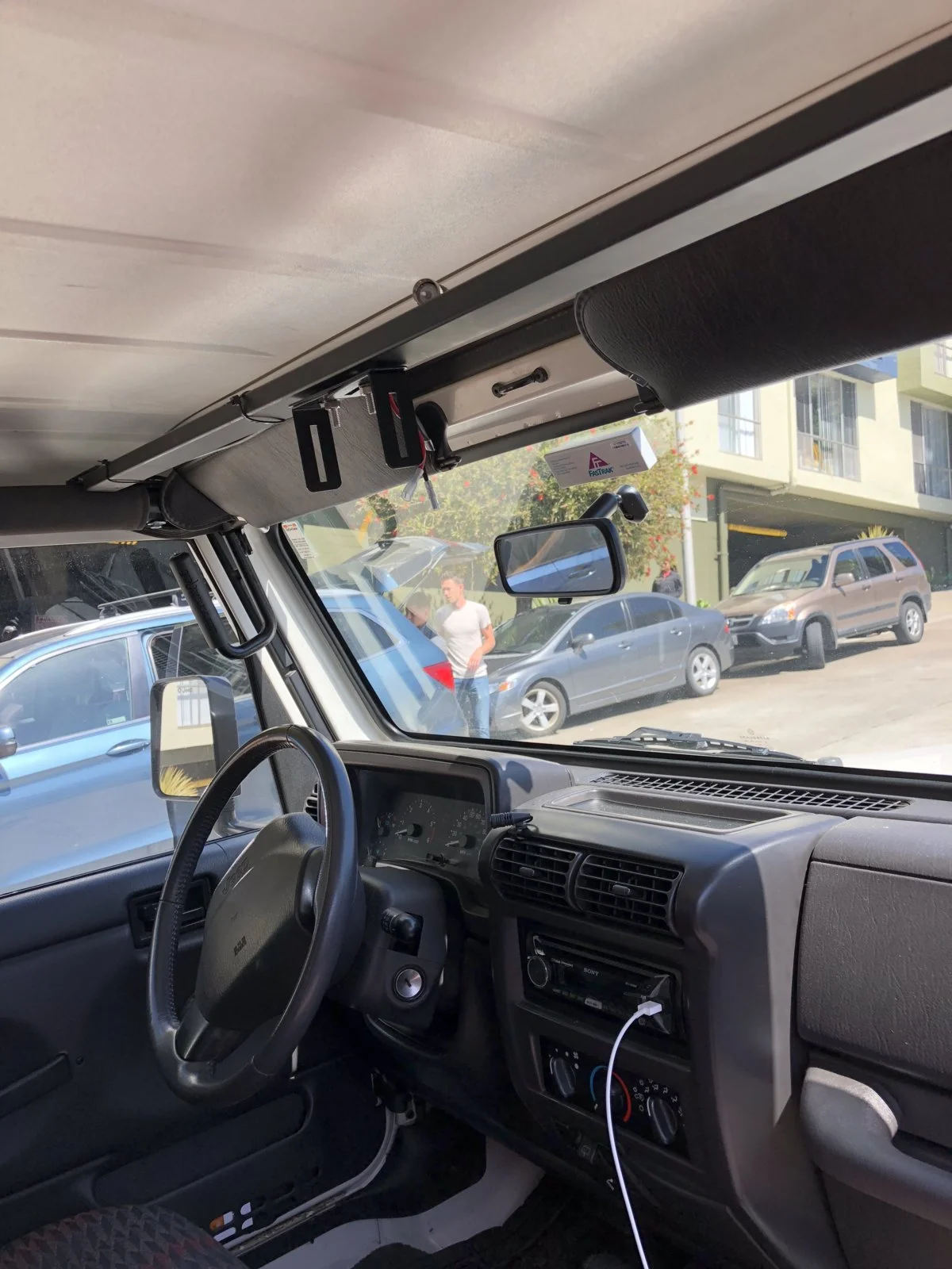

Got the CB installed using the Arizona Rocky Road mount. We tried to have the wiring as neat as possible and have disconnects so i can conceal the radio when street parked, don’t want someone breaking into my Jeep for a $40 CB. Still have some general tightening and cleaning up to do. Does anyone run their coax inside the tube somehow or is ziptieing it the norm?
I haven’t tuned it get, anyone have a tuner I can quickly tune with during the May meetup?

I might be able to persuade one of the group to bring an FRS meter so you can tune it. Looks good!

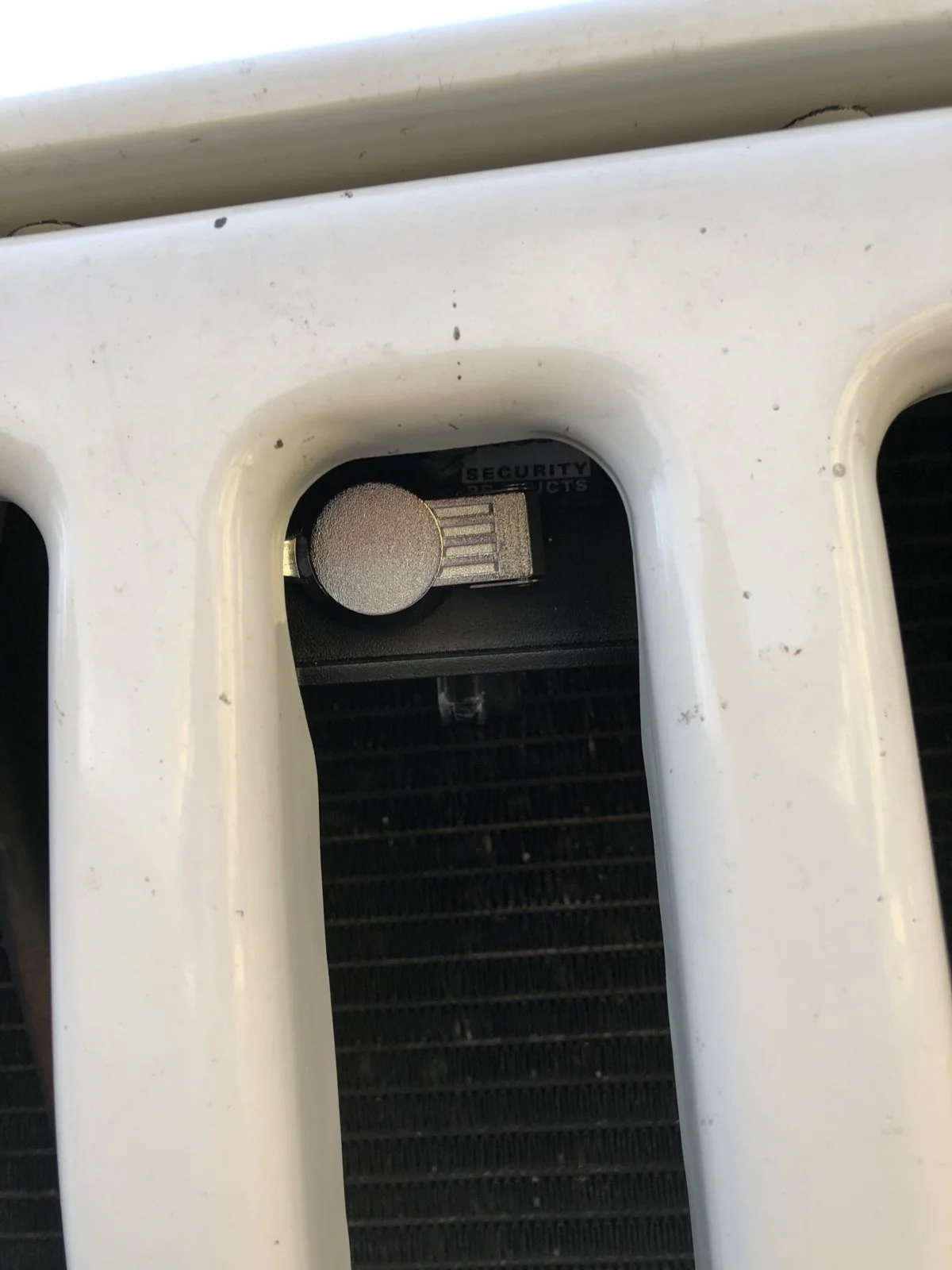

Installed my Tuffy hood lock this evening... that was so much harder than it had to be. The wiring harness you take out the tie for the screw hole has to be in the front of the lock so it doesn’t interfere. The lock piece has to be at an angle and sort of perfectly placed too or you can’t open the hood which quickly becomes a pain in figuring out. Took prob an hr and a half what should have been a 15 min job, story of my life.

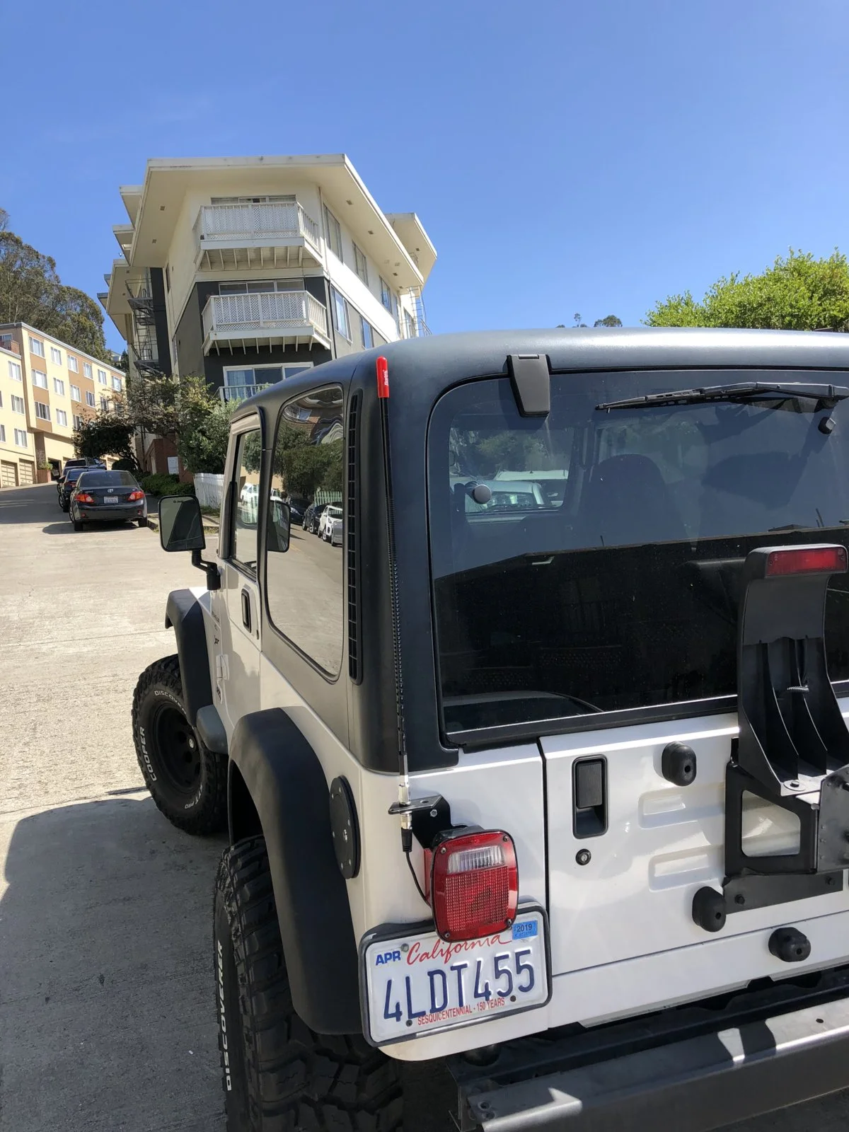

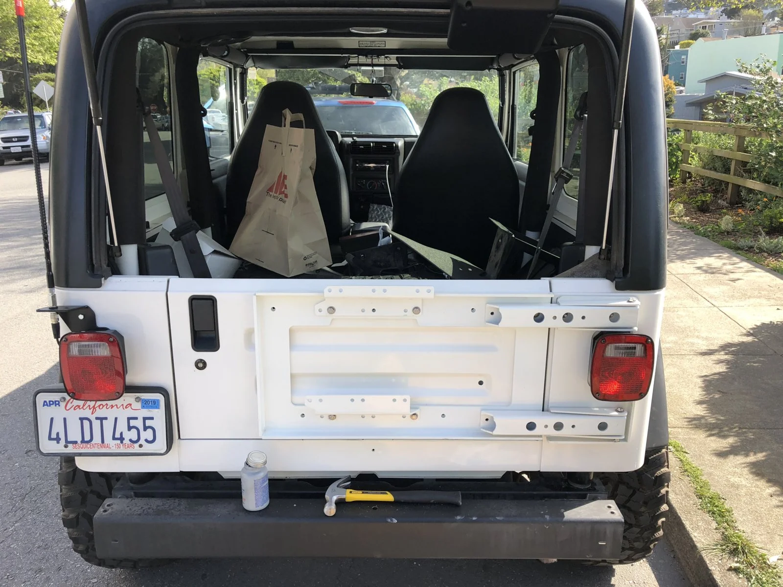

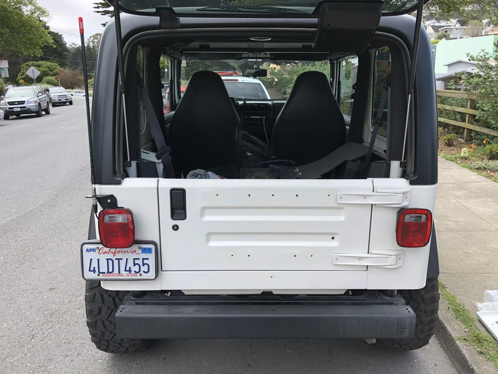

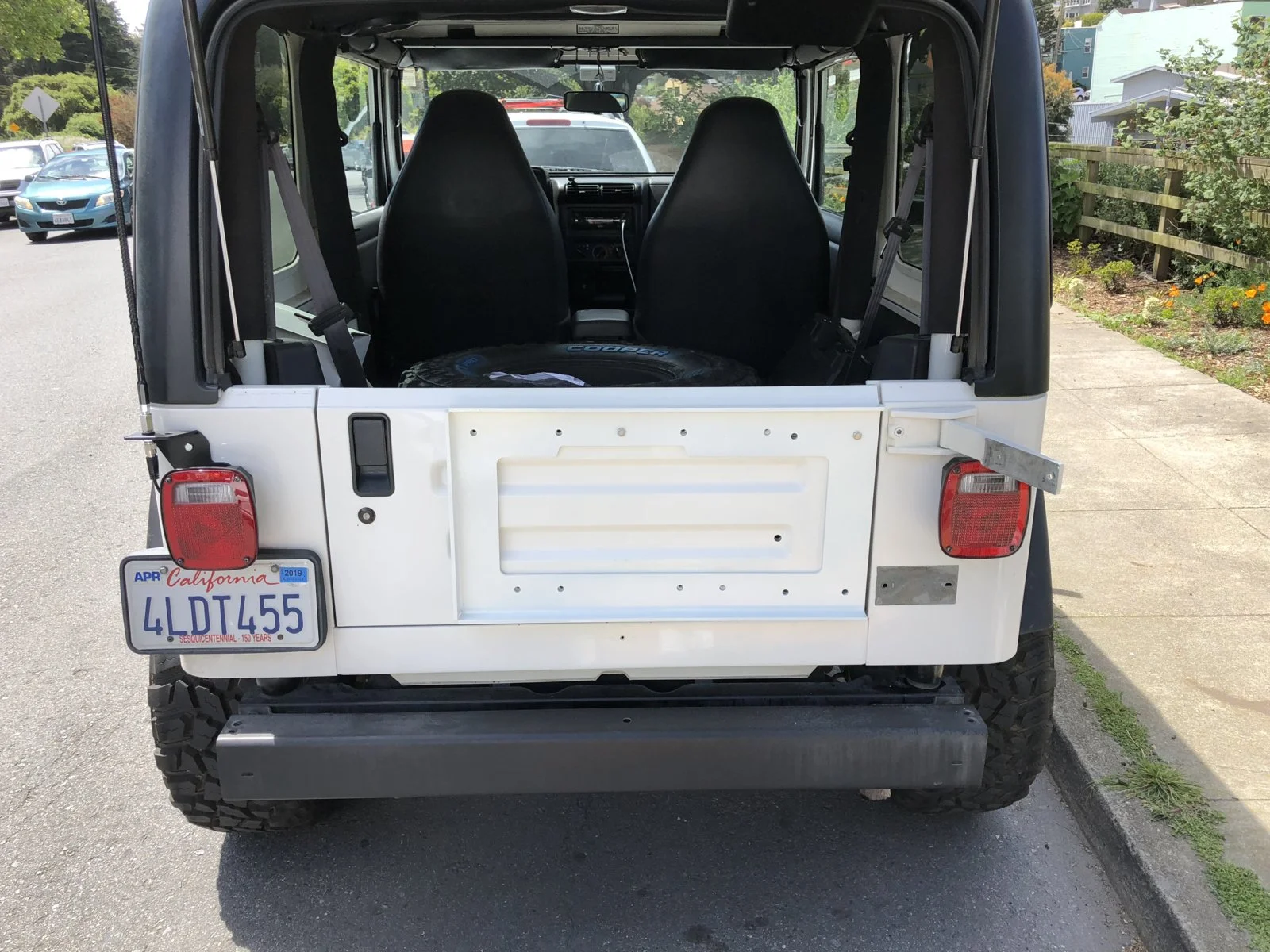

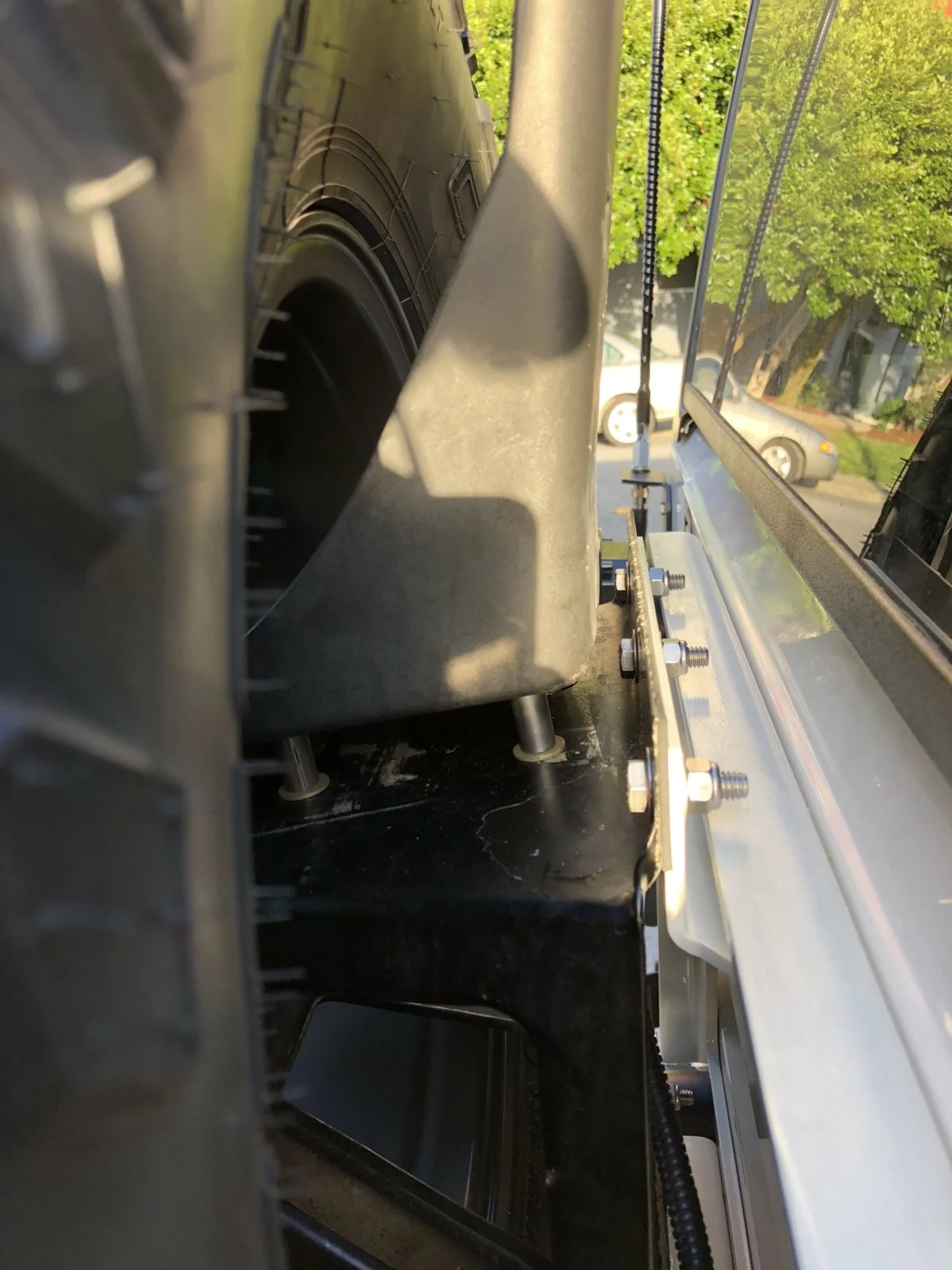

Finally got around to installing my exogate, having all the parts and painted this time. Took all day due to complications with one bolt which I ended up drilling the head off it after trying everything else. Nothing like doing all this while street parked a few blocks from my apt so I had flat ground. I will say the instructions were very good though.
I also did a cheap mod to get the 3rd brake light to be visible with just spacers. With the exogate raising my tire and the inch I rose the brake light the wiring is tighter than I’d like it. Need to extend the wiring.
Last the wheel is a good way from the bumpers. Need to look around but what did other exogate 3.75 BS do?

You could take hockey pucks and extend the bumpers out so they kiss the tire again, or grab some stock bumpers from the wreckers and cut them to add your length. You'll need longer bolts obviously.
Yeah going to try and get something done this week, might just use some PVC, finding longer bolts will be interesting as they're already long for the exogate
