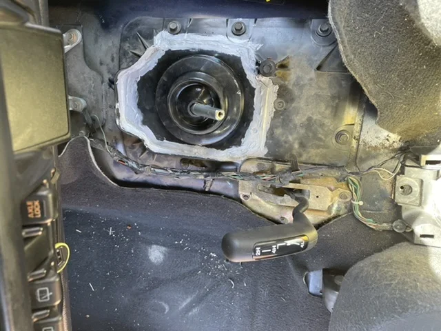

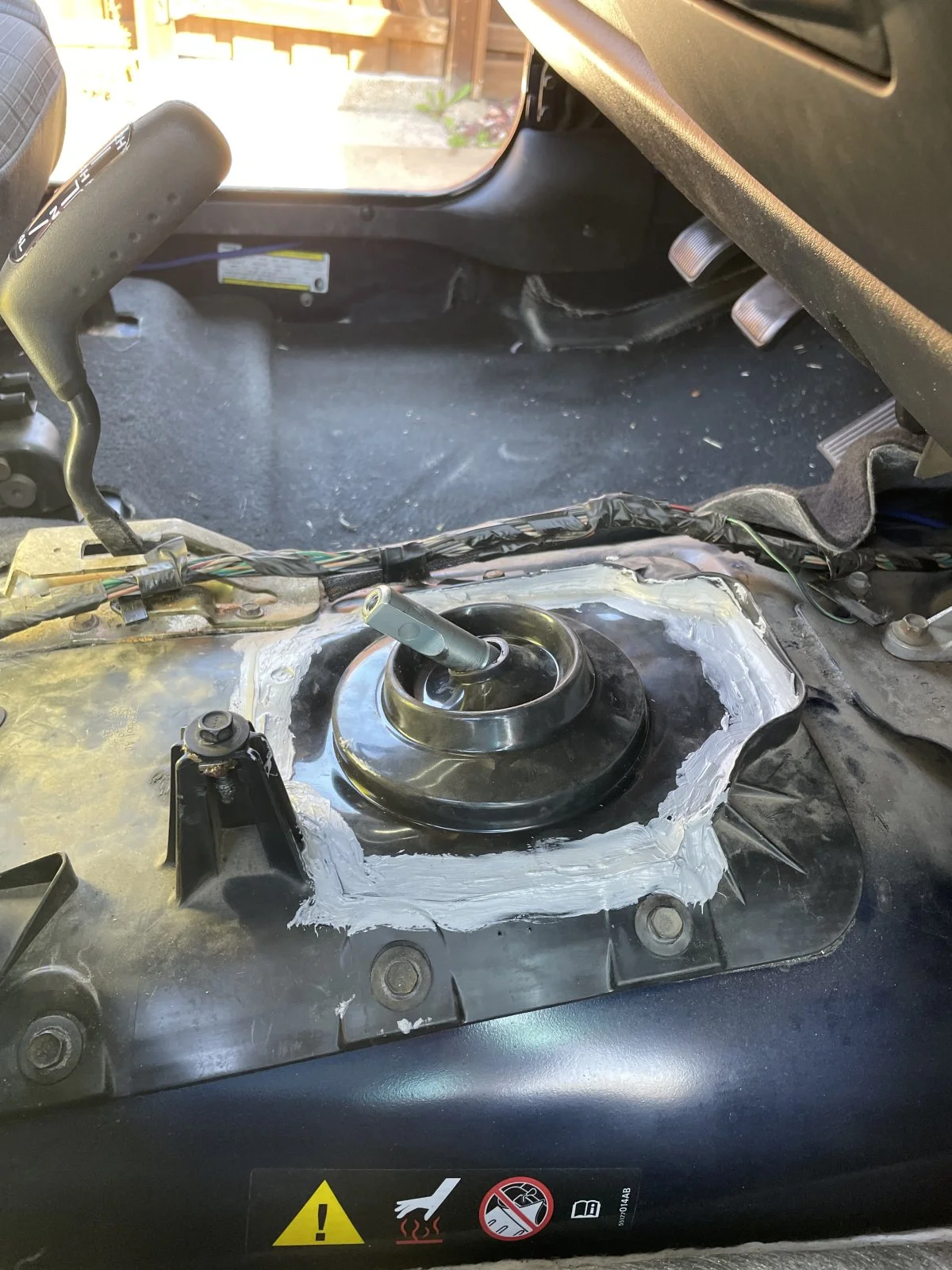

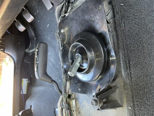

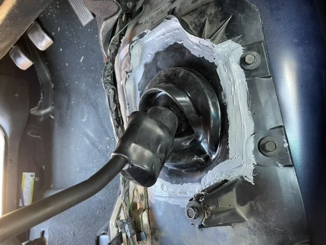

Like most people I hate the cost of TJ parts lately. My inner shift boot on my 2006 Rubicon has been mostly missing since I purchased the Jeep last year and the blast furnace didn’t bother me this winter but it’s getting warm in north Texas and as soon as a window gets opened or the sunrider is popped the blast furnace goes to work. I can’t keep my cold beverage cold in the cup holder and my right leg is permanently scarred from the heat coming out of my center console. I can find the replacement Mopar inner shift boot plenty of places but I’ll be damned if I’m paying $180+ for it. I’ve searched and read forums and done research and just wore myself out trying to find a cheap replacement and I found it!

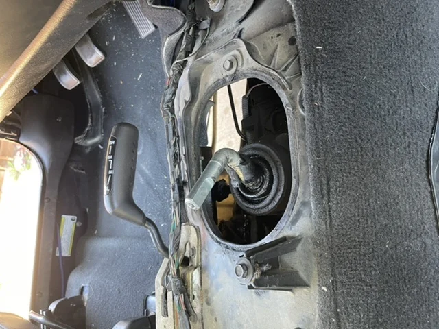

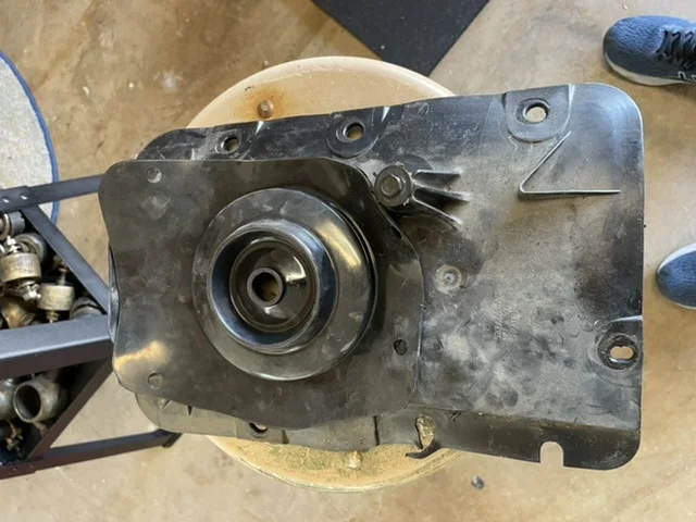

I started by tearing off all the old boot material from the plastic it’s attached to. I didn’t get a picture before I ripped it out but if you’ve been here you know.

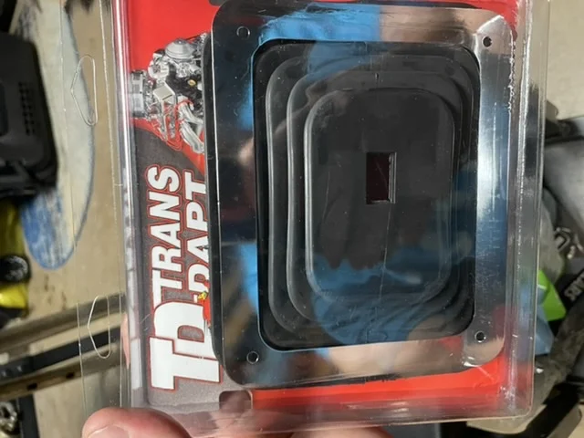

I finally narrowed my choices down to this one from TransDapt.
Which will just cover the edges. It comes with a nice plate to attach it but I was worried about the accordion style preventing easy movement.

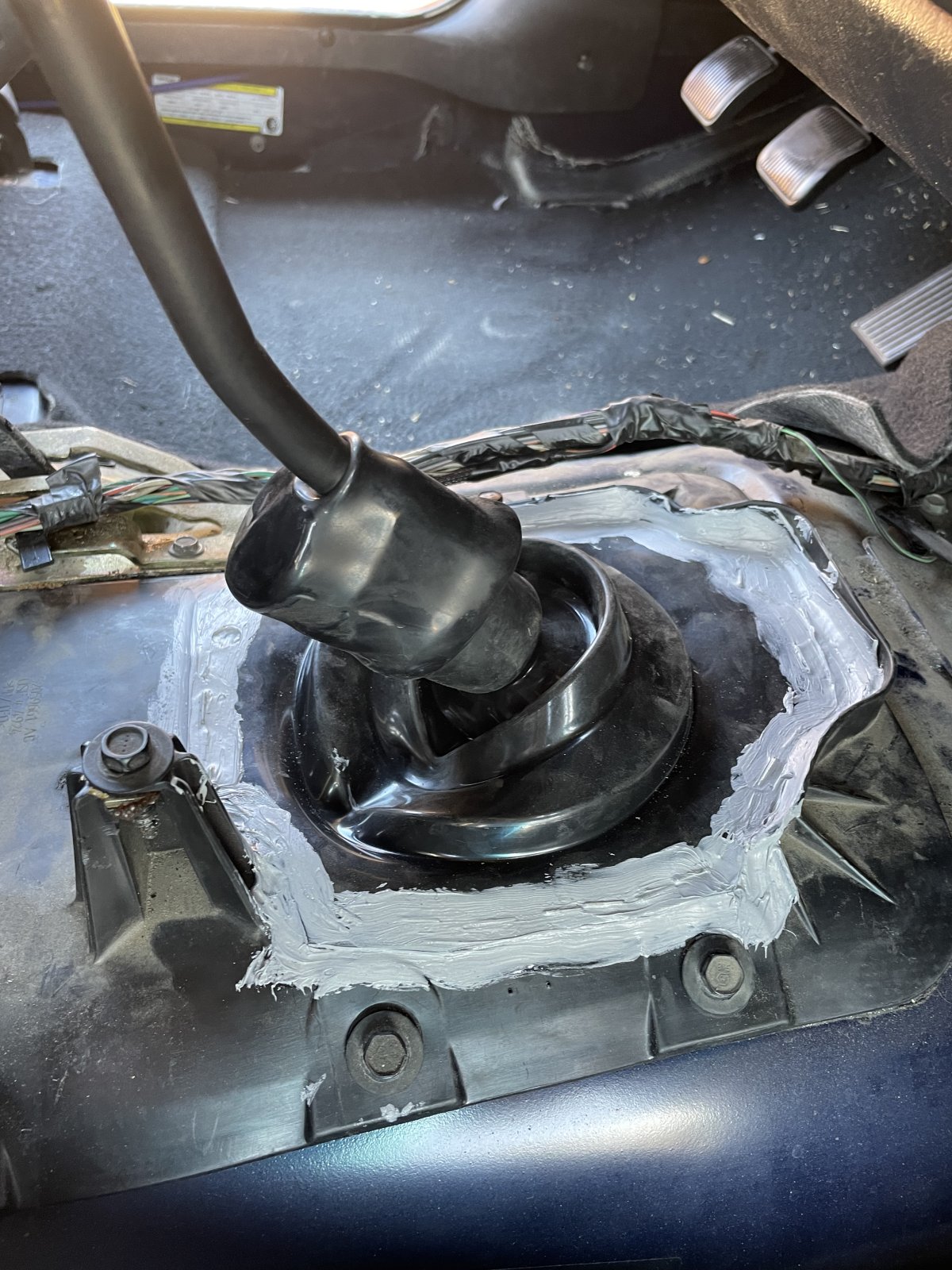

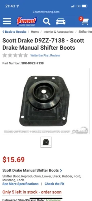

While looking at pictures I saw an inner shift boot that was designed for 79-93 Ford Mustangs and I’ll damned if it didn’t look like it would work perfect. I couldn’t find a measurement anywhere online and no one at the store knew for sure but I had bought one and had em pull it from the warehouse. Lo and behold it looked just right!
Check out that price!!

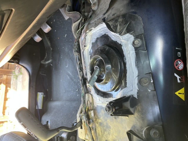

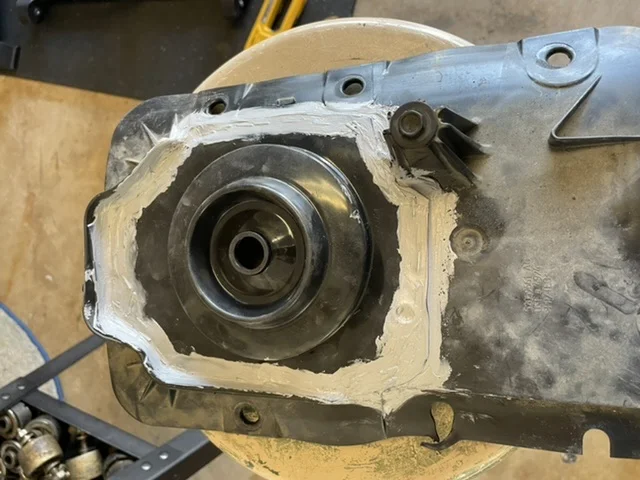

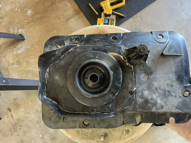

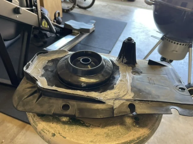

The next step was to fit it to the plastic piece. I removed the plastic piece after making sure I noted exactly where I wanted to place it.

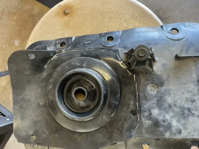

Then I started stapling. (I had seen this technique somewhere on this forum)
Reactions: Jamison C
It works perfect! No more furnace and I spent less than $20! The rubber is very soft and supple and I can’t tell the difference between having it on now and when there was nothing at all. No binding and no hard shifting. My foot A/C can actually be felt even with the doors off! Sorry for the long post but I had to share.
I just redid mine a couple of weeks ago. I used the same cheap rubber boot that @Zorba did on his. It's similar to yours, but doesn't look quite as clean. I'll have to keep yours in mind if mine doesn't last.
On yours I wonder if the rubber will begin to tear at the staple holes. On mine I wonder if the glue alone will hold.

Nice work. 🍻 The only thing I'd do different is to find the proper adhesive to bond the boot to the base and/or use some pop-rivets for a mechanical hold.

I figure it will last long enough for the $16 I spent. If it doesn’t last long I’ll definitely try to bond it next time. I was impatient!

Good find! I bought a stock replacement from Collins Bros. A few years ago for $70. Now they are sky high. Why couldn’t you have just put the edges of the boot under the plastic edges and bolted it back down to the tub to hold it?

I guess I wasn’t thinking. Haha. That’s a great idea.

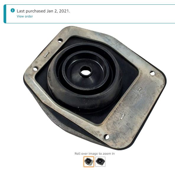

I knew there was a reason I've had this thing sitting in the parts bin for a year :ROFLMAO: I'll happily start from the second cycle in the trial-and-error process.
Mine actually came with the metal plate around it. I'll plan on removing it and just use the rubber.

You might want to try to mold the metal to the tub arch and bolt it down with four bolts through those holes into the tub. I always assume the added support is there for a reason.

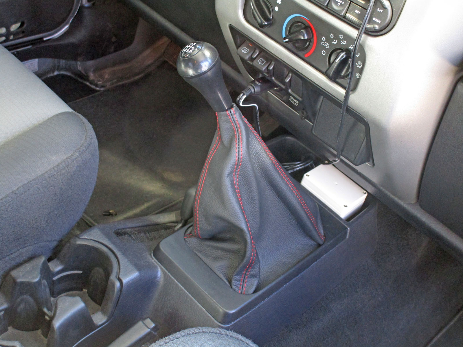

For the outer leather boot, I bought one from Redline Goods. It's very high quality, but not terribly fun to install on an '05-'06. You have to glue it to the metal plate under the plastic trim, and keep it flat enough to fit under the plastic. About $50 with free shipping, and their website might pop up a 10% discount. They come from Poland, so the war might unsettle things in shipping.

I found your post because I just received my shift boot from Redlinegoods. I’ve used several of their products in my Civic and have been well-satisfied, but the Jeep boot is another story.
It’s too wide at the base, and yours looks the same since you had to fold it under itself at the corners.
I emailed them today that their design is off; their first response was that someone must’ve swapped my ‘06 console for the earlier version. 🙄
You made yours look good, but I don’t want to fight the redundant leather; it’s supposed to be custom, not universal. Also I imagine those creases at the corners are gathering lots of dust and debris.
