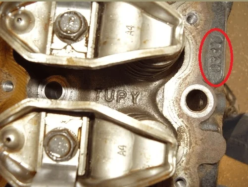

How can I check if it's one of the 0331 heads? I can't locate the piece posted above.
From the post above:
The good heads have TUPY as shown in the pic. They are all 0331s.
Non TUPY heads are crack prone.
Look down the oil fill hole and check for coolant seeping or signs of contaminated oil.
Just to be clear, your 2000 came from the factory with a non-TUPY 0331 head. That is what you have, unless a previous owner replaced it with a 2002+ head, which are also 0331 heads but are labeled TUPY to signify the casting defect that caused the cracking was fixed. I can't imagine that is the case, here. You almost certainly have a cracked head, so you need to replace it.
To confirm, you can shine a light down the oil filler cap after turning the hot engine off. Wait a minute or two and see if you can see coolant bubbling up.
