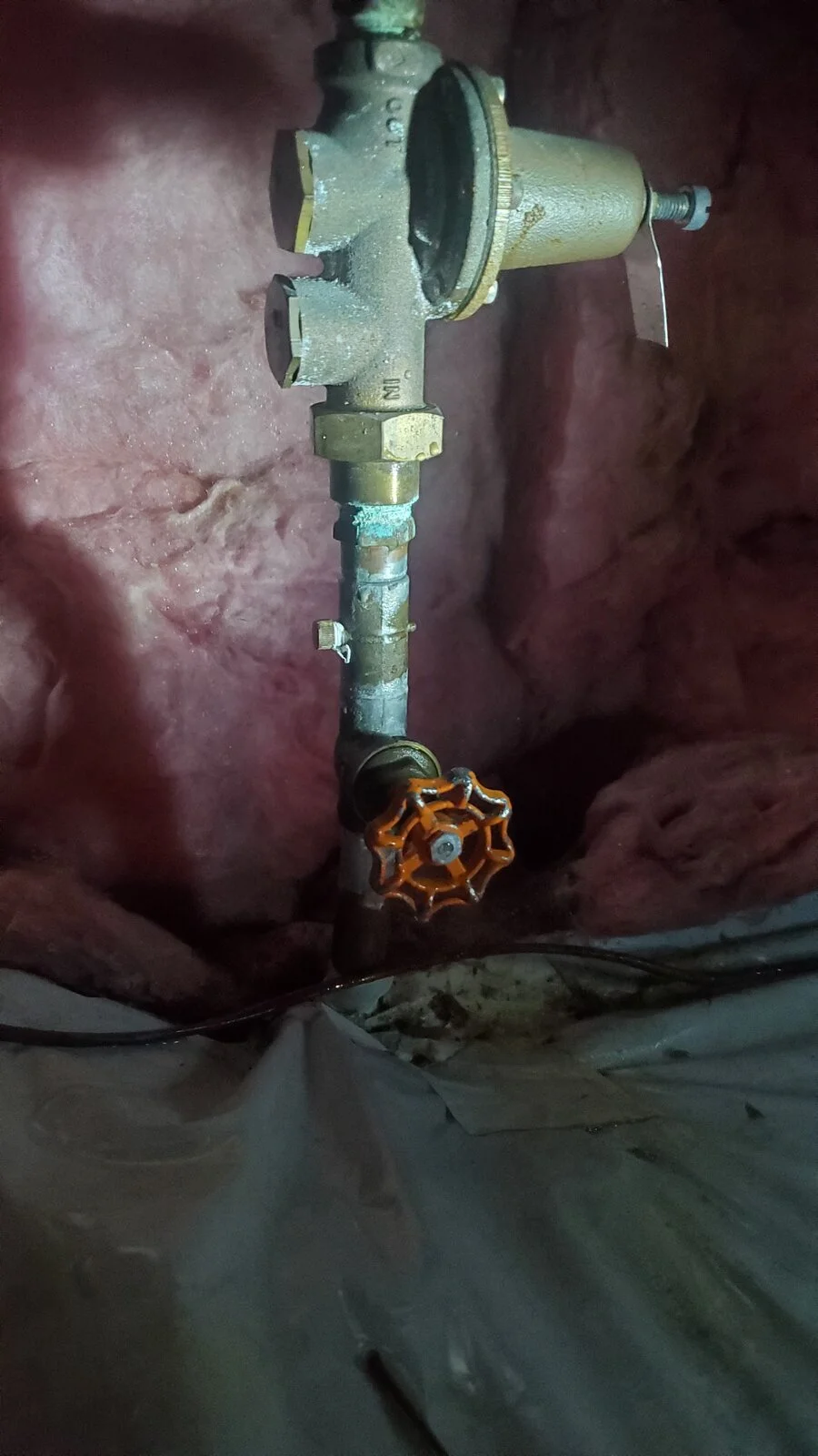

Did you break the union next to the valve on the PRV and clean the screen, may have slugged some crap. Also when operating the gate valve does it feel like the valve is functioning properly.
Did you break the union on the PRV and clean the screen, may have slugged some crap.

The device above the valve is a pressure regulator (which can also fail in a low flow rate)
Undo the lock nut at the tag and turn the screw clockwise with a large screwdriver and see what happens.
It may help alleviate the problem. There also may be debris in that too.
Try the union too as @TJ4Jim suggested. You'll probably need to disconnect it fully to check the volume. Be aware, though water will come out with "great enthusiasm".
So, there are 3 potential problems:
1. Valve may have failed (it's not a gate valve)
2. Debris in the screen at the union (as @TJ4Jim suggested)
3. The pressure regulator has failed.

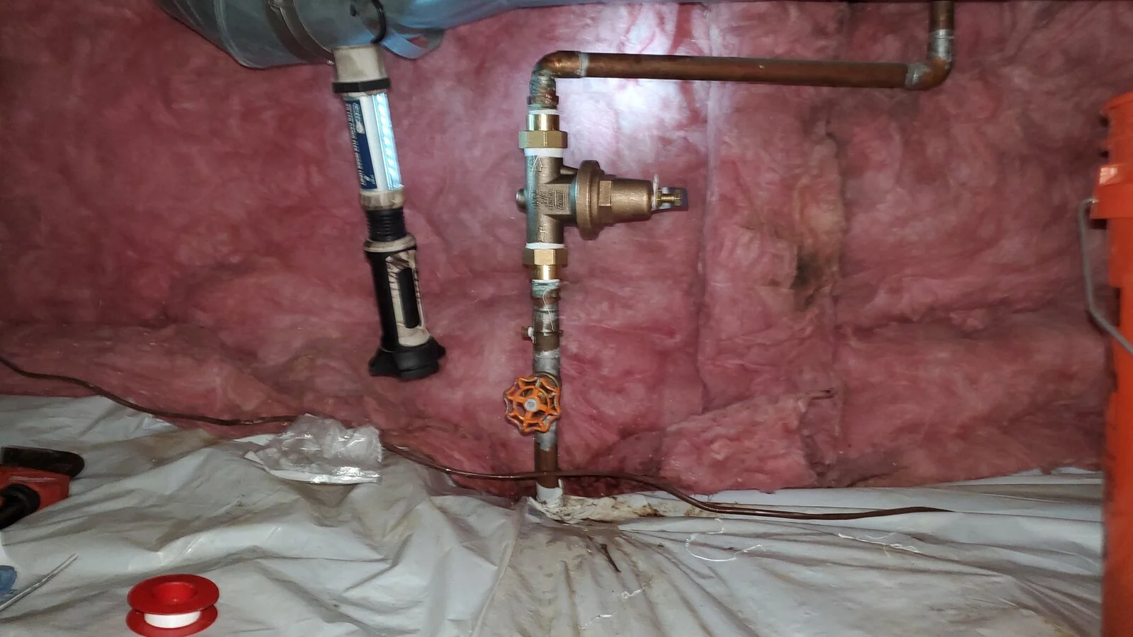

Tried bleeding the system a few times tonight by opening all faucets with the main supply closed, then turning the water back on. No change. This weekend I'll undo the union and go from there. I'd be lying if I said I wasn't hesitant to undo the union. It's probably the one installed from 1985
Generally the unions on the Watts Prv's are of a good quality brass and the corrosion isn't to bad, should not be a to much of a bugger to take apart.
Reactions: tworley
Unlikely to have a corrosion problem.
If it's that original, there's a fibre washer that may come apart.
Have some pipe dope ("Rectorseal" or equivalent) and teflon tape available. You might need it.
The good news is that if you have to replace the pressure regulator is its threaded on both sides.

The strainer inside the union is there to protect the prv so look at that first, if it's plugged then that's most likely the issue but you can also back off on the adjuster and that should increase the downstream pressure.

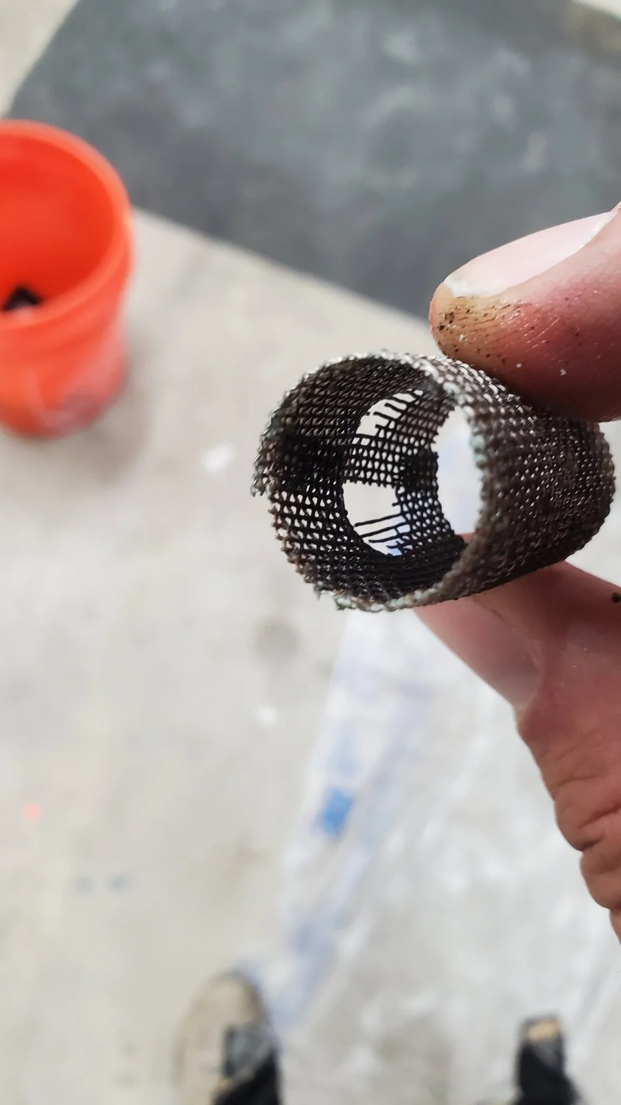

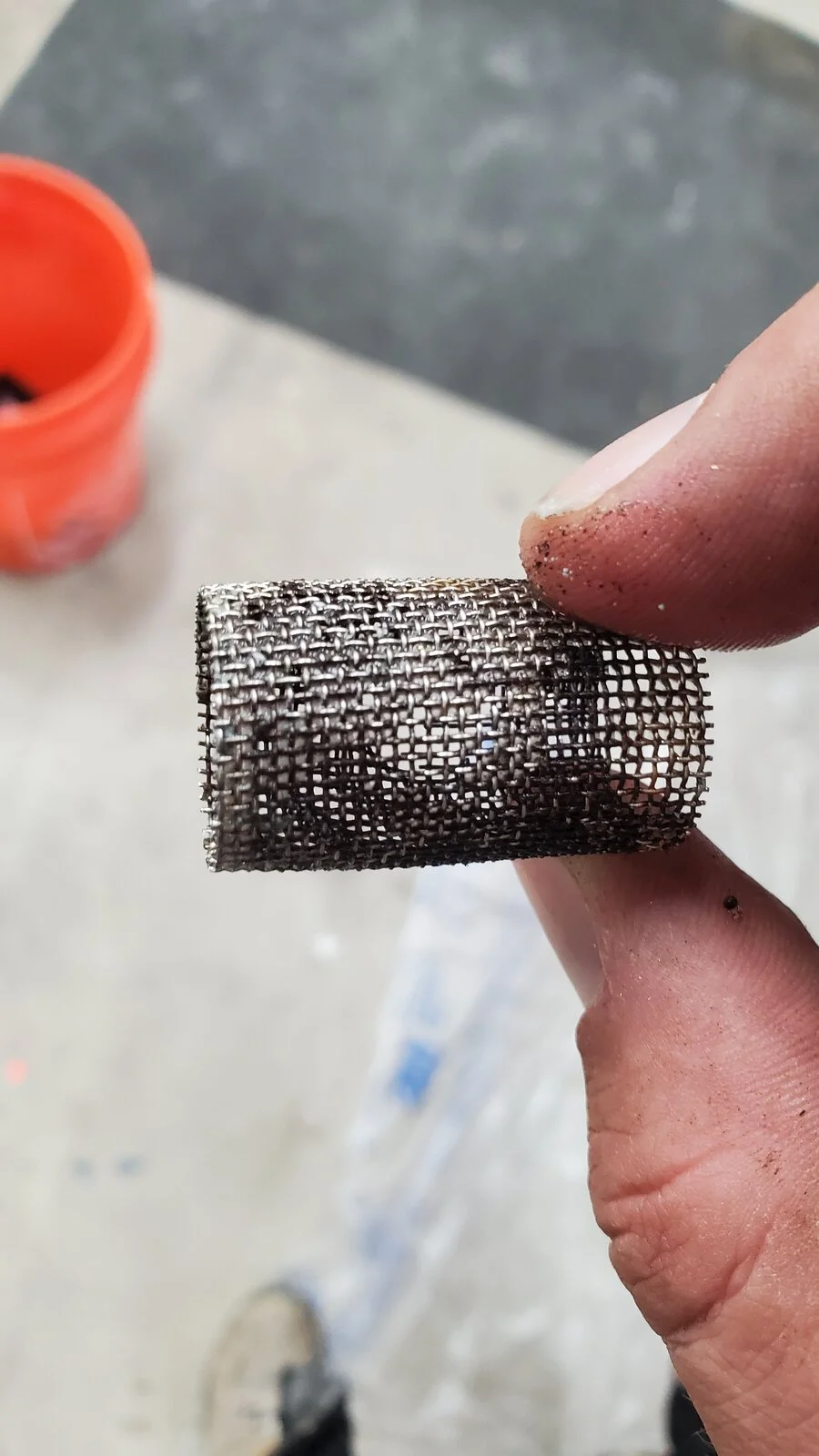

Got the old prv off. Nothing looked out of the ordinary. Screen was fairly clean. Damaged in a few spots which I thought was odd

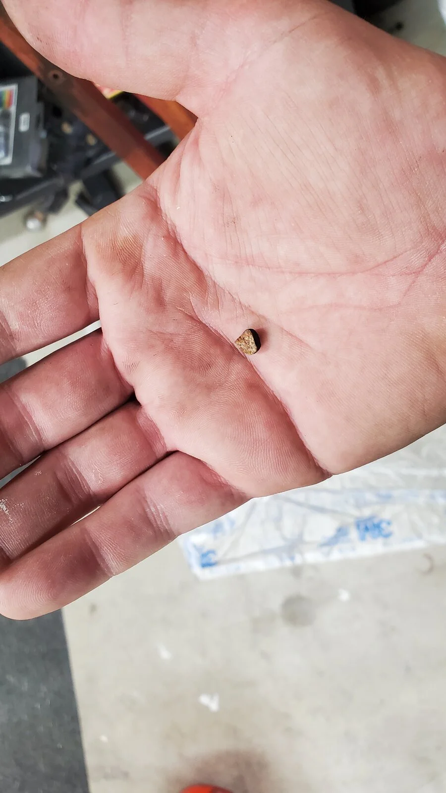

Started to feel inside the passage ways and something was wedged inside, I could barely move it with my finger. So I took it all apart and found this (more fell out too as I took it apart
The diaphragm was also in pretty rough shape. I went to go get a rebuild kit but couldn't find any locally. So, I wound up with a new Zurn prv for $130. Plumbed it in and could immediately hear a strong flow of water. Every faucet and spigot ran when opened. Set the presure to 68-70. So, problem solved.
