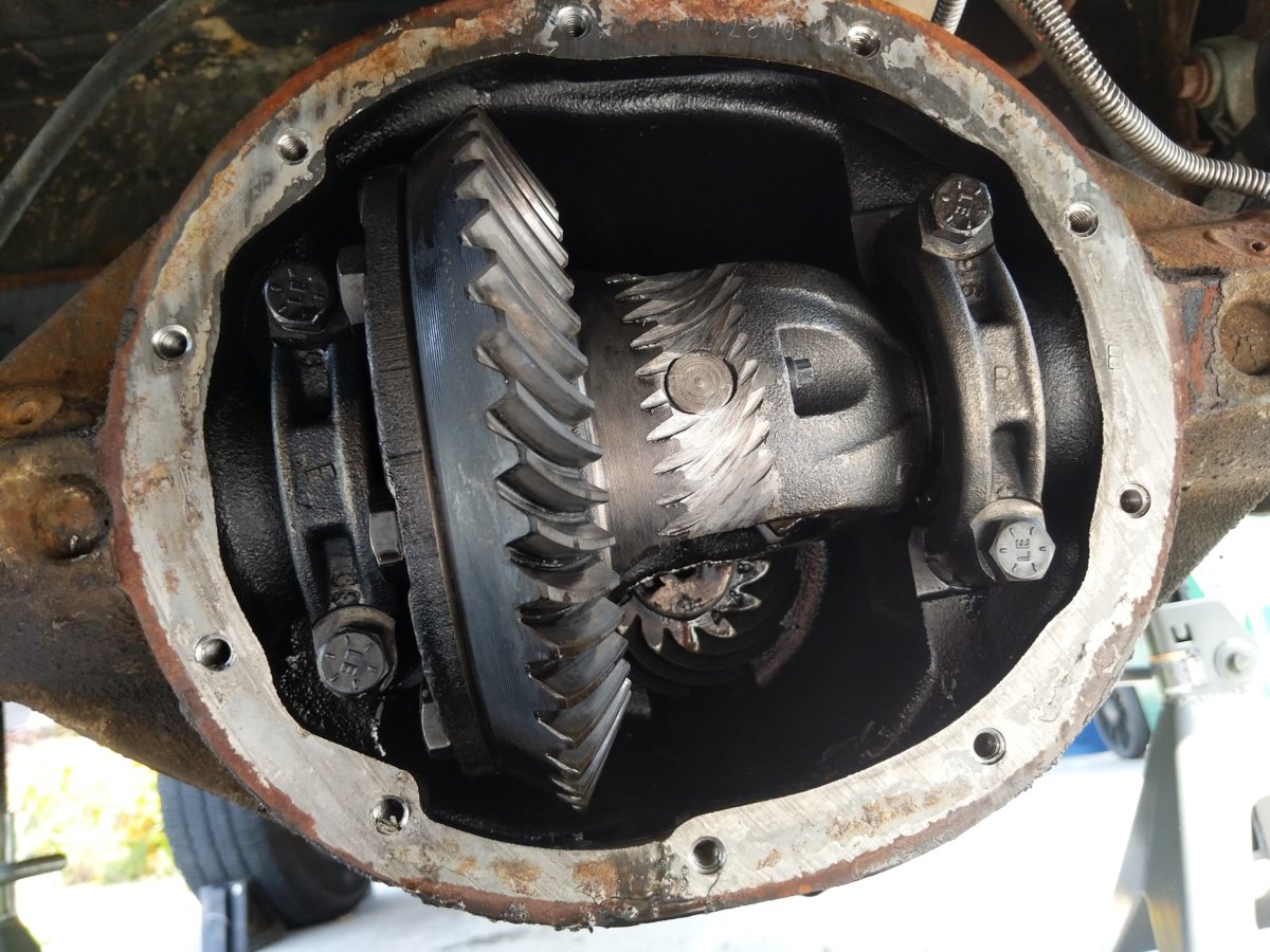

On the way home from work, the whining turned into WICKED grinding. I limped home, but it got to the point where slowing down to a stop felt like my rear end (I think) was seizing up. There's fluid leaking out from where the driveshaft goes in, so I fully expect my rearend to be complete trash now. Yay!

Holy moly. The ring came straight off the carrier? I haven't had a chance to open mine up yet, but I think that maybe the ring & pinion decided to get too intimate. I'm guessing my pinion nut loosened up or something and let the pinion gear just go kamikaze.
Are you sticking with a Dana 35 or upgrading to a Dana 44? And are you paying the shop to do it or doing it yourself?
Well, this is my rear 44. That is a truetrac with 4.56. This is only a year after my regear. I'm going to see what we can work out but ultimately, the shop will be fixing it.

In that case I would find a new shop. I would look into the Super 35. AFAIK, it is stronger than a stock 44. Not sure on the cost. Also, the only limiting factor for me rebuilding diffs is the setting up of the R&P. That takes skill and I know I do not have the tools/time/patience to do so.
Regears aren’t as simple as people think. I figured the pinion was gonna be ate up.

I'm guessing the actual gears are made from MUCH harder material than the carrier, so it makes sense. If the pinon and ring had it out, I'd have expected broken bits and pieces everywhere.
I've got a used Dana 44 in the works now, so everything will be tip-top in no time.

I had a very similar deal , very similar , pinion nut came loose ...you 'll be ok .
