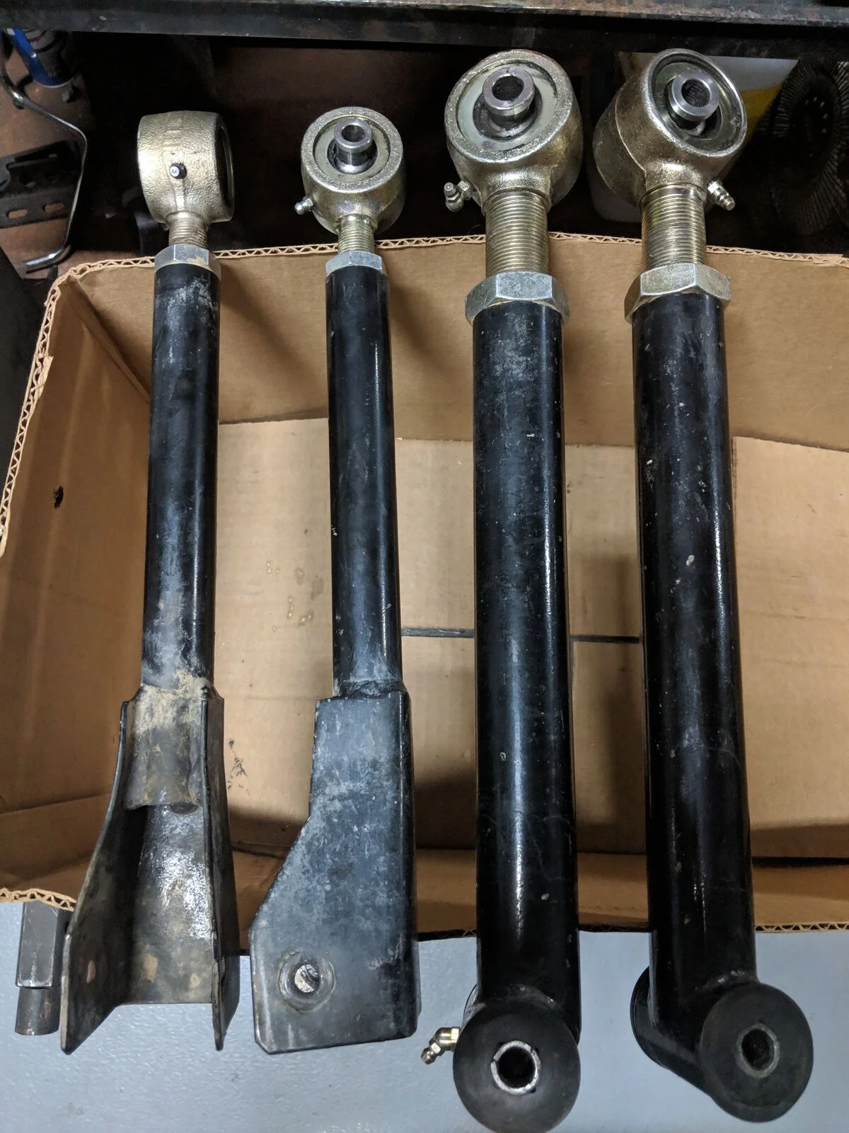

I too have an unidentified lower.
They’re steel and have grease fittings.
Can’t find them anywhere on the inter web.
Rancho or Skyjacker. I forget which one came up with that garbage design.
Reactions: R49
Rancho Rockcrawler arms. Uses proprietary bushings you will have to call Rancho directly and see if they are still available Bushing kit was PN 860218.
Reactions: R49

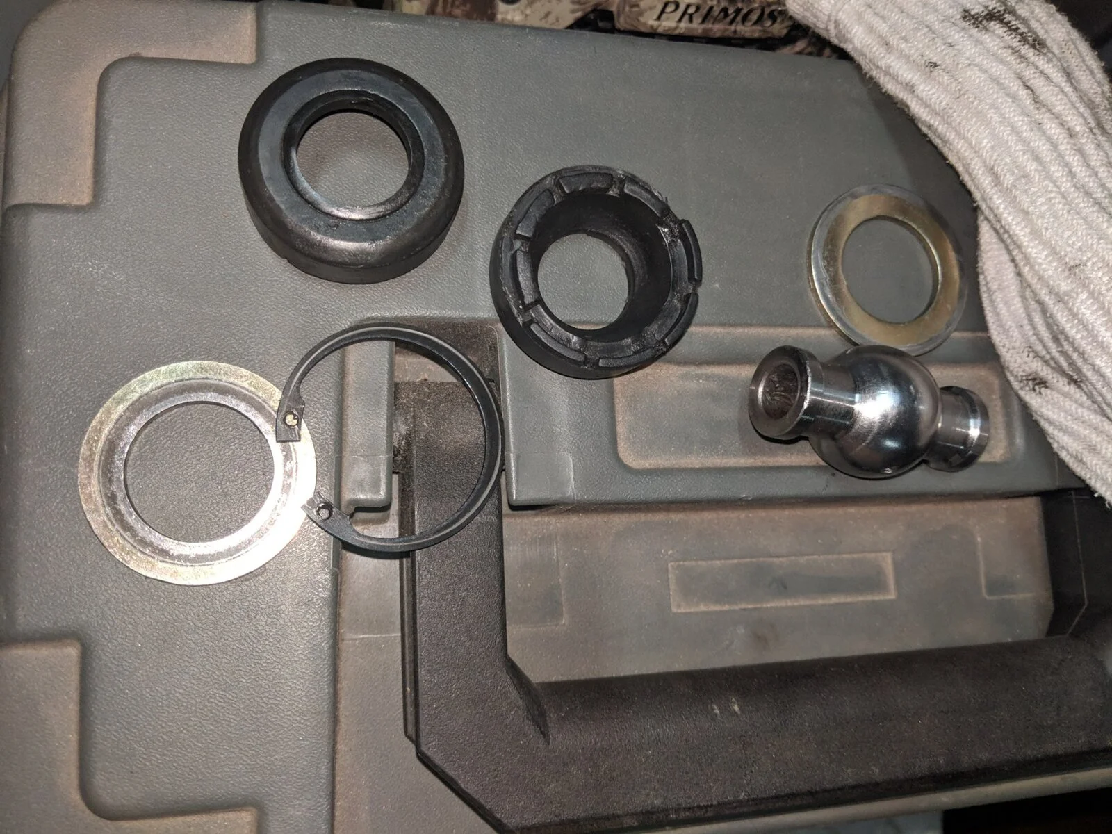

OK, my turn. I need to rebuild the "Johny joint" ends on these but figuring out who made them (for sure) has been not possible.
If there is a way to measure them to identify, I am totally game for that.
Identify them here.....
https://www.rockjock4x4.com/products/johnny-joints-rod-ends/johnny-joints-rebuild-kits
If you order them here and if they are wrong you can return them for up to 30 days....
https://www.amazon.com/RockJock-CE-9110RK-Johnny-Joint-Rebuild
