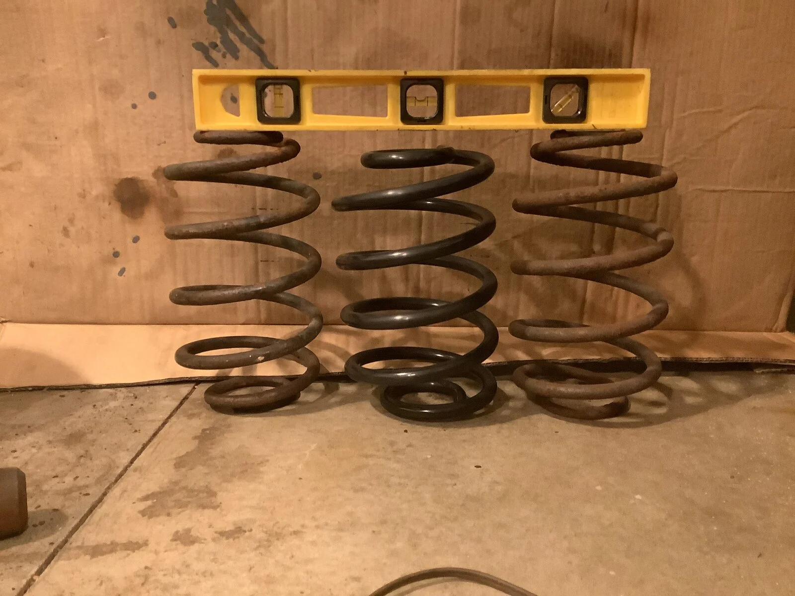

It looked like the AC Delco coils have the same spring rate 200lbs/inch and the only difference being the length. I didn't see anything about variable or constant rate, can you give me a link?

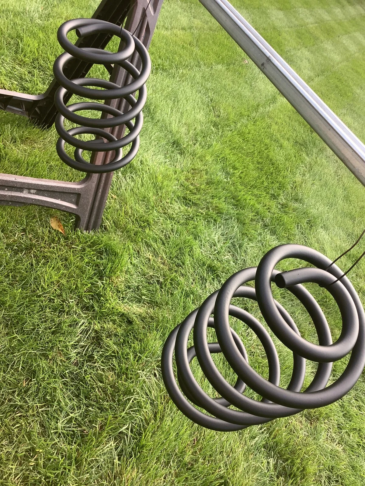

mmmm...flat black

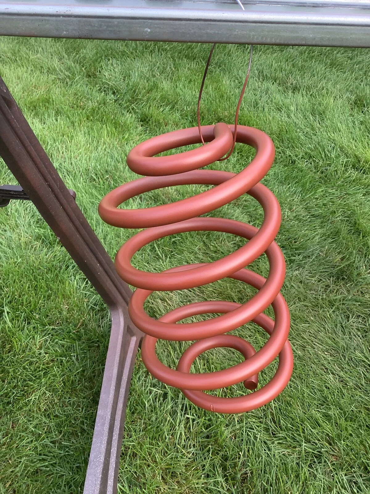

Looks like the spring factory used the same method as me because I can see hanger marks in the paint. It was bare metal there. see the bottom of the spring in primer. They both had hanger marks. Made in USA at least.

Before
After
