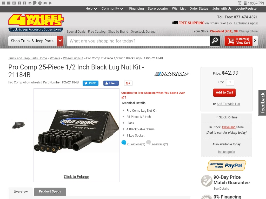

Non flashy black lug nuts and 5 lock nuts. This site use to sell a set that included enough fir the spare but they no longer carry it.
When I was looking for blacks lug nuts i found this. Downside they are spline ends, never have a single issue with it.
Get it half of the price of the pictures...
