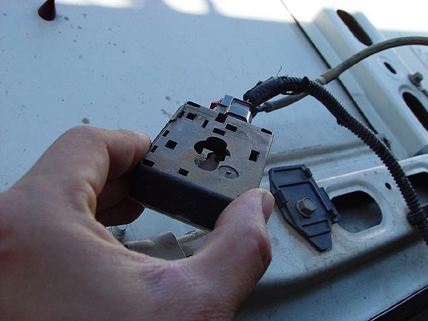

2. Open your hood, pop off the hood lamp and turn it upside down so that it doesn't stay on draining your battery while you do this install.

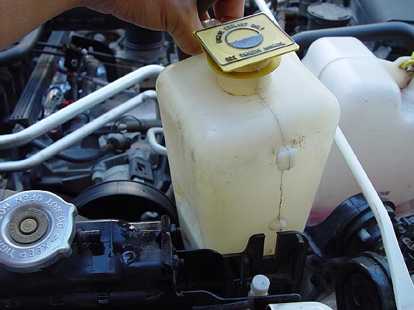

3. Remove your radiator overflow bottle and disconnect the hose from the radiator cap. This bottle is snapped into place by a round button tab about half way down the bottle and you may need to push on it a bit while pulling to get it free.

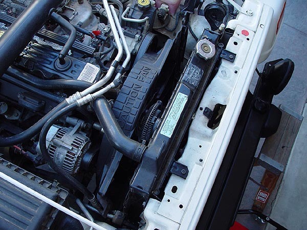

4. Remove the bolts holding your radiator fan shroud to the radiator and just let it hang on the fan.

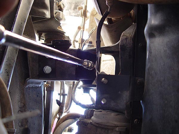

7. Loosen, but DO NOT REMOVE the thru-bolt, the bracket bolt on top and the bracket stud nut on the bottom of your passenger side motor mount. A long ratchet extension will make this job a lot easier.

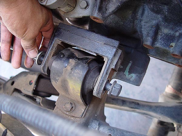

13. The passenger side motor mount is a heck of a lot easier to deal with. Simply remove the thru-bolt, the top bracket bolt, the bracket stud nut underneath and then swap in your new M.O.R.E. motor mount.

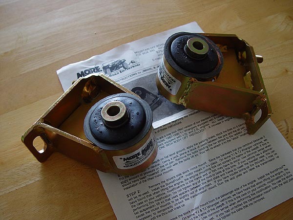

This is pic of what you will get. Really heavy duty stuff!
Pop your hood light off and turn it upside down to prevent it from staying on.
Remove your radiator overflow bottle.

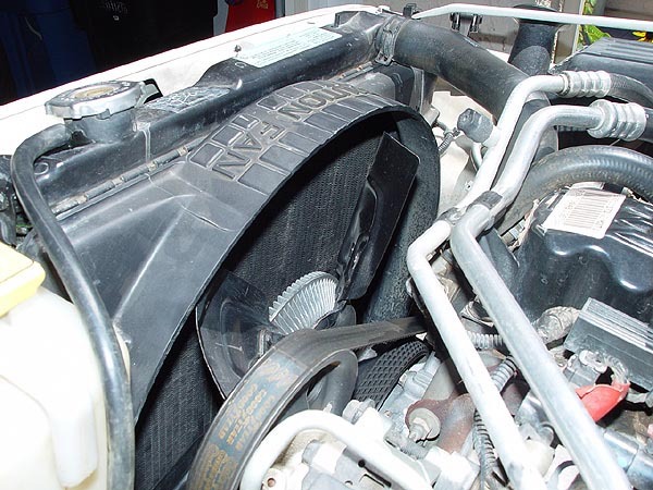

Unbolt your fan shroud and let it hang.

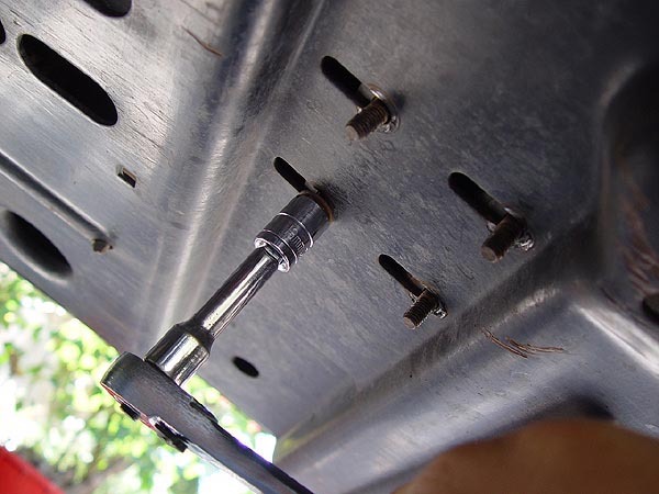

Remove the four nuts attaching your transmission mount to your transfer case skidplate.
Loosen but DO NOT REMOVE the motor mount bolts. A long ratchet extension really comes in handy.

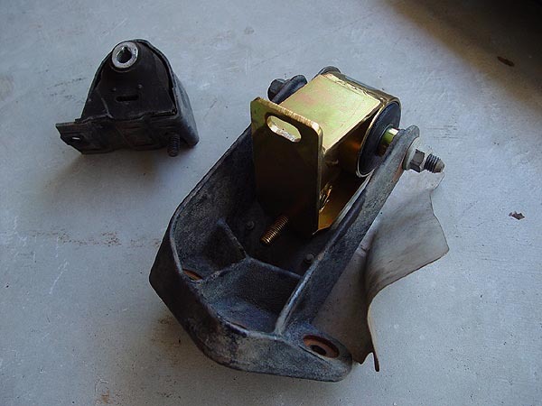

Here you can see th driverside OEM motor mount and the new M.O.R.E. mount on the engine bracket.

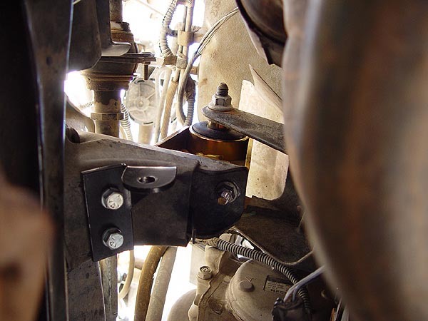

Here is what the ne M.O.R.E. motor mount looks like installed from underneath the driverside of the Jeep.

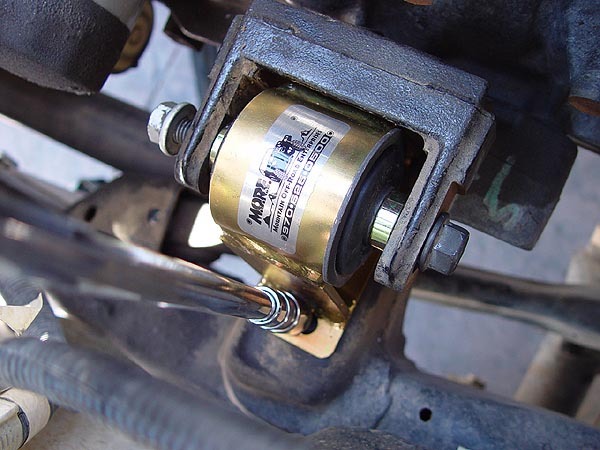

The passenger side mount is a piece of cake to work on. Here you can see me removing the throug bolt.

Make sure your fan blade rotates freely and does not make contact with the shroud.

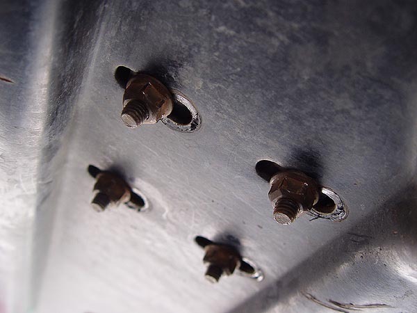

As you can see here your transmission will shift a bit after the install.

- M.O.R.E. 1" Motor Mounts - Part # JM600L
