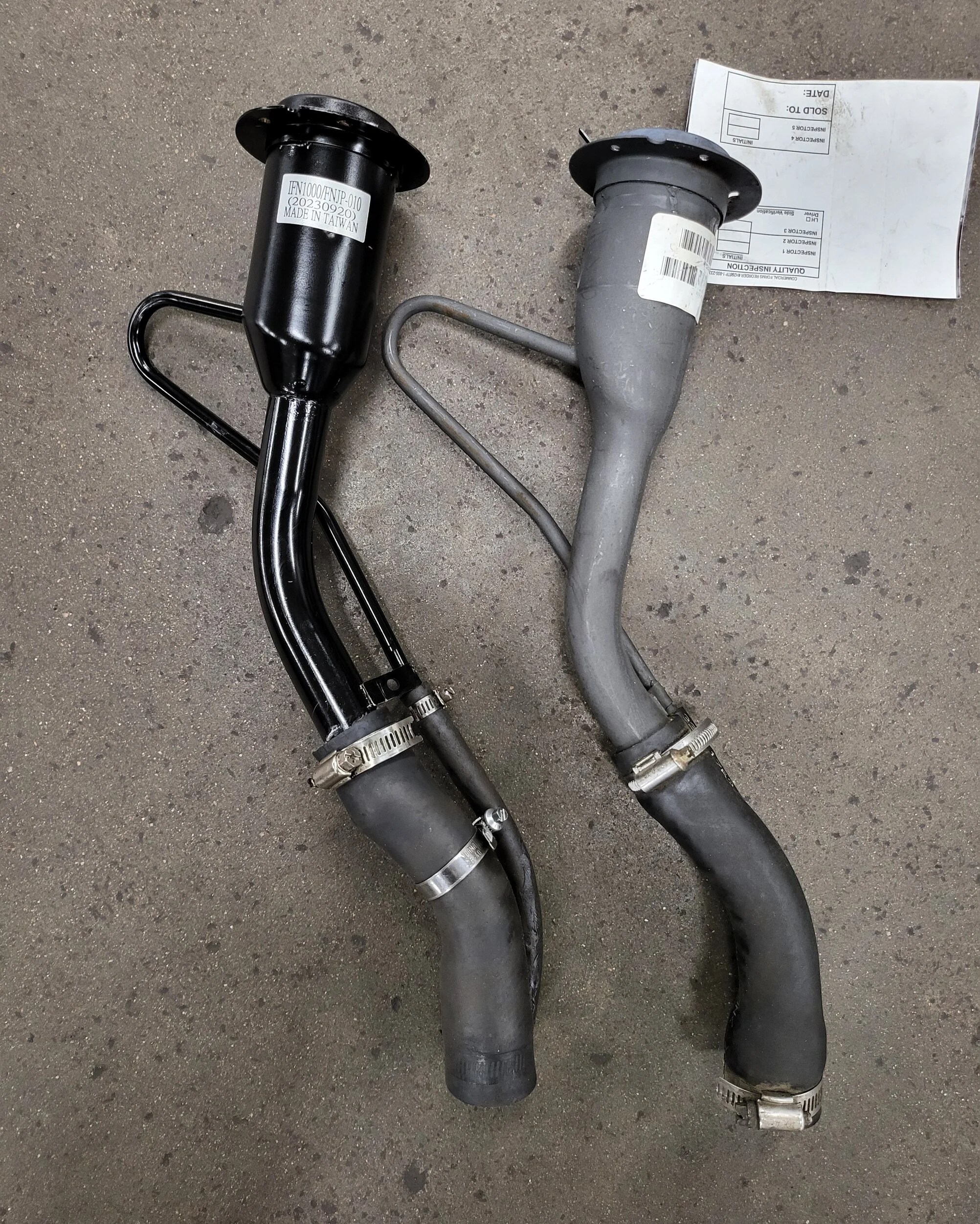

Which of these looks like it will give you a smooth pour, and which one looks like it will give you a mug full of foam? Which tube was desgined by a team of engineers for the purpose of allowing fluid to flow as smoothly as possible through it, and which one was designed by a team of managers for the purpose of allowing profit to flow as smoothly as possible into their pockets from cut manufacturing costs?
Add filler neck to the long list of parts that should never be aftermarket on a TJ! It's not just a tube... it's a tube that must be shaped just right.

When you compare the TRQ and MOPAR filler necks side by side, it is easy to see how TRQ cut manufacturing costs at the expense of the product actually working. The crude, welded, angular taper of the TRQ tube splashes fuel back into the venturi opening, causing the pump to shut off.

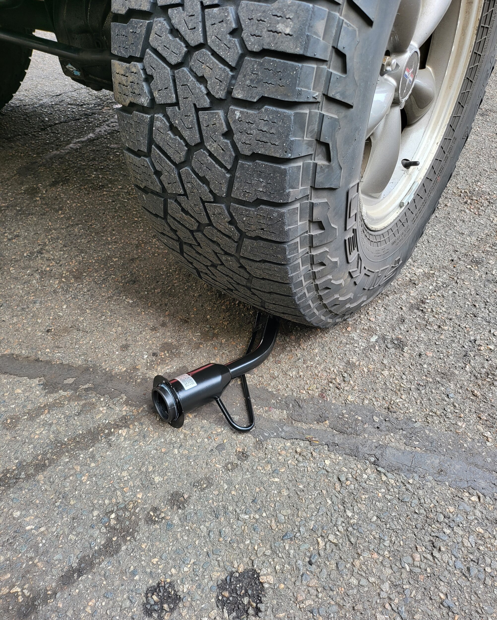

The product is past it's return window, so I ran it over with a 33” tire and threw it in a scrap heap. I don't even care about the money. I want all my time back... the weekends spent troubleshooting and thinking that I had done something wrong and damaged my TJ's fuel system.
