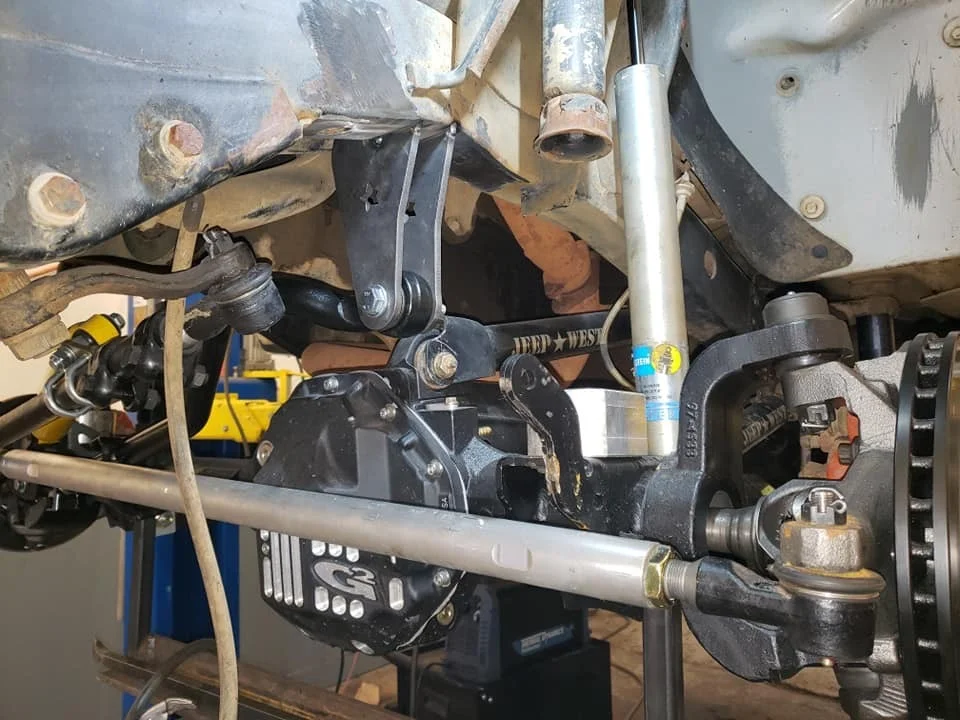

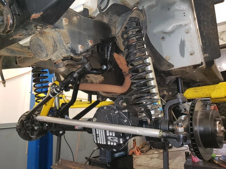

Here’s a picture of one of Dave’s setups. The owner cracked the frame side mount so they made a new one that still keeps the correct geometry.

Here’s a picture of one of Dave’s setups. The owner cracked the frame side mount so they made a new one that still keeps the correct geometry.View attachment 139777

Similar to the way that Dave sets his track bar bracket up - it’s easy to measure the amount of drop needed off the frame side to keep the angle happy. He does clarify that he makes no claim that double shear or aftermarket bracketing is stronger than oem, just a solution to cracking or another issue with the stock mount. Plus he claims that with his bracketry and RC track bar you can push the front forward 1.5” and still have stock up travel clearance. I trust him when he makes claims - because his Facebook page is filled with suspension cycling and trying to squeeze every bit of performance out of jeeps. Take a look at the photos section of his page - I enjoy seeing the updates every day. https://m.facebook.com/JeepWestServiceandMechanical/
