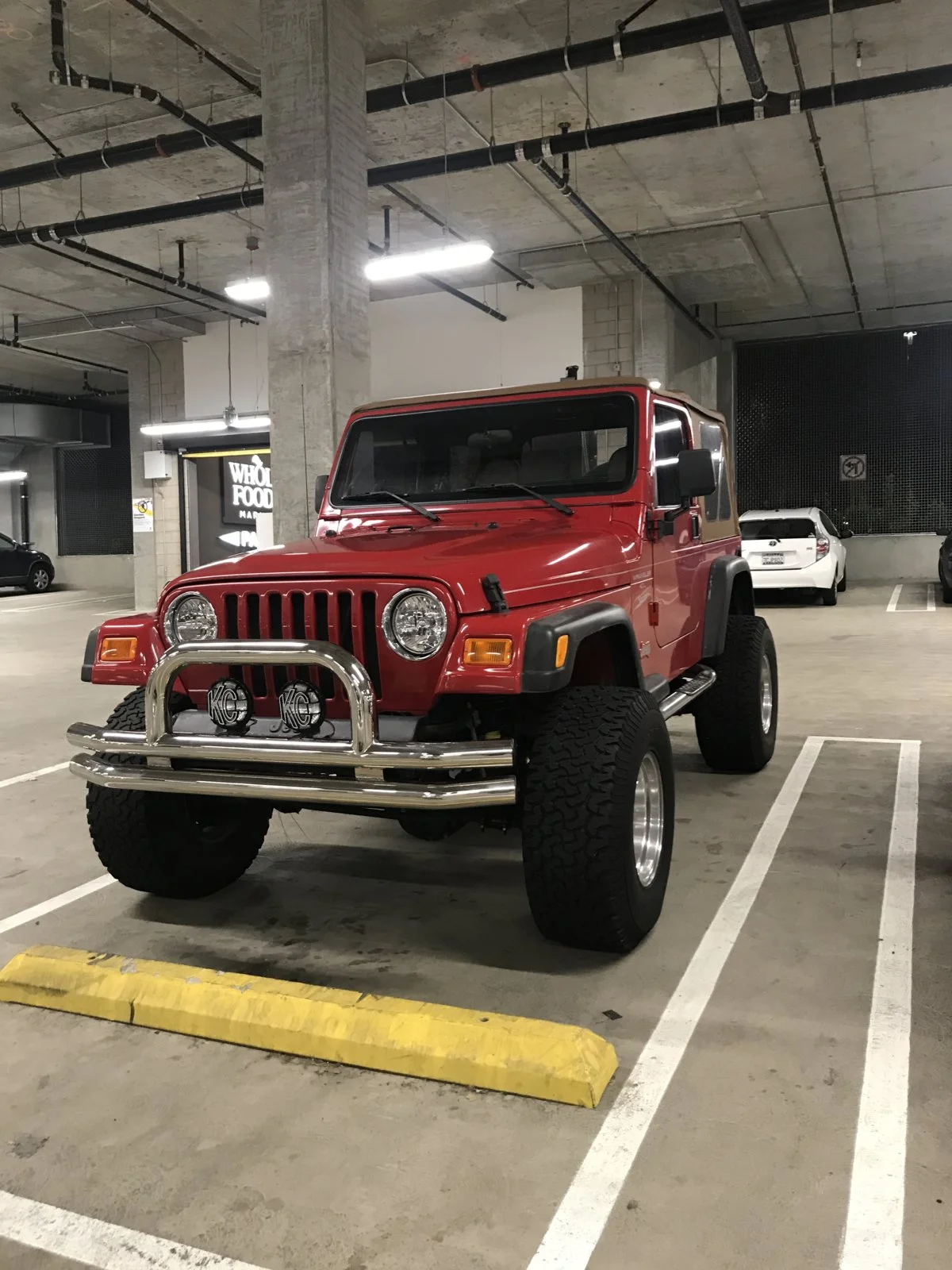

The time has come! Just bought a BUNCH of upgrades that will be installed within the month!
this is my Tj currently:
2001
5 speed
52K
PO had lift installed im assuming 2.5"3-5"
33's
PRP Daily Driver Seats
4.56 gears (30/35)
adjustable front track bar
ZJ steering upgrade
rear tire carrier
Whats to come!
8 Currie Johnny Joint Control Arms
3.5" metalcloak dual rate coils+ MC shocks
AA SYE + custom driveshaft
JKS rear track bar
rear angled relocation bracket
shock relocation brackets
1" M.O.R.E. body lift
1" M.O.R.E engine mounts
Savvy transfer case shifter

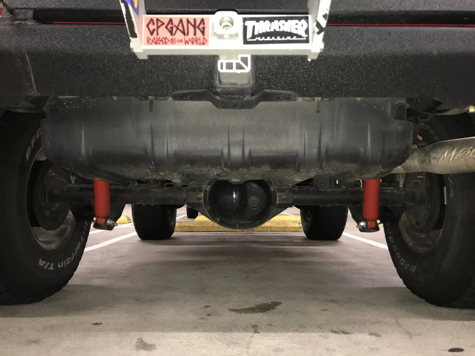

Pay close attention to the rear and it's bump stop requirements. The MC 3.5" coils go solid at 6.5" between spring seats. You may need to add bump stop extension beyond the compressed shock requirements just to keep the springs safe.

that was actually a question of mine, any recommendations for bump stops? and if so how many inches? I know this is something you need to do with the axle at full compression but is there a ball park so i have the necessary parts on hand?
jjvw
0-60 in 18 seconds
Feb 17, 2018
6,570
Colorado, USA
Buy a pair each of 3x3" and 2x3" Zone body lift pucks and some longer bolts. Cut the pucks to the length you need. Bolt the front extension to the axle pads. Add the rear extension above the cup.
The fronts will likely be determined by the tire scrubbing the outer fender sheet metal at full flex (ignore the flare). The rear will likely be determined by the compressed shock (or maybe the coil going solid).
Cycle the axles with a floor jack. No coils, no jounces, disconnect the sway bars.

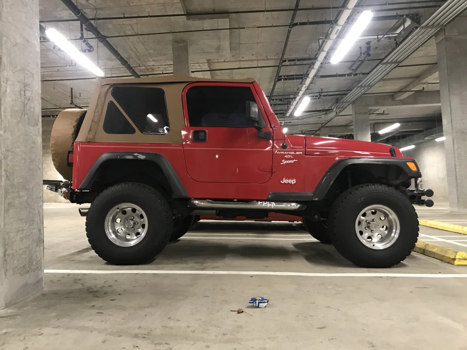

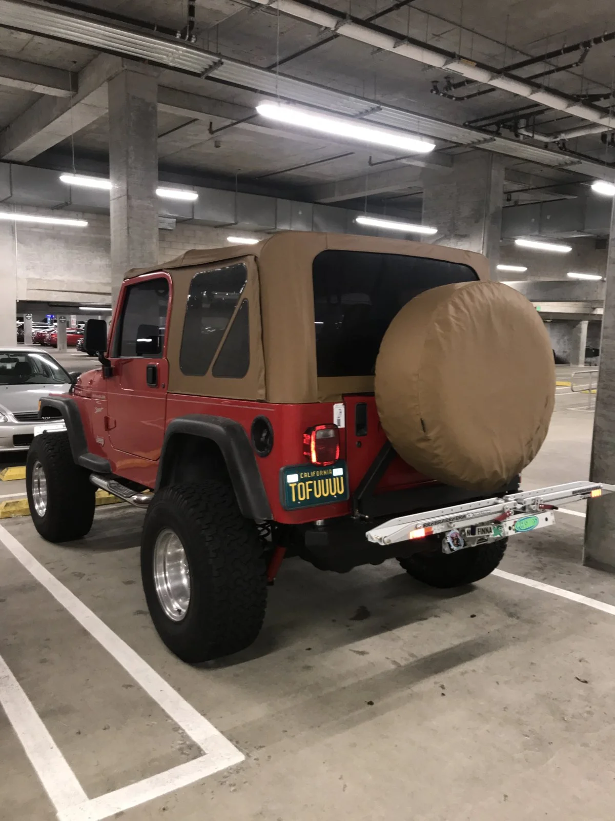

She’s done !...for now , all parts installed . See above for specs , looks good! Only thing to install now is my new oem flares , that and a good wash. Off to big bear we go
