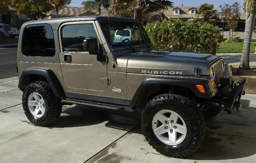

I replaced my previous 245/75R16E MT/Rs with 265/75R16C DuraTracs and the info I can find shows the bigger DTs are actually lighter. I use the stock carrier with both and haven't had a problem with either set. My tailgate hinges have swung stiff since I bought it but I don't know if tire weight has anything to do with that. I'm considering a MORryde mostly for peace of mind and a greaseable, smooth swinging hinge.
The only clearance problem I've had with the 265 DTs, which are 31.7" diameter according to Goodyear, on my stock Rubicon is a bit of rub near full lock. It seems to be little enough interference that I rarely turn the wheel far enough to notice the problem. I don't disconnect off-road and my trips are probably mild by most standards so I haven't noticed any other clearance problems with these 265 size tires.
