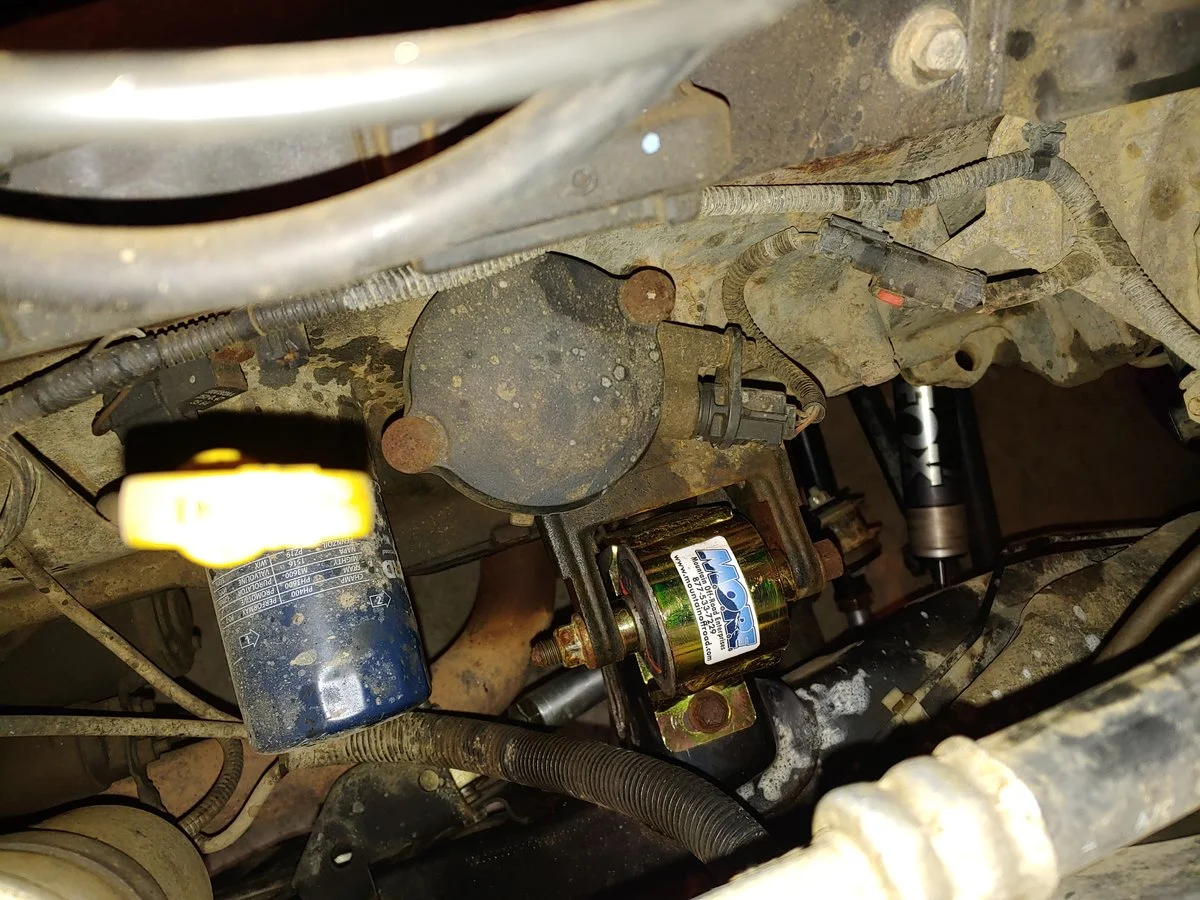

Going to be starting the TT today. Relocating locker pumps and installing UCF TC and engine skids. Hardware box was busted open on delivery so I had to buy more hardware. Painted steel parts and leaving aluminum parts naked. Should be set now. Was also able to source 18/2 shielded cable (although not needed) at Mendelsons Liquidation on closeout 25ft for $1.88.
Reactions: TJ Starting
Nov 30, 2019
Aside from creating a bunch of clearance issues the last couple days, got my TT installed, Savvy shifter cable installed, and locker pumps relocated. I used the OEM bracket plus the UCF relocation bracket to install on driver's side fender. Took a little extra time and cleaned up and painted everything too. Had to modify the front of the skid to clear the trans pan and use a pry bar to clear the cat from the tub. Changed TC fluid while under there as well. I like how everything turned out and looks...But, now have to install MML, modify spring perches or get brackets, create room for rear track bar, and get exhaust modded. Oh, the cost of clearance...

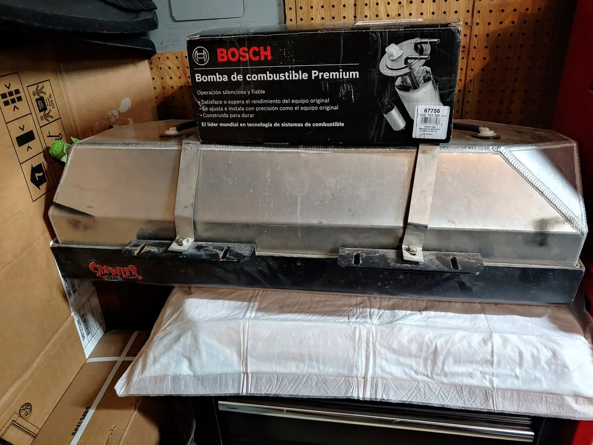

Dry fit Genright tank for marking drill locations...then removed tank and decided to continue with removing the shocks and springs. Cycled the suspension and found im a little off. Figure while I have everything out and waiting on new springs, I'll clean things up a bit. Then bought a Dana 60 so waiting on that too.
Jan 5, 2020
Found some motivation this weekend. Genright ext crawler tank provides so much room and clearance! Got rock crawler rear springs installed too. Supposed to be 4.5" but only getting 4".
