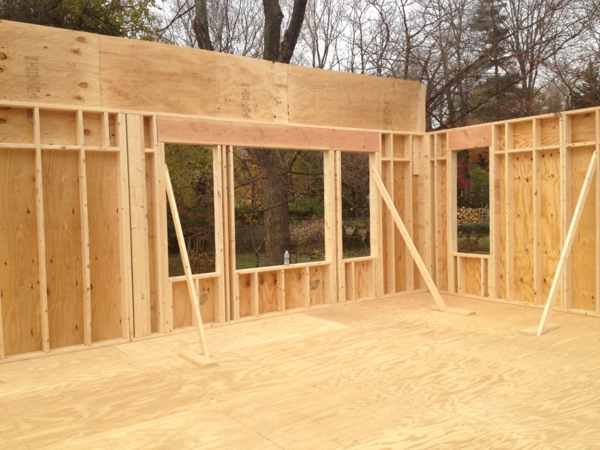

We regularly use Hilti cordless 6-1/2" dry cut saws at work, they work great for cutting off erection aids and temporary hand rail brackets that get in the way of installing our work, a recip saw with a carbide blade is plan B if the access is tight, and occasionally a portaband saw but they are limited.
Erection aids?
He's talking about wood.
