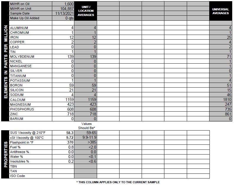

I mailed my oil sample on 22 Nov, and received my oil analysis via email Wednesday, 8 Dec. Things seem promising. I only had about 1,600 miles on this oil and the sample I sent was taken cold out of the bottles I'd poured the used oil into to take for recycling.
Here's their comments:
"Your Wrangler looks good at 104,887 miles. The wear metals are all in good shape compared to the universal averages, which are based on about 4,000-mile intervals. This oil run was a little shorter, so it's great to find a lot less iron. Other metals don't track as closely with oil use, so they're fine at near-average levels. The viscosity was a little thin for 10W/30, but neither that nor the 0.8% fuel dilution hurt anything. Small amounts of fuel like this tend to come from short trips or idling. There aren't any signs of coolant or water contamination. Nice!"
The full report:
The bit about "other metals" is the part that feels vague for me (could be good, could be bad); but this was a baseline and I'll just need to update with another sample in the future. The fuel dilution part possibly being a result of short trips and idling fits very much with how I drove on that batch of oil. Not concerned there.
