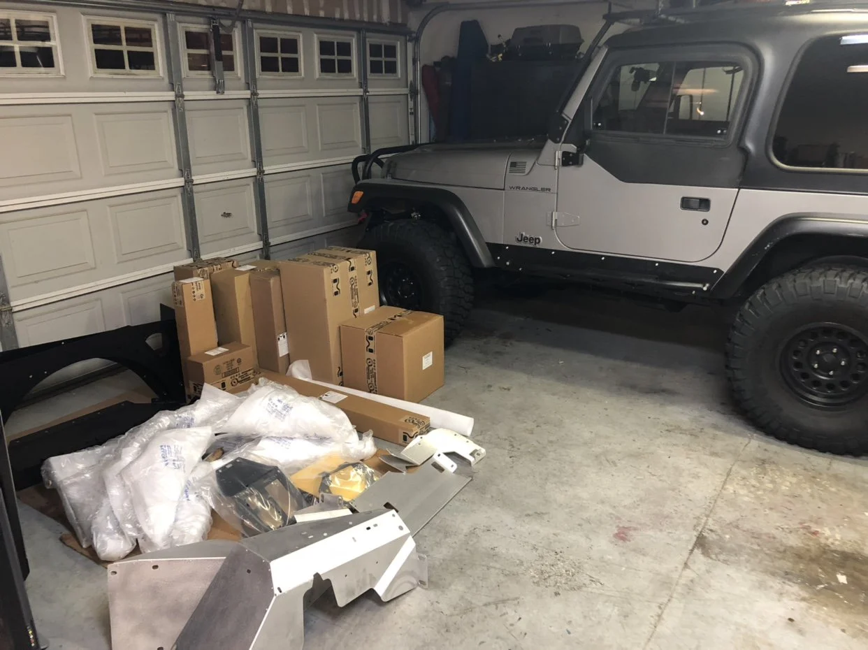

So the laundry list of items....
3.5” short arm rock sport edition
https://metalcloak.com/jeep-tj-lj-wrangler-parts-accessories/tj-wrangler-suspension/tj-lj-wrangler-long-travel-short-arm-suspension-3-5-rocksport-edition.html
  1. front Overline fenders 4” flair
    full rear corner guards and 4” flair
    gas tank skid
    oil pan skid
    steering box skid
    steering stabilizer kit
    front bumper light bar bracket
And couple other misc things

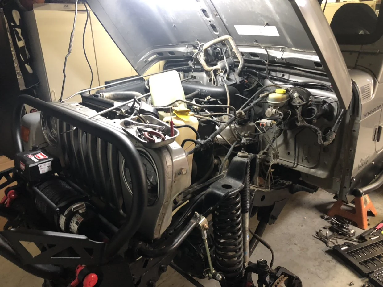

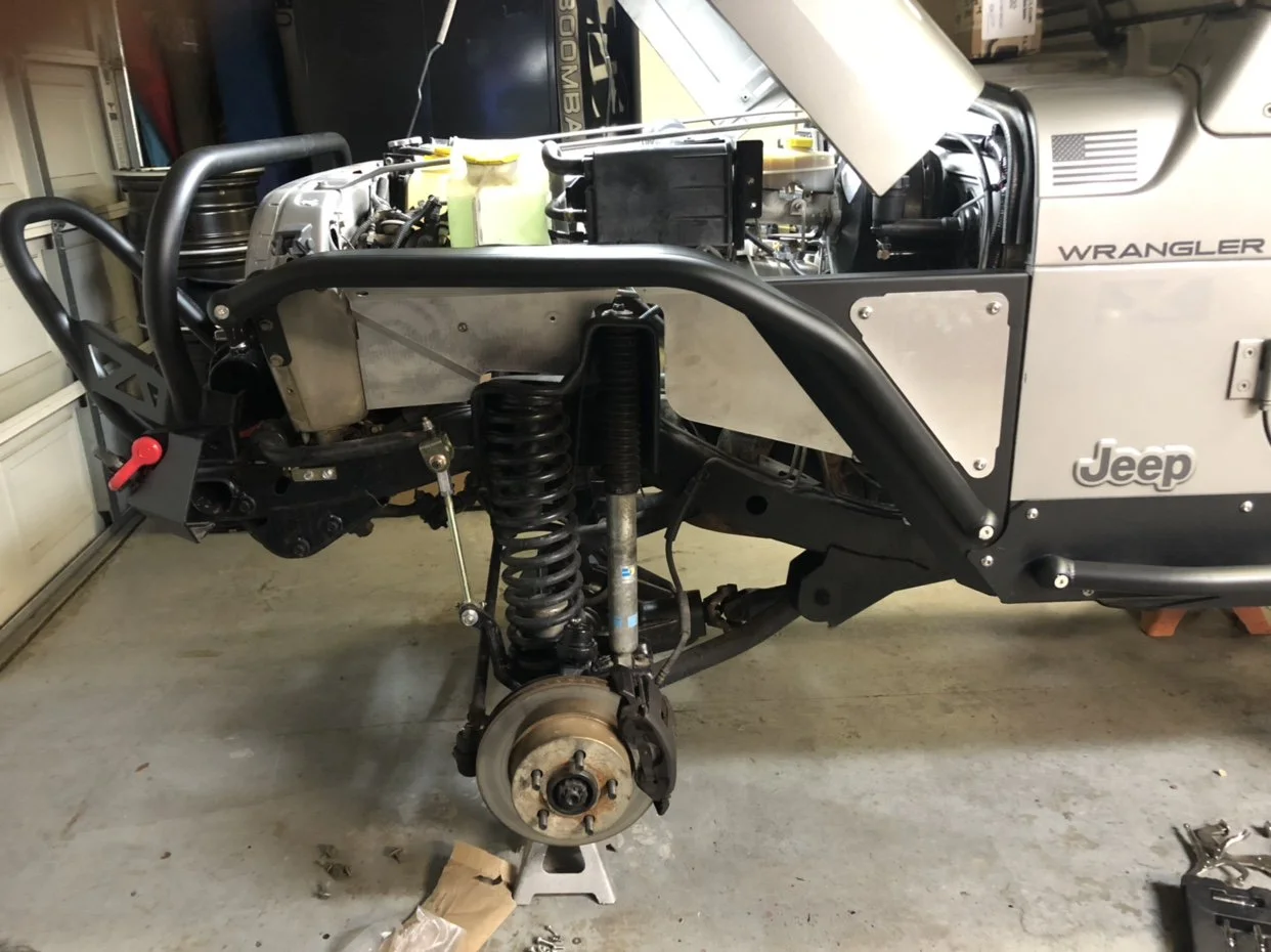

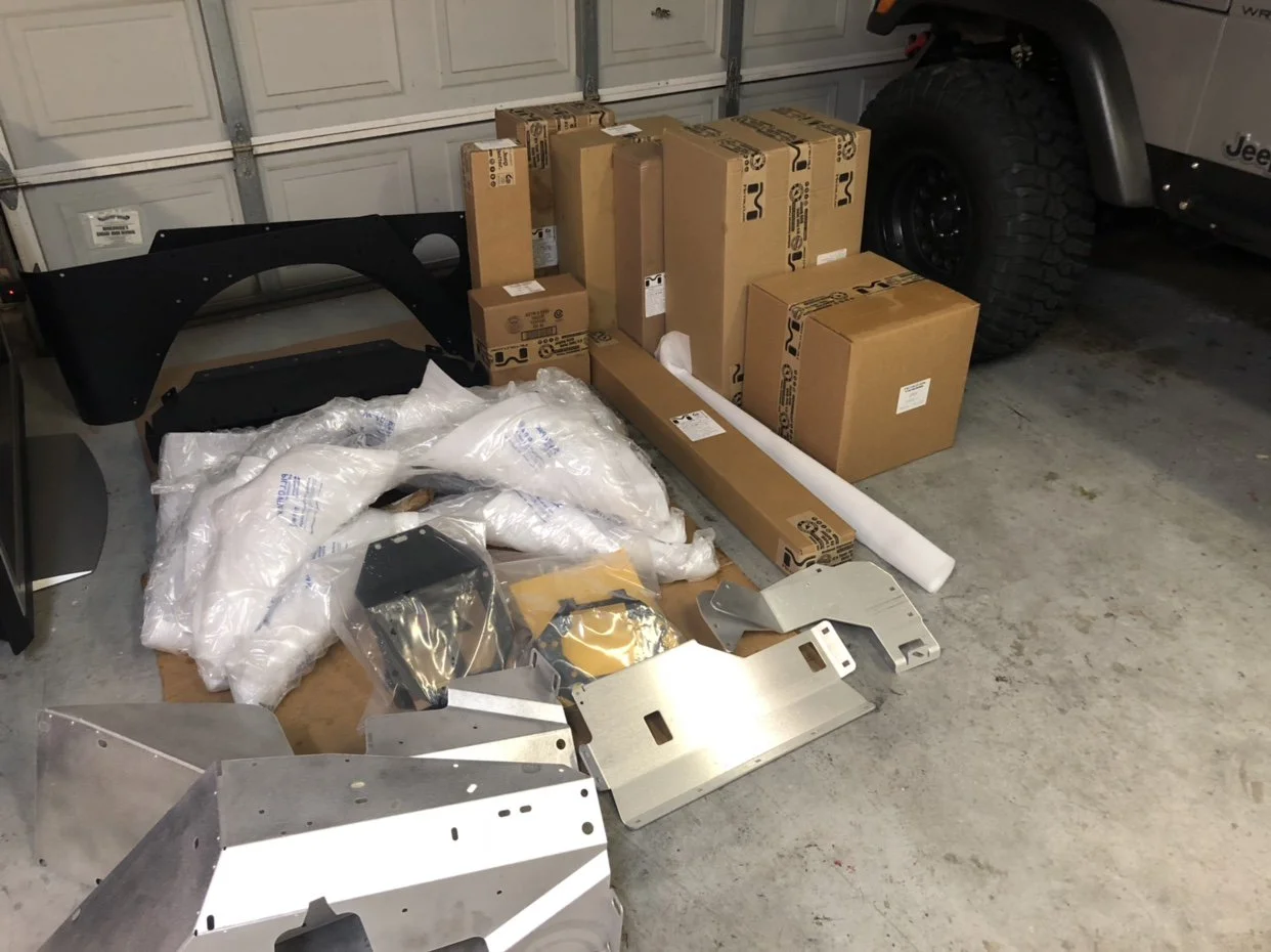

Slowly making the pile of parts smaller
Rear suspension all installed and tightened up
Front suspension mostly together. Gotta buy a 5/8’s still bit for the frame side track bar
Get it back on its wheels then turn it around in the garage and install the passenger side fenders (so I can still see the tv )
Then tackle the skid plates

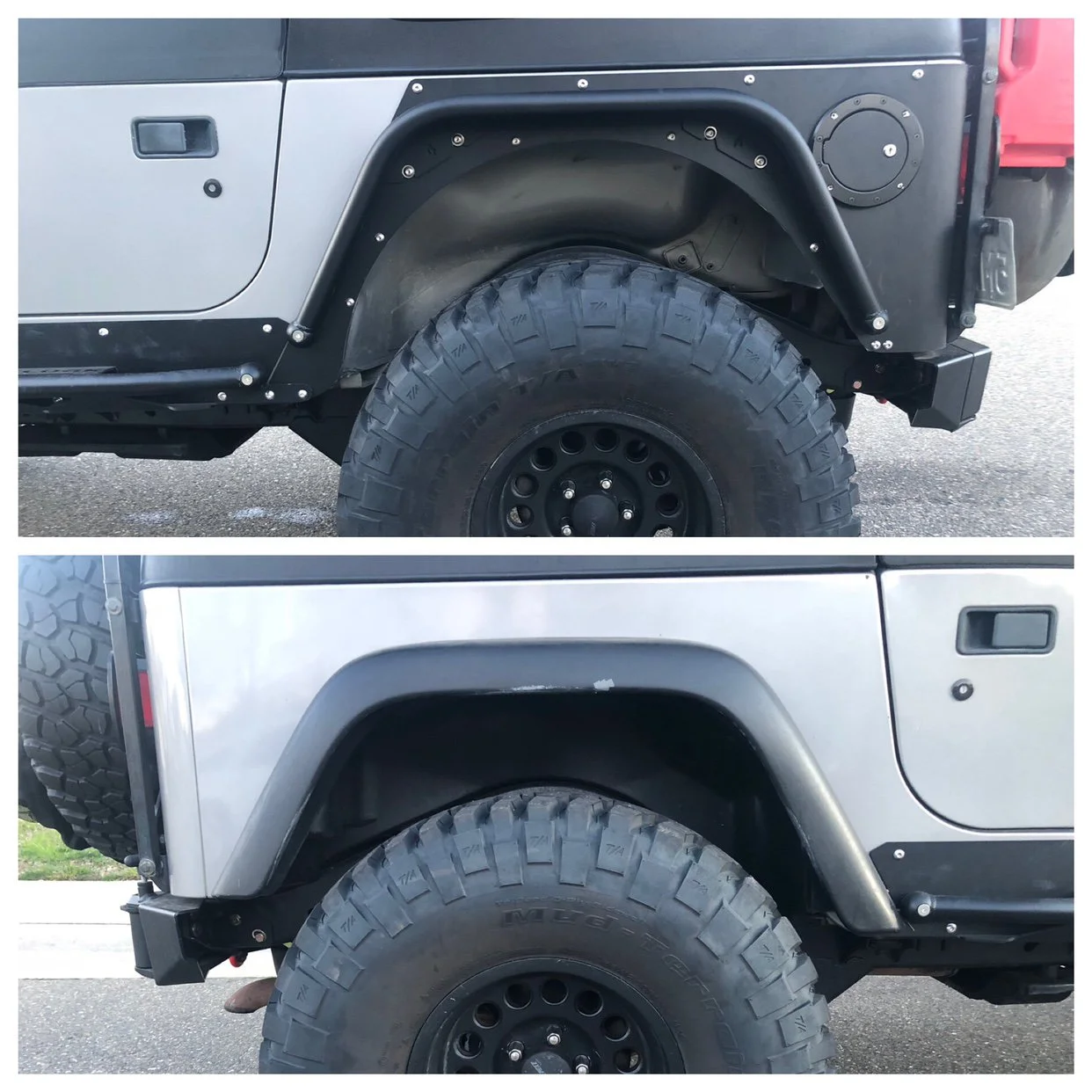

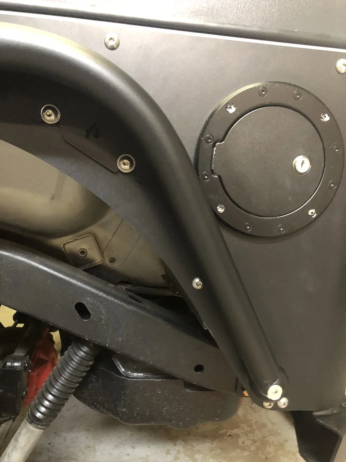

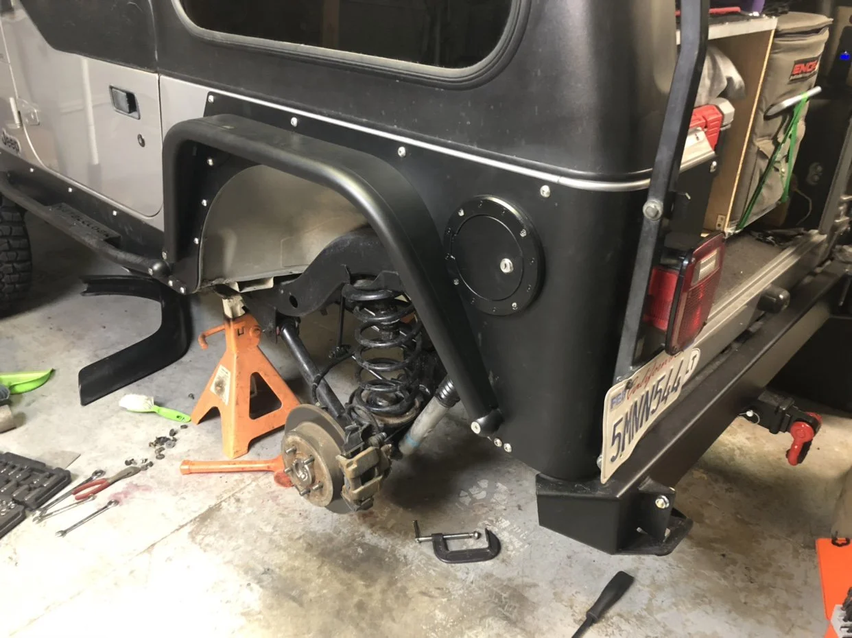

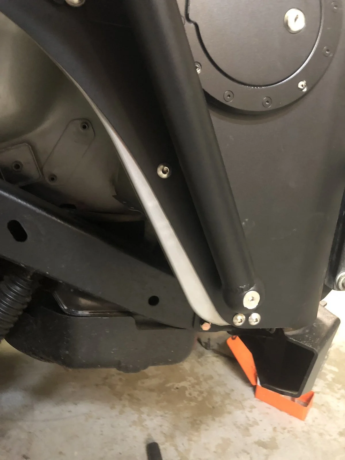

Your jeep is starting to look very familiar to me :p. Did you get the mod fit rear fenders or the ones that require no cutting?
It's looking really good. Was the oem driver side fender a pita to get out for you also? I felt like the passenger side was easy.
OP
TJDon
TJDon
Nov 2, 2018
124
Galt, CA
i did cut the little bit off the back.
And pulling the fender was pretty easy. So far everything has gone really smooth and easy with simple garage tools.
I did have to buy a 5/8’s drill bit for the frame side track bar.

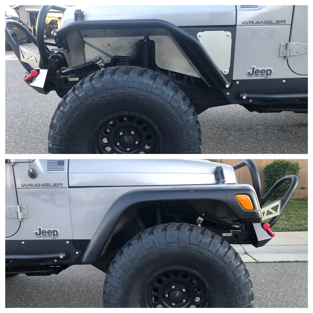

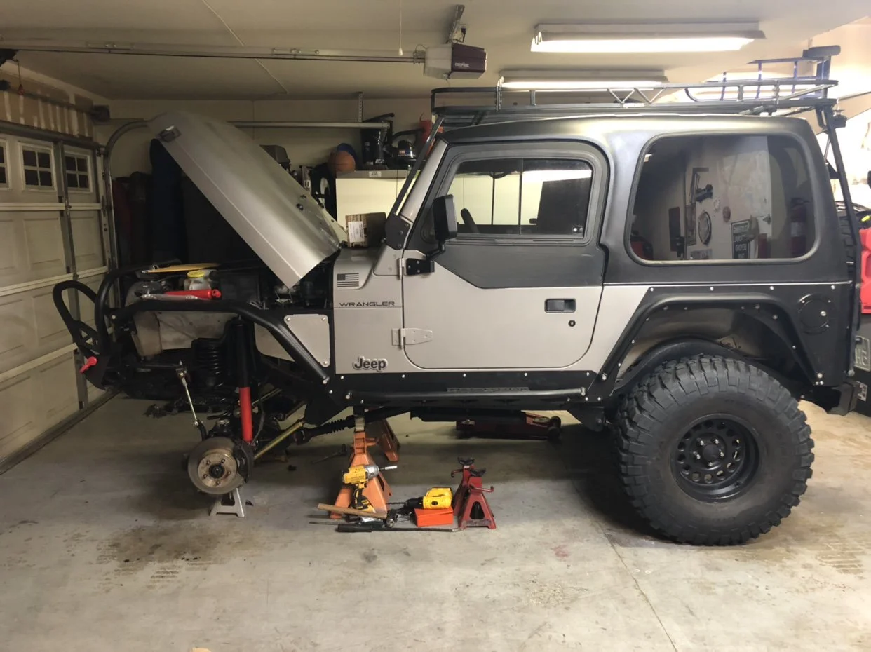

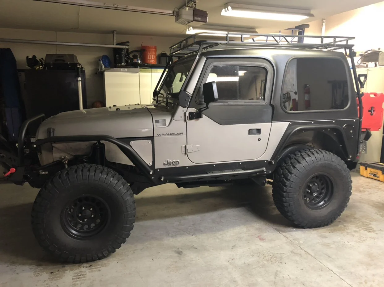

Got front and rear suspension done for the most part. Still have to replace front brake lines and replace LCA bolts at the diff.
I measured the height of the Jeep before I did anything. I’m curious once I drive it and get things settled in what the height difference will be from the old procomp 4” lift that was on it to the Metalcloak 3.5”
My 35’s are starting to look a little lost in the wheel wells now. 37’s would be sweet and I have the gears already done. Hmmmmm???
Now to turn her around and replace the other fenders.

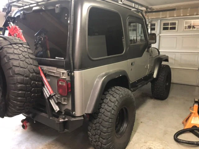

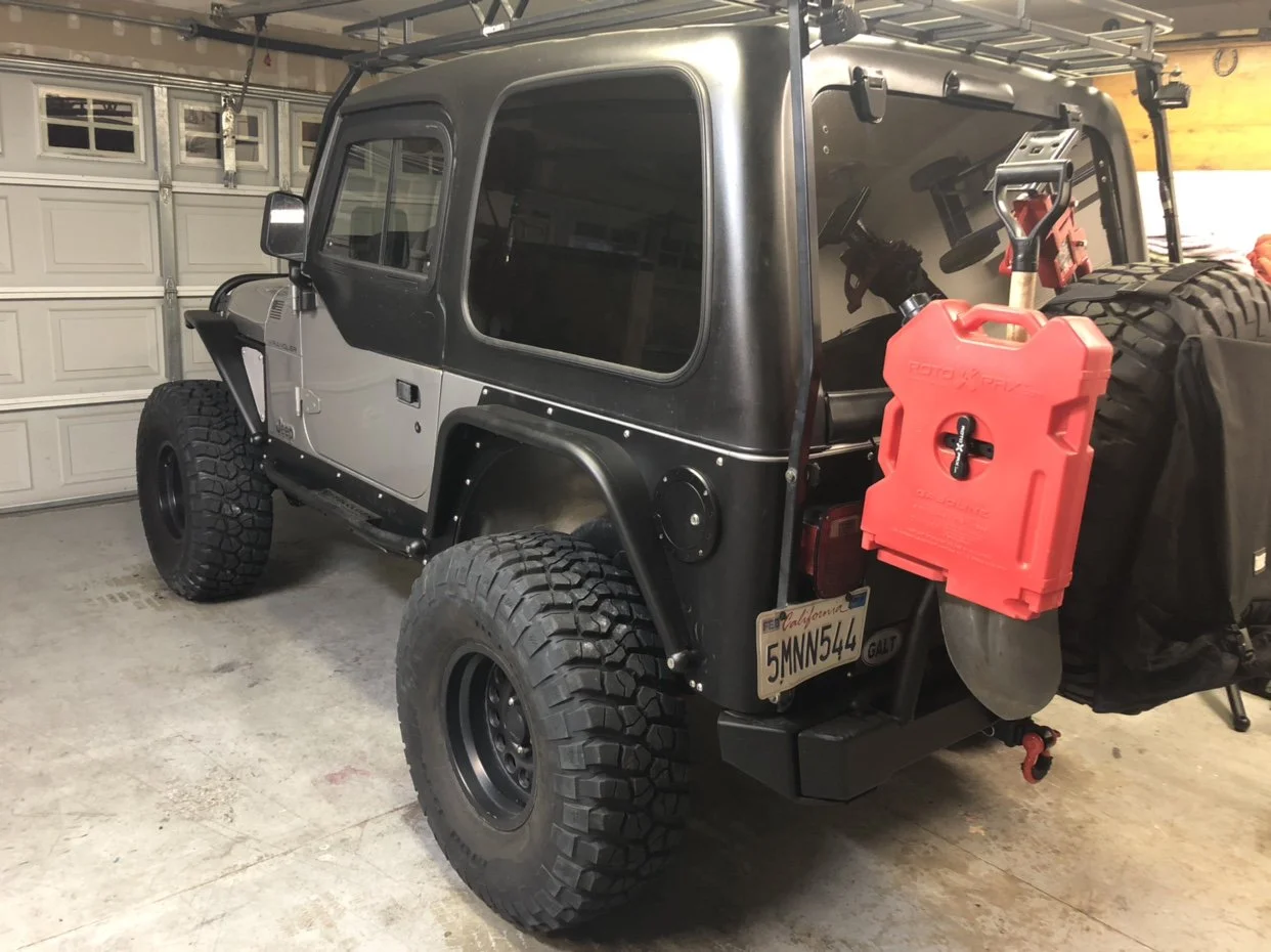

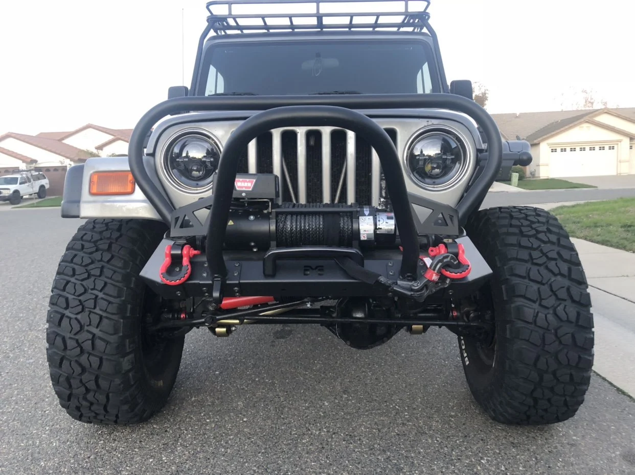

Once you have the other side installed, please take a photo from the front. I'd like to see how the 4" flares look. I think the 6" flares are just too much.
I will for sure. The coverage is probably gonna be even less than what the stock flare has. I hated how I was flinging mud before. Now I’ll have to take bypasses to avoid mud.
I’m with you on the 6” wide ones, I’m just not a fan of a wide flat fender. Looks like you could serve drinks off them
Reactions: b0xcar
IPerkWVU
Feb 11, 2018
629
Indianapolis, IN, USA
I don’t think the 35’s are getting lost, they look good as is.
Thanks for posting a pic of what the mod-cut looks like. If I ever went to 35s it may be the MC route since I only have 2.5” SL & 1.25BL and would need to trim that area. I’m weird about MC fenders, I like the fronts but it is the rear fender I’m not a huge fan of. Jeep looks good.
