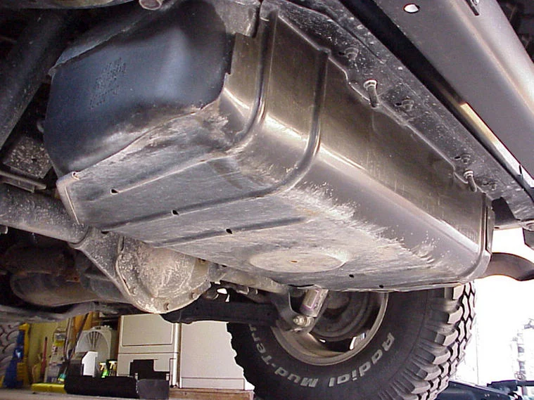

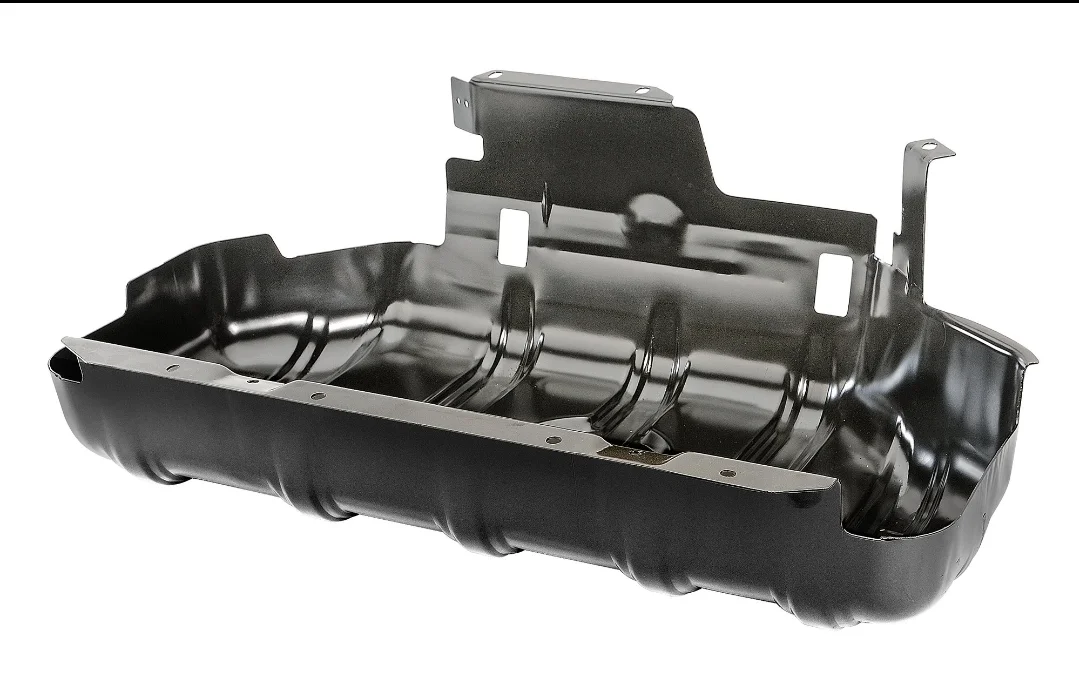

The specific year doesn't really matter because it isn't confusing as to which skid is which.
Early TJ with open sides
Late TJ enclosed sides
