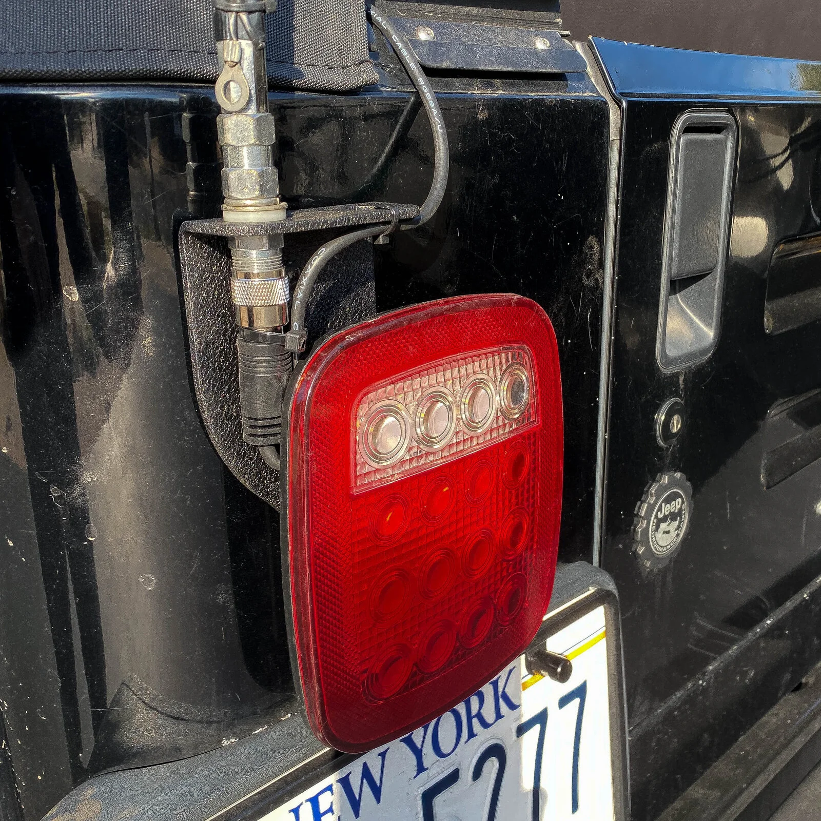

I have a standard Teraflex tail light mount for the Firestick..
If I mount the GMRS antenna in this location, it would be helpful to be able to use the current connectors, but I gather from your info that it will require some adapters. That could be fine, and I could trim some of the excess coax I have coiled up under my front carpet. I did understand that a shorter run of coax

right, so you could mount the GMRS antenna on the Teraflex mount, you would need to drill out the hole to 3/4" and get some NMO Coax because both of the midland antennas use an NMO mount. This is what I did on both of my mounts.

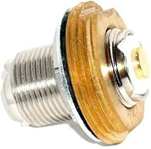

Looking at some radios tuff for another project today, I cam across these UHF to NMO adaptors, Wish I knew these existed when I did my tail light brackets. I think you should be able to get one of these, thread it though your bracket connect the coax and screw the antenna on top - I did it what is apparently the "hard way" though so can't garuntee that it'll work.
Reactions: MikekiM
Adapters are a good solution but I would NOT recommend the one you linked. I bought one and the threads in the brass ring were so far out of spec and loose that I could not tighten it down to the mount. It was a complete waste of money.
I am giving this one a shot instead. Hopefully it will have better quality control.
I changed my mind and went with a Breedlove mount instead. It was about $30 but I have used their products before and know them to be of excellent quality. Buy once, cry once…
I don't have a picture of it, but I used this same adapter and drilled the 5/8" hole in the left fender. Tightened it, ran by rg8x through the shock mount hole, into the firewall and into the radio. Perfect 1:1 swr on all gmrs channels. 👍🏻
