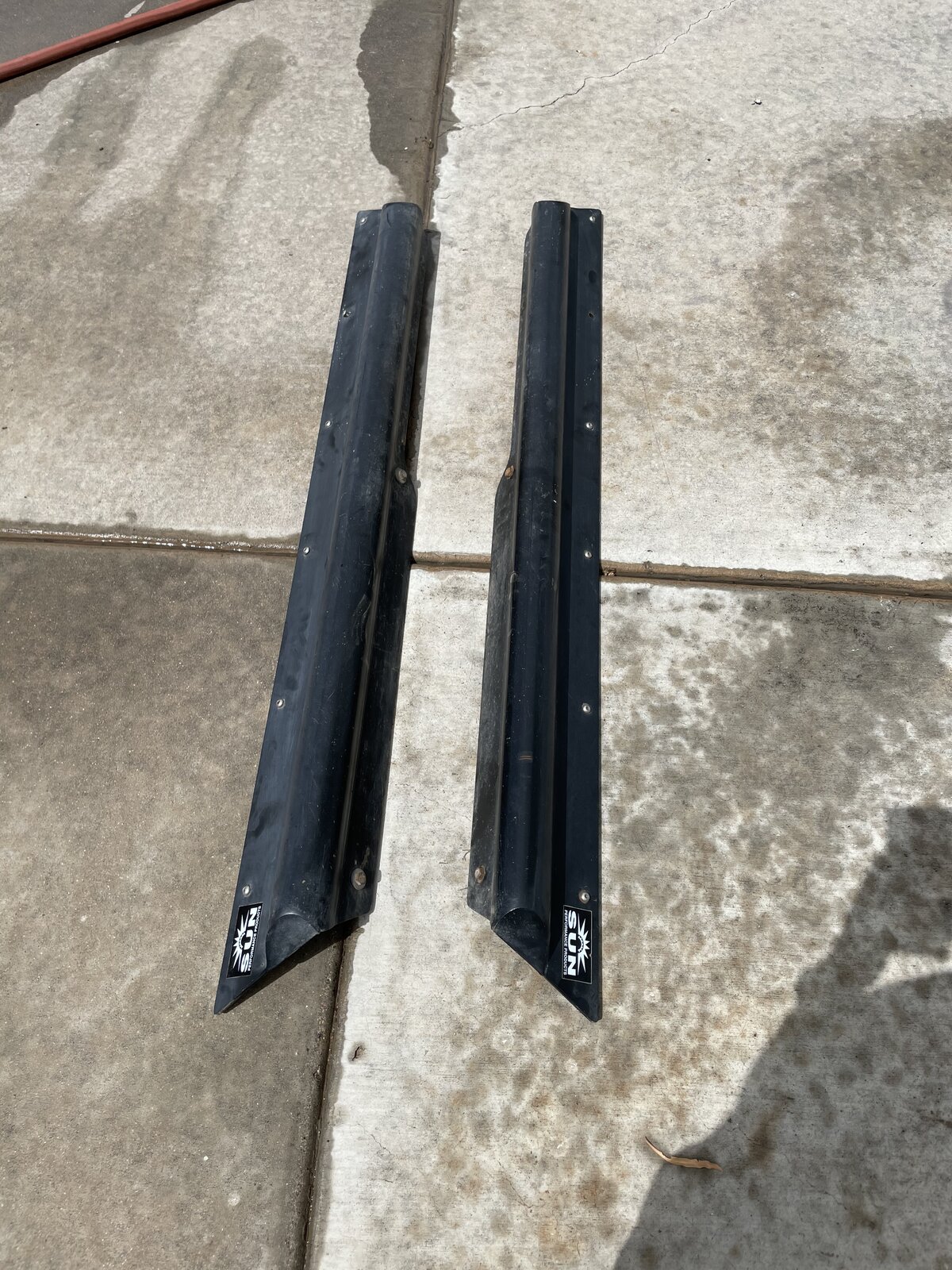

Picked up some used rock sliders locally. This company looks like it went under, but the design was praised back in the day as almost perfect with only minor issues easily remedied. No rock rash, just rough underneath from pebbles while road driving. Going to clean them up, paint, and put a thin coat of bedliner inside to keep the paint safe.
That is a really good design by the looks of it. do they go under your flares and cover the entire portion of the jeep tub or do they fit in between the flares?
Between the flares. That’s the issue.
