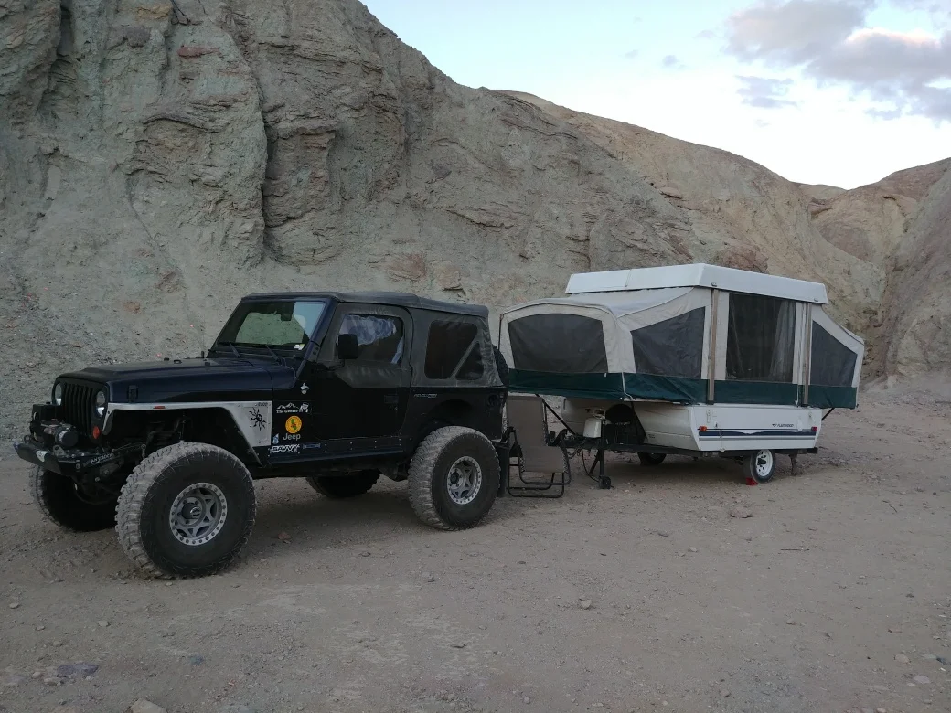

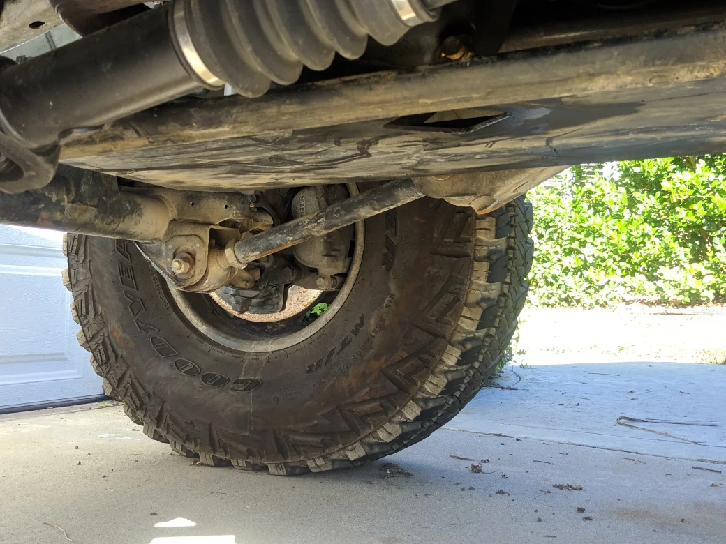

This is my control arm with a 4" Currie suspension, you can see its angle is not even close to being enough to cause a stiff ride. In fact my TJ has an excellent ride on the highway, so good my Lexus-driving wife even commented how well it rides on a long drive out to the desert while towing my 16-1700 lb. (loaded weight) pop-up tent trailer.
This is my pop-up tent trailer...
