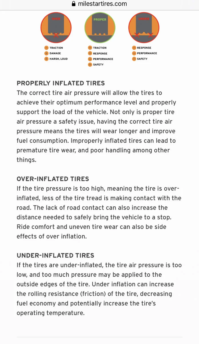

I read your post and took the time to look on Milestars site, I didn't find anything. I worded my post as nicely as I know how to. Obviously I'm skeptical but not to the point of discounting your comments.
What they do have does not match what I’ve heard from Litebrite and I see nothing saying to treat their MT’s different on their site.

I have no skin in this, but I will say if someone has designed a tire to not have full contact with the section width, you are giving up massive amounts of steering and braking input.
These are not motorcycles and should have the full section in contact. Otherwise, I’d avoid them if the manufacturer suggests such nonsense.
