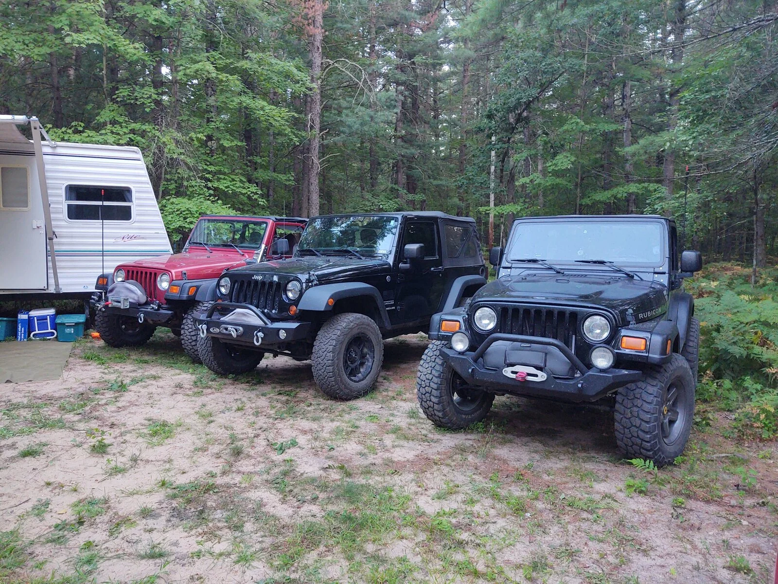

Weekend trip went great. Had lots of fun, got stuck in the mud (grrrrrr) and the Jeep performed flawlessly. I was leading so I didn't get many pictures of my Jeep (or in general). Here is most of the group, before heading out. Two TJ's and a JK, all on 33's. We also had a Cherokee on 32's.
Here, we've pretty much finished for the day. Had to give up my spare to the Cherokee...
A good time was had by all.

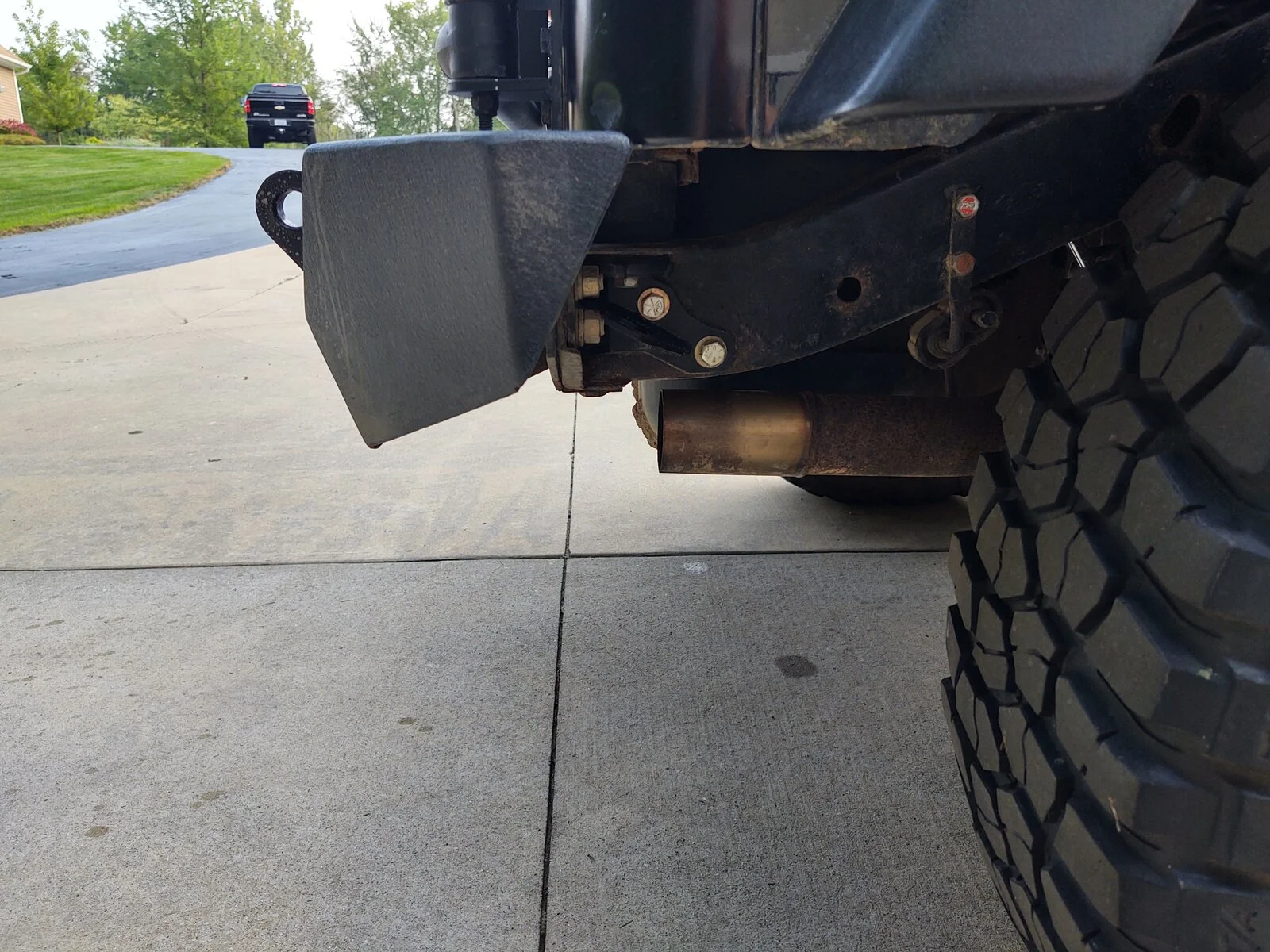

But, as we all know, mods beget mods, and I have another one to do. I spent most of yesterday getting the mud and shit off the Jeep. When I looked at it today, I noticed a spot on my bumper I thought I missed.
Turns out, my exhaust that is tucked up so nicely is cooking my bumper. Explains the hot paint smell I've had, but couldn't locate! I wouldn't think that it would be a problem, but the bumper is too hot to touch after a 7 mile drive.
I think I'll just try a turn down tip. If that doesn't work, gonna rethink my bumper choice.

Looks like an easy enough fix with some trimming and a turn down. Have fun on the trip. Ours is on standby with the wild fires looming the area.

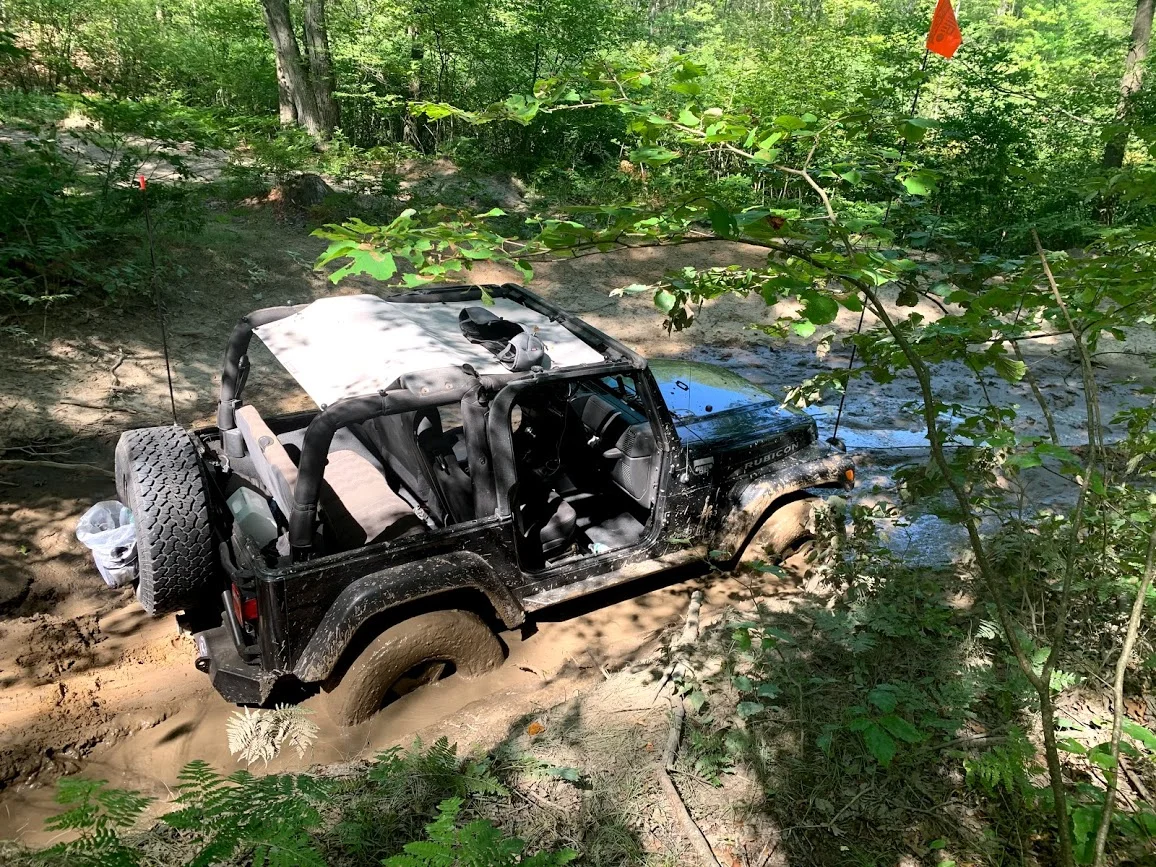

I would say yes. I know I got into the skids (as evidenced by some scratches). I only hung up twice. Once was deep mud, so the BIG tires are the only way to combat that (this mud pit probably would have needed 37+). The other was in a little rock garden where a rock shifted and got under my rear axle.
I also know the other guys I was with got hung up on more stuff than I did, and we're all build pretty similarly, except the TT.
Reactions: psrivats
I think I mentioned the deep mud pit that I got stuck in last time I went wheeling. You guys out west might have beautiful vistas and gnarly, rocky trails. But, you don't get to have anywhere near this much fun! /sarcasm

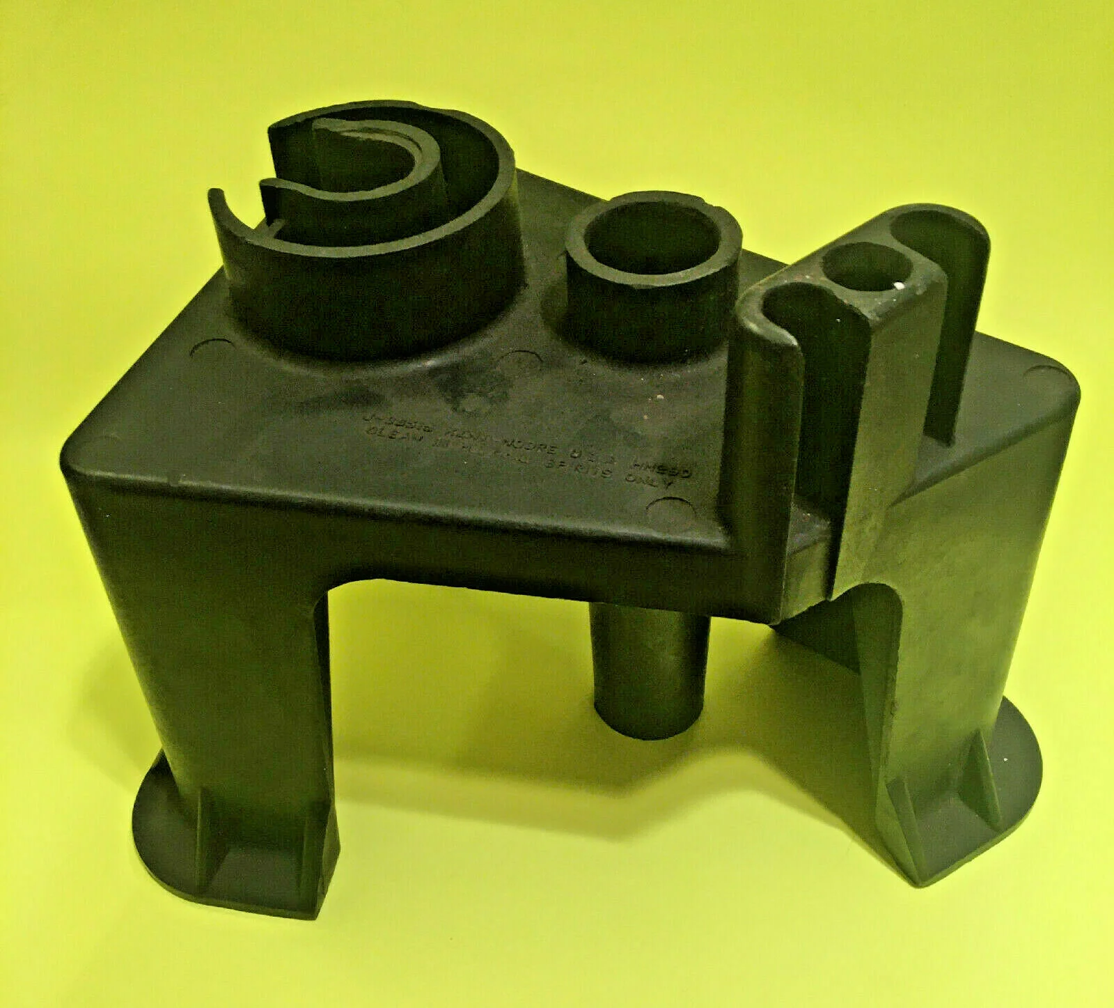

I got lucky today. I've had an ebay watch set-up for the miller support fixture to hold the main and counter shafts for the NV3550 transmission for a while now. A new listing popped up today for the fixture, but missing most of the other stuff. I made an offer for 50 bucks and it was accepted! That is, by far, the cheapest I've seen a fixture go for, even incomplete like mine is. Its a small thing, but I know my transmission could use some synchros...Now, I can justify buying some parts and not having to pay someone a ridiculous amount of money to work on it!
@rraulston I may be hitting you up for some info on the reverse gear holding fixture (the big thing this is missing).
