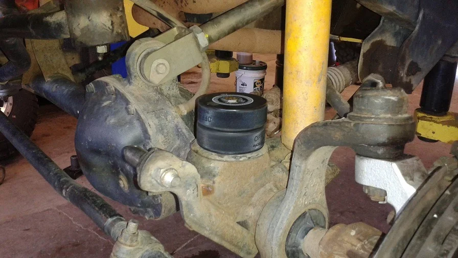

Here is an example of 2" of added bumpstop to the front coil spring lower pad. Yes you'll need to pull the springs, drill/tap threads in the lower pad to add more bumpstop.

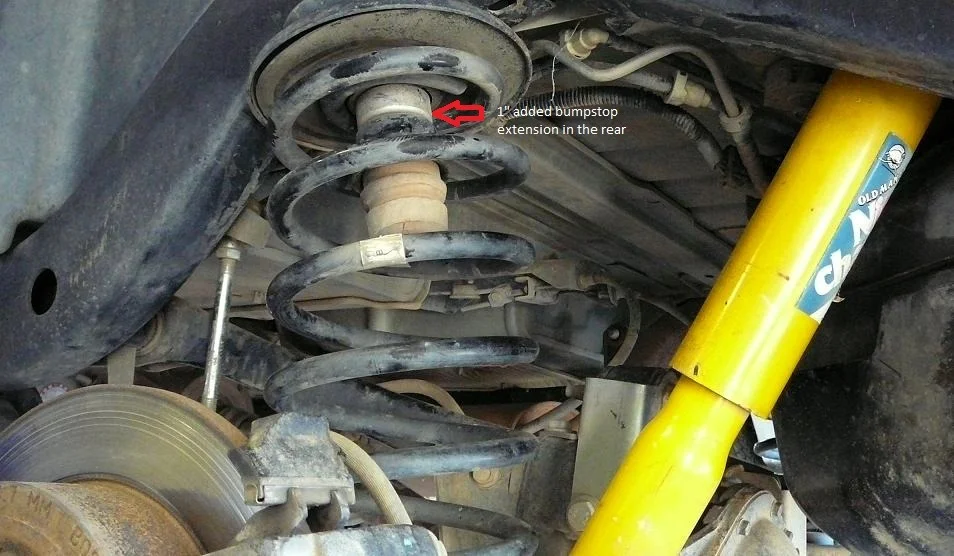

Example of 1" added bumpstop in the rear.
