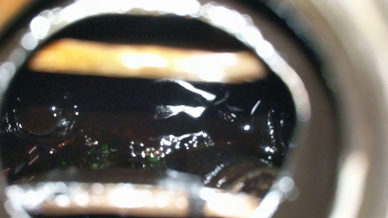

Is there a sure way to verify a cracked head or no without pulling the head? How does the crack normally present? 400 miles in was the last time I looked at the oil and there's no milkshake or anything. Does it leak into the intake and steam clean a cylinder?
Edit: Also, I've had it wot a fair amount, but I lifted around 4500 rpm to let it shift. I forgot to while looking at the fire, so it hit the rev limiter and those cylinders just shut off like a light bulb.
Remove the oil cap, look straight down at the head with the engine hot. It usually cracks and leaks there.
You can also sample the oil and send it off for analysis.
On my YJ, which just has a single coil, when it would get weak, the engine would just quit under WOT. Let off the gas and it would fire up.
I checked the jeeps oil after I got home on my motorcycle and it's about a quart over full. Not a good sign to start.
Pop the oil cap and fire it up....
I don't think you can get any more proof of a cracked head.
When I first got it to my friends house, about 20 minutes from the point of purchase, I added about a quart of coolant to the radiator. So it's maybe been leaking a while. What are the odds my cross country trek messed up the bottom end? The oil on the dipstick doesn't have any sparkles in it.
You're probably OK then. If the bearings were wiped out, you'd have low pressure.
You can get a test gauge and screw it in the sender's port for a more accurate measurement if you want.
