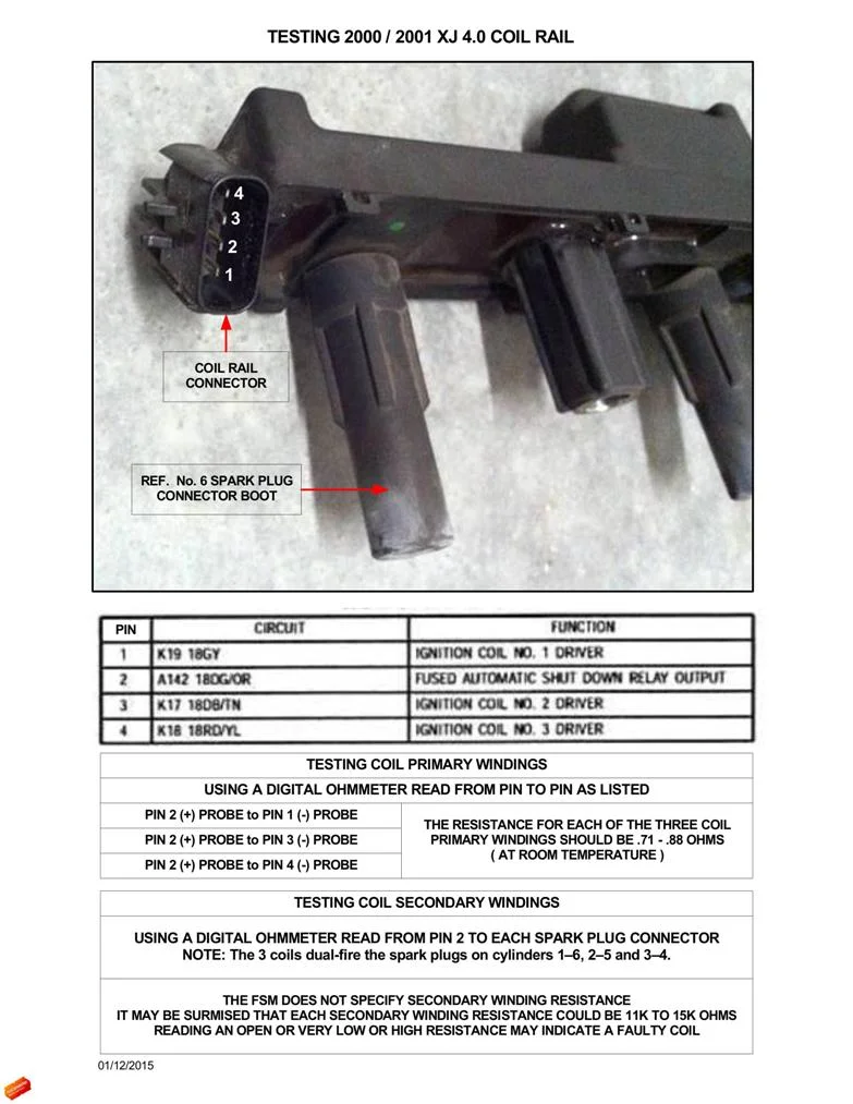

So it ended up being a bad spark plug. I had rented a compression tester from a local auto parts store, and went to the engine and took all of the spark plugs out to test the cylinders. Each of the cylinders had good compression 160,150,170,165,170,180psi in order. So I figured those were all fine, and so I went to put the spark plugs back in. One I noticed was really squished in, like maybe it had fallen or something and gotten the end squished in, so I re-gapped that one and all of the other ones to .35 and started to reinstall them. I put them all in different just to double check to see if the problem was isolated to one cylinder. Then as I was starting one of the plugs, the top of it broke off. spark plug fell out.webp
so I though that couldn't be good. And so I installed it anyway and started the jeep. There was still a misfire. I went back to the tailpipe and you could still hear the puffing sound from earlier startups with the misfire and it smelled very rich and it looked like gas was actually coming out of the tail pipe. So I went back to the engine bay, and took the broken spark plug in, and replaced it with one of the old spark plugs that still worked, and the jeep started right up and sounded normal again and did not have a weird vibration. So I took it around the block to see if it still had that vibration when under load and it was gone, and it was perfectly normal again.
So I am thinking what happened was, that positive node on the spark plug was not making good contact with the actual plug to make a spark when it was installed in the engine block. But when I tested it, the spark plug was upside down with the sparking part up in the air, which put pressure on the node in the coil rail to actually make it spark so it looked like it was working.
