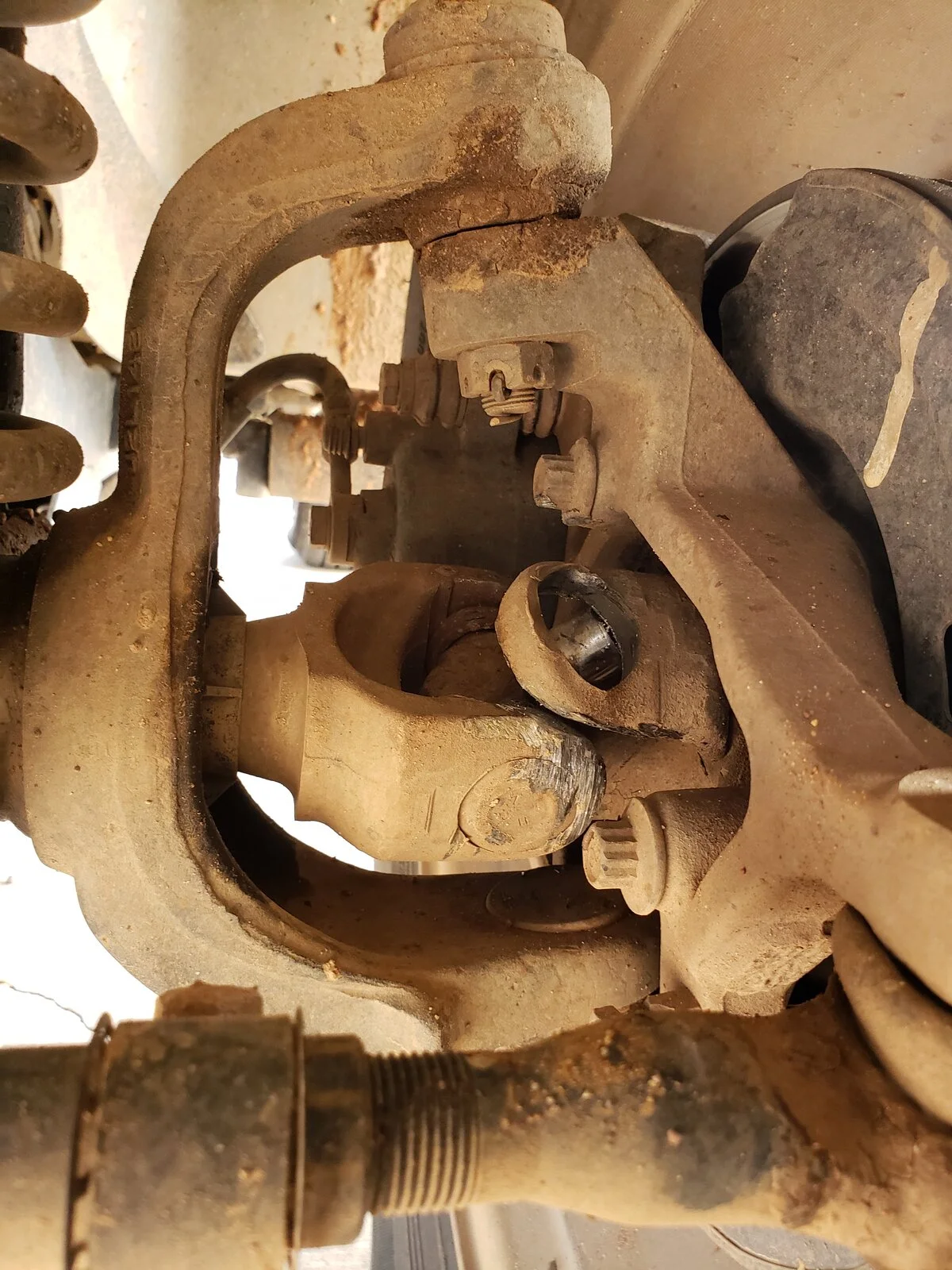

I'm finally getting around to having my front axles replaced. I've also been acquiring everything to do the 2" budget list, aka new springs, new Rancho shocks, front disconnects, rear stabilizer bracket. I bought Yukon axles through Amazon and got a call from the mechanic that the box was missing one outer axle shaft and the two ujoints, which I was replacing because I destroyed the driver side ujoint. So he will reuse one of the originals and he ordered two HD spicer ujoints to finish the project. I decided to replace the inner seals and look into why my front locker wasn't engaging. I guess the little air hose inside of the housing lost it's retaining clip and had slipped off. So now I get to fight with Yukon gear and Amazon about the missing parts, YEA!!!
