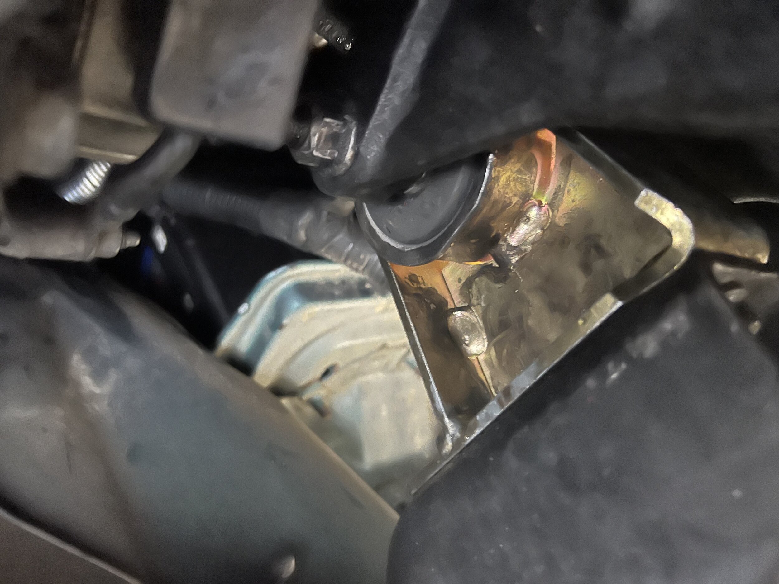

Man that's a tough problem. I have installed Currie, Brown Dog, and Bombproof rubber mounts from MORE and only with the Brown Dogs did I see more vibration.

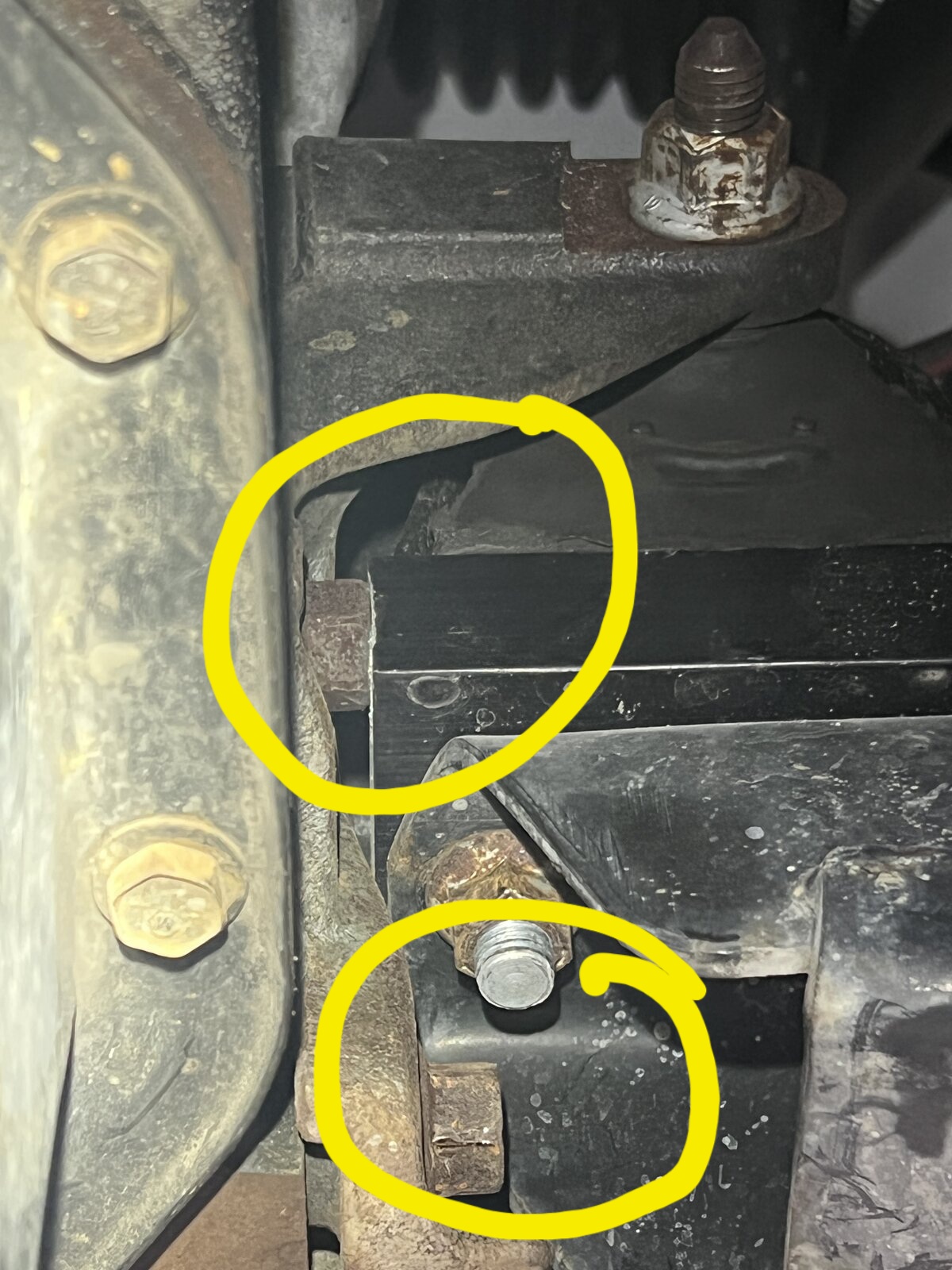

Not sure about the 2.4 but on a 4.0 MML by MORE the passenger side sometimes has to be modified as the bracket hit the frame and it transfers vibes into the frame. Make sure you Have plenty of clearance, and consider what it will look like at full torque.
This^^^^^
You just need to trim a bit off of this is the case. Angle grinder and cutoff disc. You can get in there without removing the mm.
This^^^^^
I’m not sure where it would be contacting the frame? Looks like it’s clear from up top.
Look from the bottom. It’s very slight but can transfer vibrations. I’ll have to go look at mine again, but I definitely had to trim from underneath.

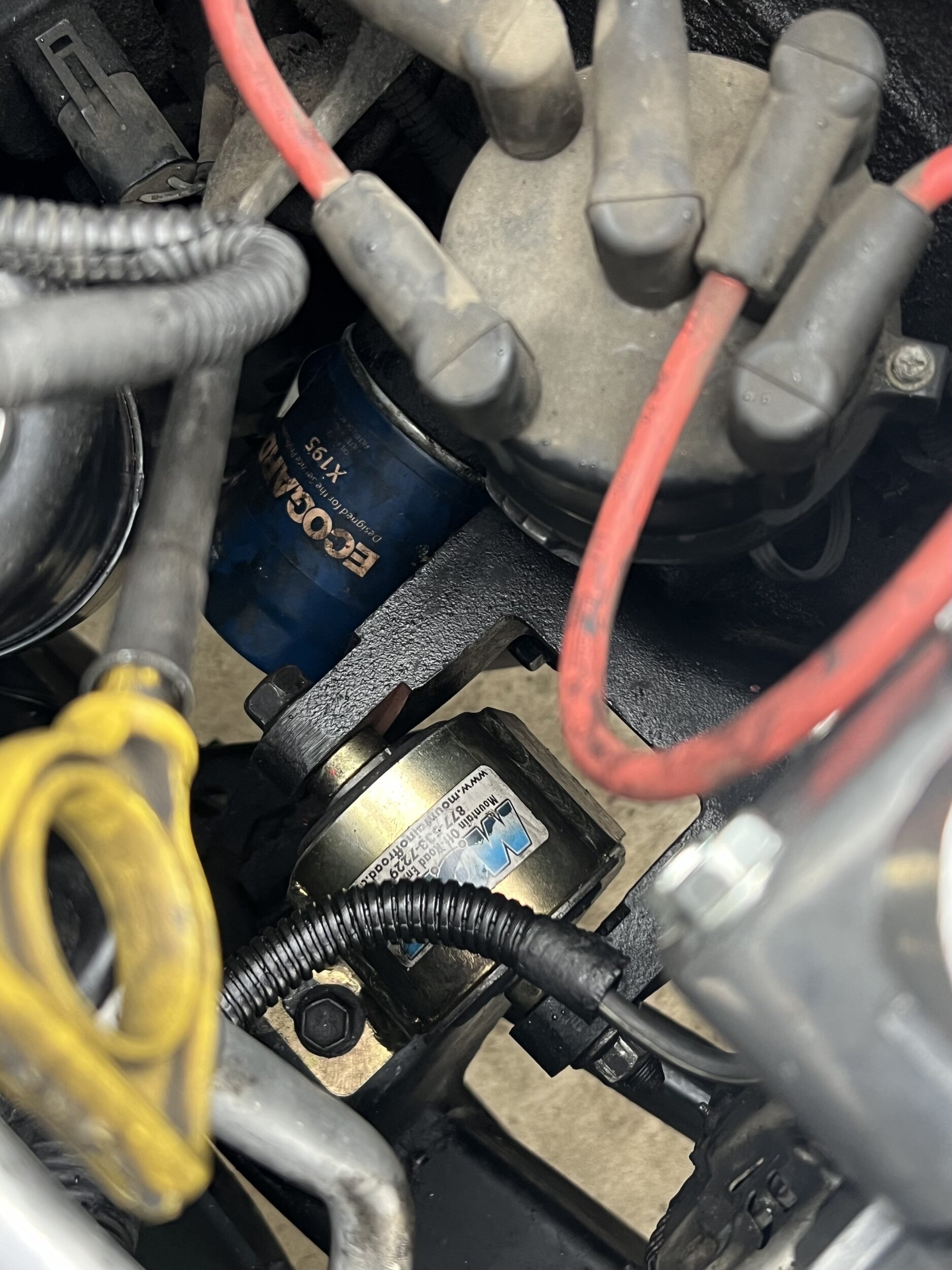

I think I’m down to:
  • maybe the bolt behind the passenger side mount that mounts the bracket to the engine block isn’t tight enough (that bolt is impossible to get to)
  • Maybe the bolts to the frame are too tight or the mounts aren’t lined up perfect
  • Bad transmission mount (is there a piece of wood under mine?)
  • Or these mounts are just way to stiff and I need to go back to OEM with a spacer (really really don’t want to)
I’m pretty confident the thru bolts are torqued correctly and every bracket bolt on the passenger side minus the one behind the mount are torqued correctly. The bottom 15mm nuts are torqued correctly. The top ones I had to fight a bit.

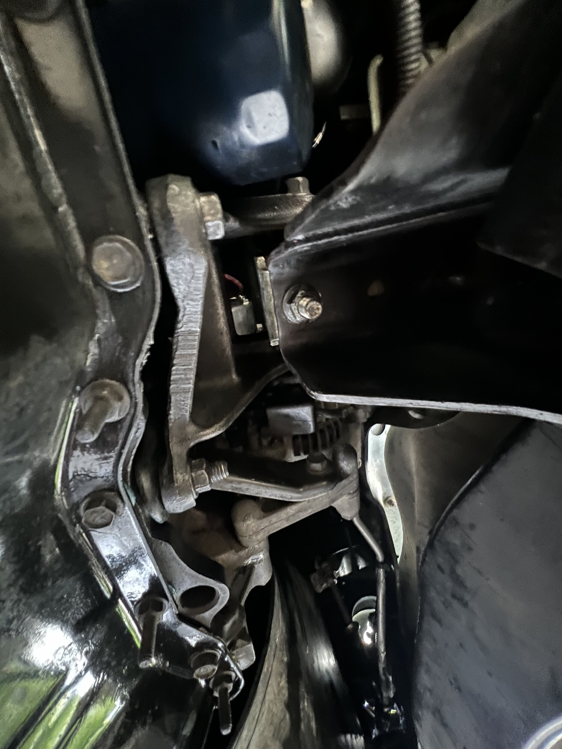

Somewhere I had great pics showing where the passenger side mount (on a 4.0) hit the frame. This was just a quick grab. But check this area carefully.

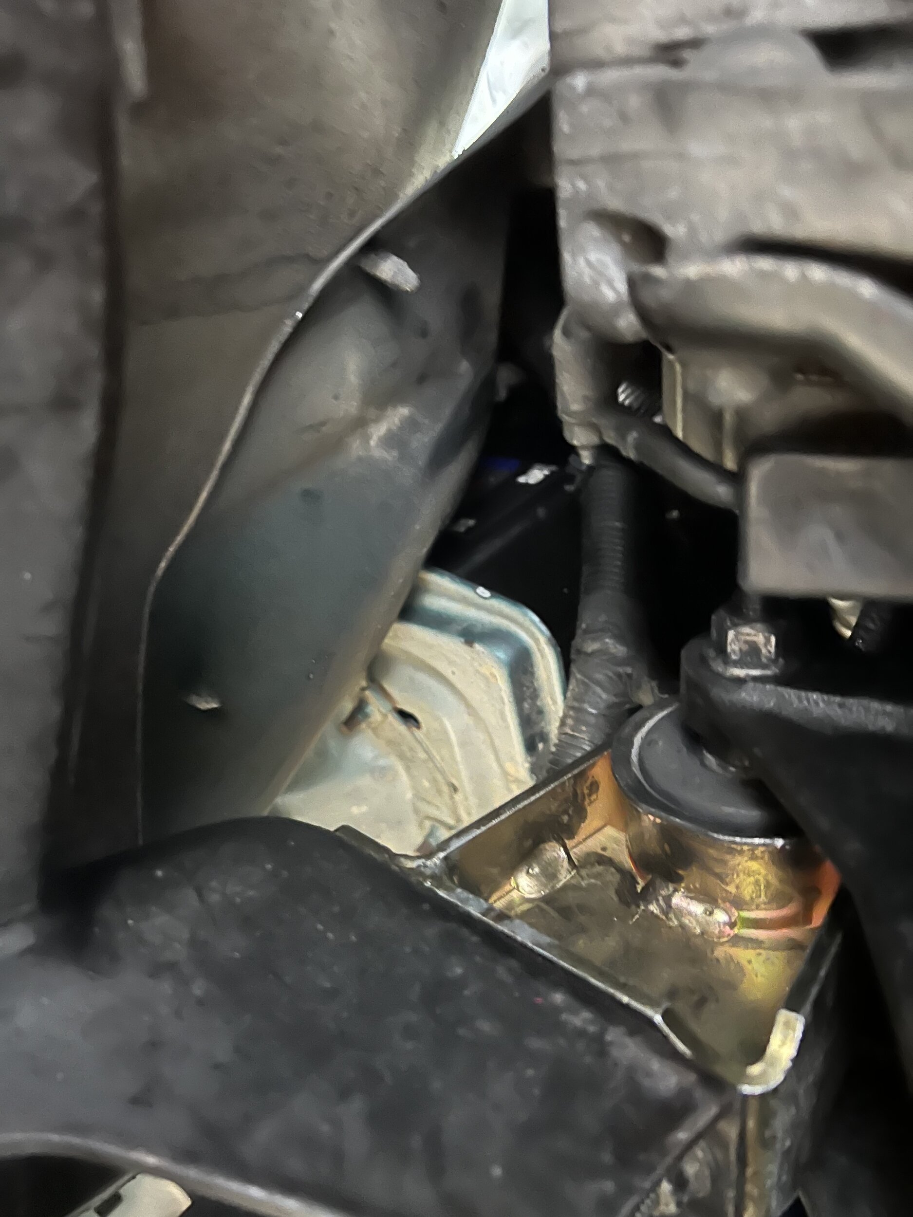

I'm realizing looking at this photo back on my computer... Is that a piece of wood under the transmission mount? Am I crazy? Is that normal??
Sure looks like a piece of wood! If the shop is not familiar with TJ’s, make sure they know to support the trans before removing skid plate.

I need to know. Was that a piece of plywood in there? I only have a picture on my small phone.
