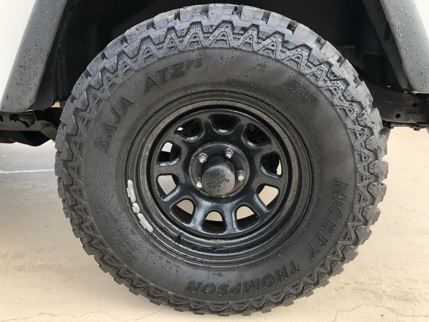

Good morning. I found a set of Moab 16” wheels somewhat locally. I’m considering purchasing them at four wheels for $300.00. I currently have Mickey Thomson’s 265/75/16 on Black Rock wheels.
Two questions:
Will my current tires fit those rims and subsequently the Jeep well? I don’t know much about offsets, spacers, etc...
