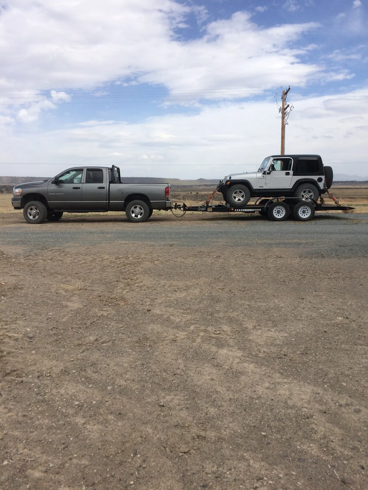

All packed up and ready to go to the Doctor! 😸
Er, uh, I mean Action Axle in Redding. And I’m hoping that Tony’ll help get the DS issue resolved.
