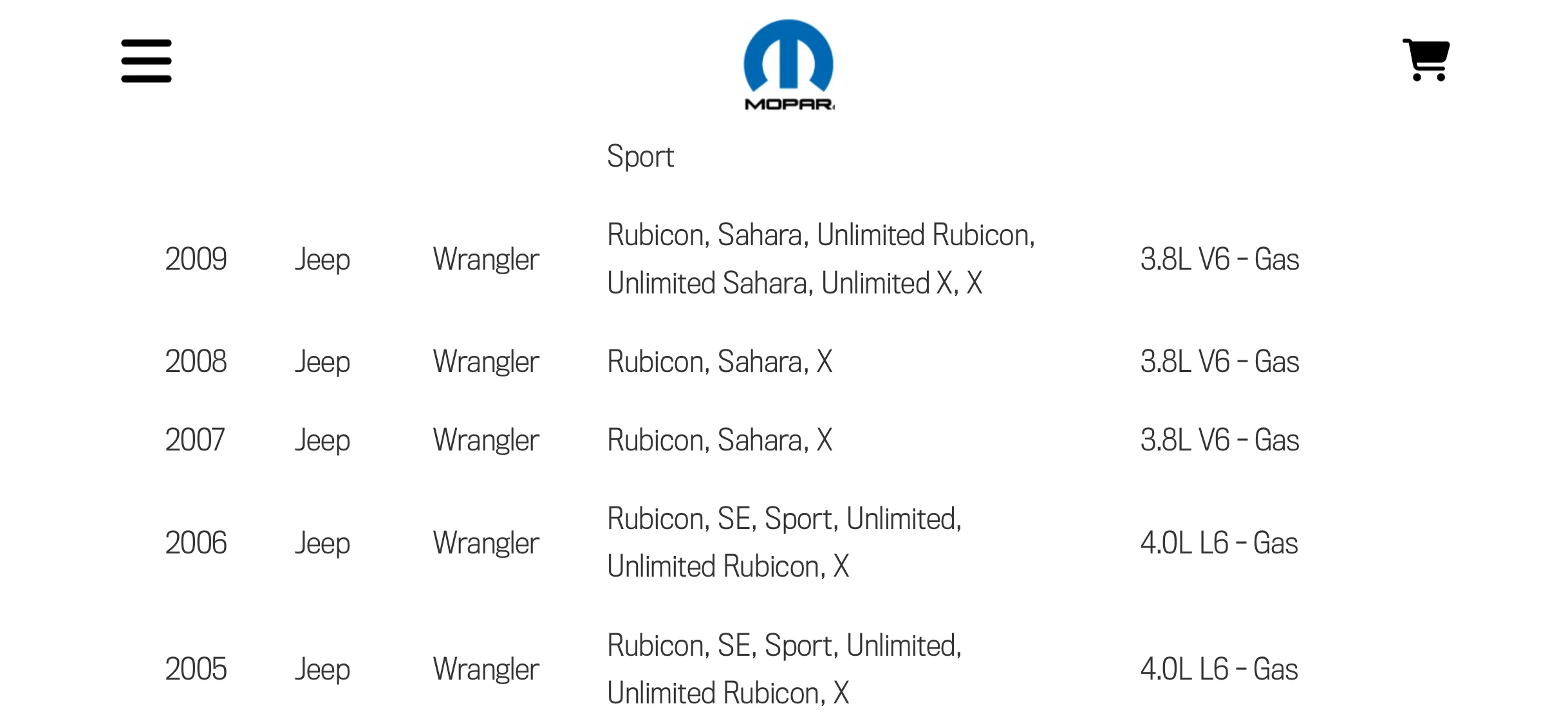

Mopar lists a clutch that purportedly fits Jeeps from 2005 to 2011. It does not appear to be the popular Luk clutch, but I can’t tell for sure. This clutch comes directly from the local Jeep dealership, with part no. 52104732AC.
Is this even possibly right? I have a 2005 LJ that has developed clutch issues (grinding) within a few thousand miles of installing a new Luk clutch.

https://store.mopar.com/oem-parts/mopar-pressure-plate-and-disc-clutch-kit-52104732acView attachment 537553

That looks to be the right clutch. The part number for the clutch kit in the 2005 Parts Manual is 52104641AA. The link you posted states that it replaces 52104641AA.
The NSG 370 was used in the early JKs, as well as the last two model years of the TJ, so it makes sense that the clutch overlaps models, too.
