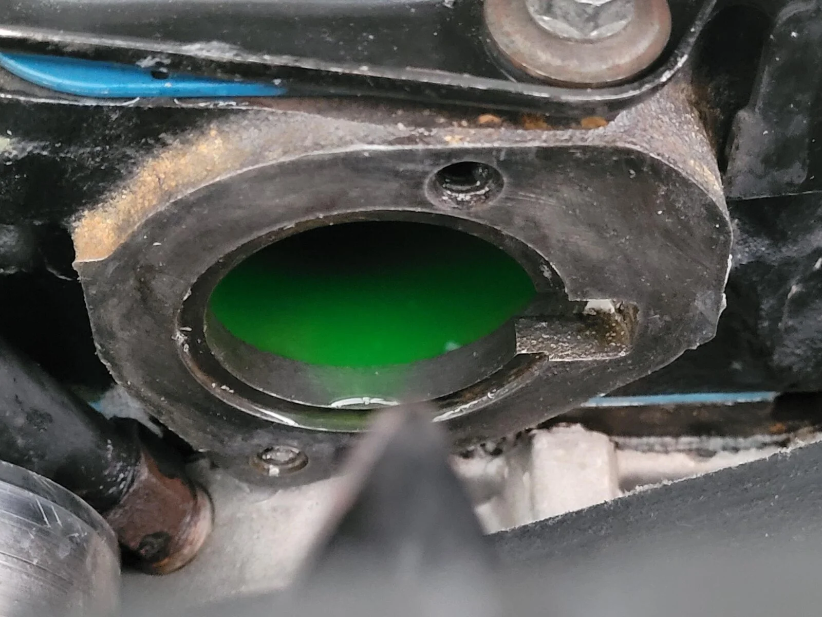

Since I have ordered the proper thermostat, where is the weep hole supposed to align? I noticed this big notch to the right and thought maybe there.

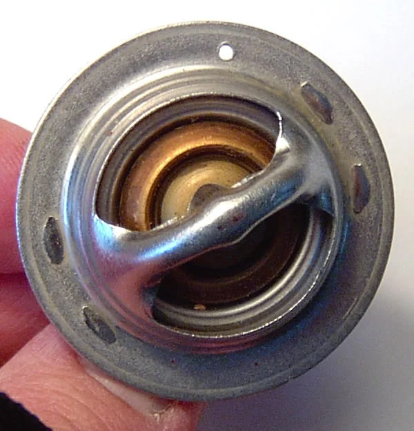

Just noticed the new one doesn't even have a bleed hole! I got it from a dealership too! Wonder why? I don't want to put in another Thermostat that fails after 5 months!
Lacking a bleed hole won't make it fail, it just makes it easier to get the air out when you're filling it back up.

It sounds like you have the correct thermostat now, but it doesn't have a bleed hole. You can still proceed with the thermostat installation but may need to burp the system a little more thoroughly to ensure no air pockets are present. If you feel more comfortable having a bleed hole, you can drill a small hole in the thermostat in the location indicated in the linked thread. Just be careful not to drill too deep, as you don't want to damage the thermostat or restrict the flow of coolant.
