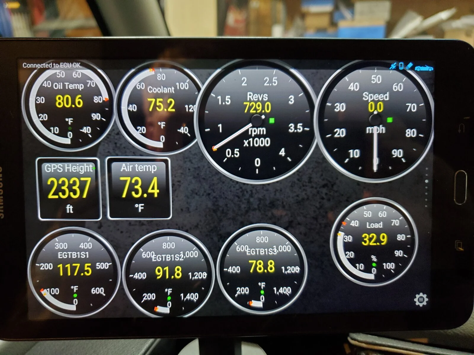

Information is always a good thing. Being able to effortlessly connect to the sensor and watch on my phone while I was warming up and driving how quickly the temperature rose or how it reacted while driving, stopping etc is certainly not a bad thing! You cannot see the temperature fluctuations by watching the analog gauge on the cluster.

I have an IR thermometer. I found that using my OBDII and app was very effective. Not sure why people don't trust sensors; they work very effectively, especially for a simple task like temperature. When you enter any major arena/stadium you can scan your body and determine your temperature.

of course not, but as I stated in my previous post, the gauge is so compressed that 190-230 takes place in about 10% of the span of the gauge, so the scanner provides much better resolution. It seems like you and blaine are making the case that the extra resolution isn't needed, and I'm trying to get confirmation of that, and then an answer to, if the difference between 190 and 230 isn't significant enough to need to be discernible, what range is?

With the Torque Pro app that Actormike is using you can have analog, digital, needles, bars, or a combination of the above. This is what I use on my Sprinter and it is mounted in such a way that I only need to shift my eye to see it instead of peering down under the steering wheel which for me makes curvy mountain roads easier and safer. (There are a few things on a Sprinter to know about if you want to maximize engine, oil and exhaust system life).
I used a smaller version on the TJ and saw temps that the dash gauge just didn't accurately reflect. I don't use it all the time but it was handy to know, in an accurate way, what the dash gauge was saying. In some vehicles the temp gauge is stepped and doesn't move until a certain threshold is reached so you have no way to know if it is on the way up or not so you can take action early.
Then there is the scan tool capability that you always have with you in your phone for reading codes, freeze frame data and live data for things like fuel trim and O2 sensor data.
