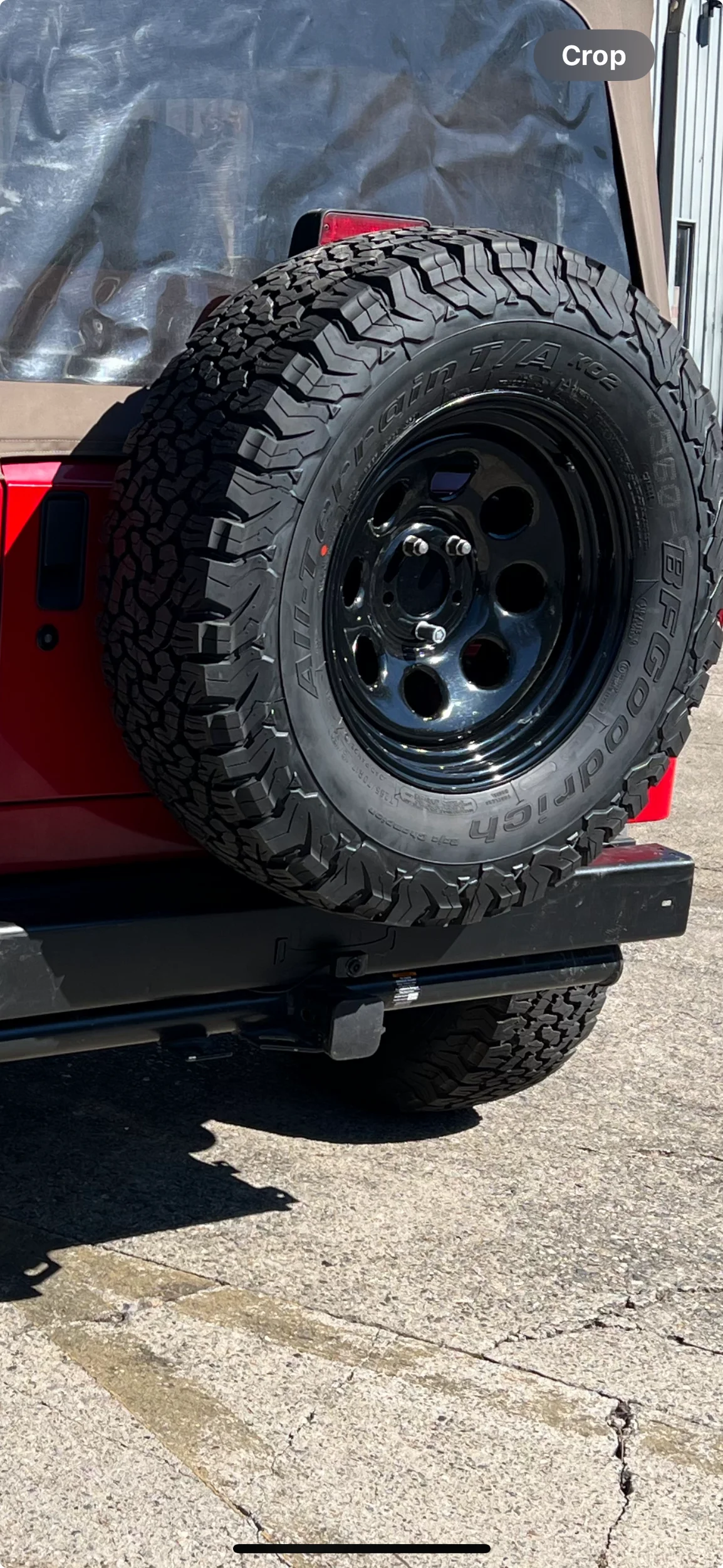

Not exactly what you're asking for but may help. I'm running the MORryde kit with a 33/10.5/r15 KO2 spare mounted on the OEM spare carrier and have a 1 25" body lift.
If I didn't have the body lift, I'd probably need to add the bracket that came with the MORryde to elevate the tire (not currently installed).

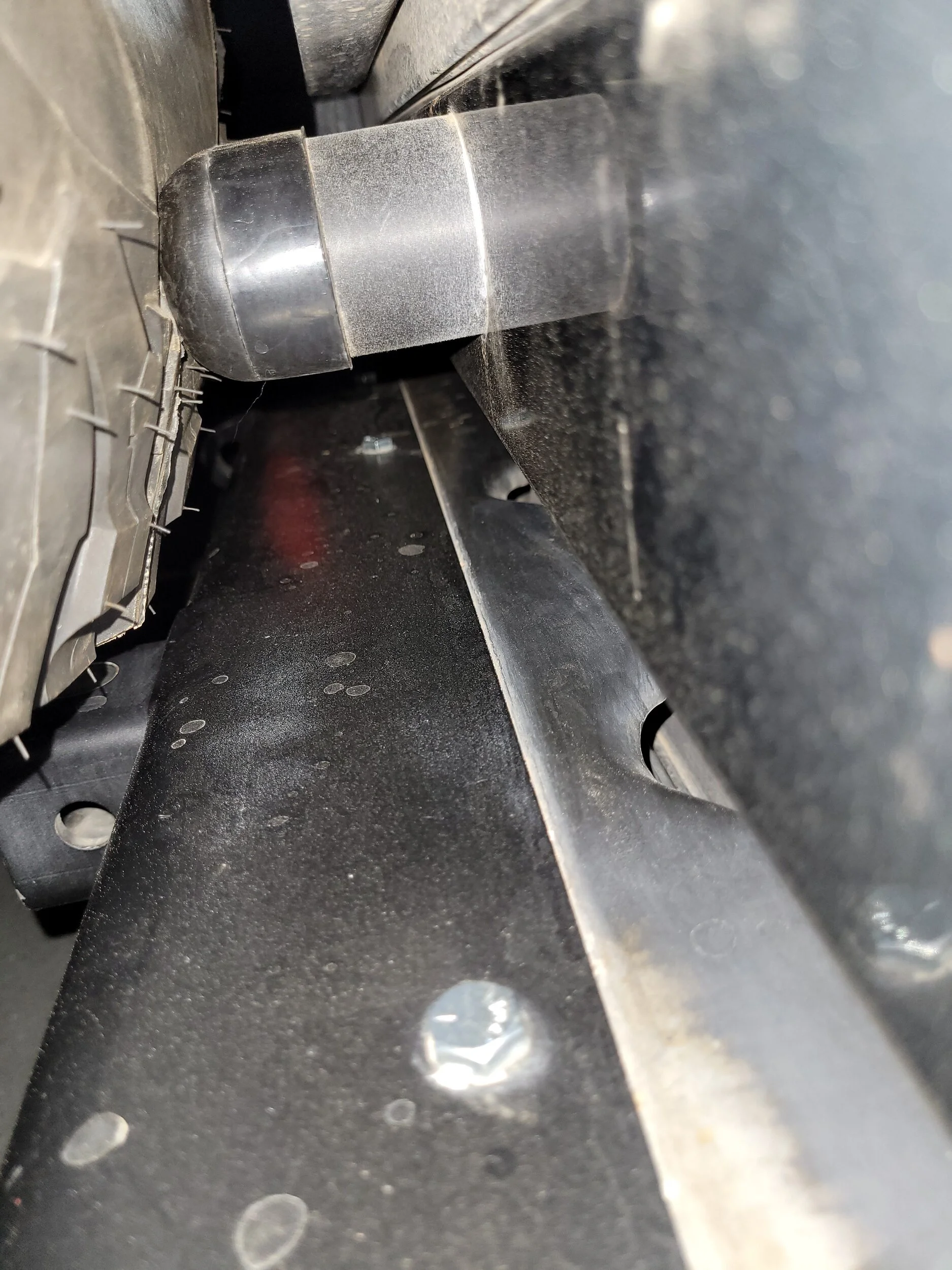

Even without using that bracket, I did have to use the snubber extensions.

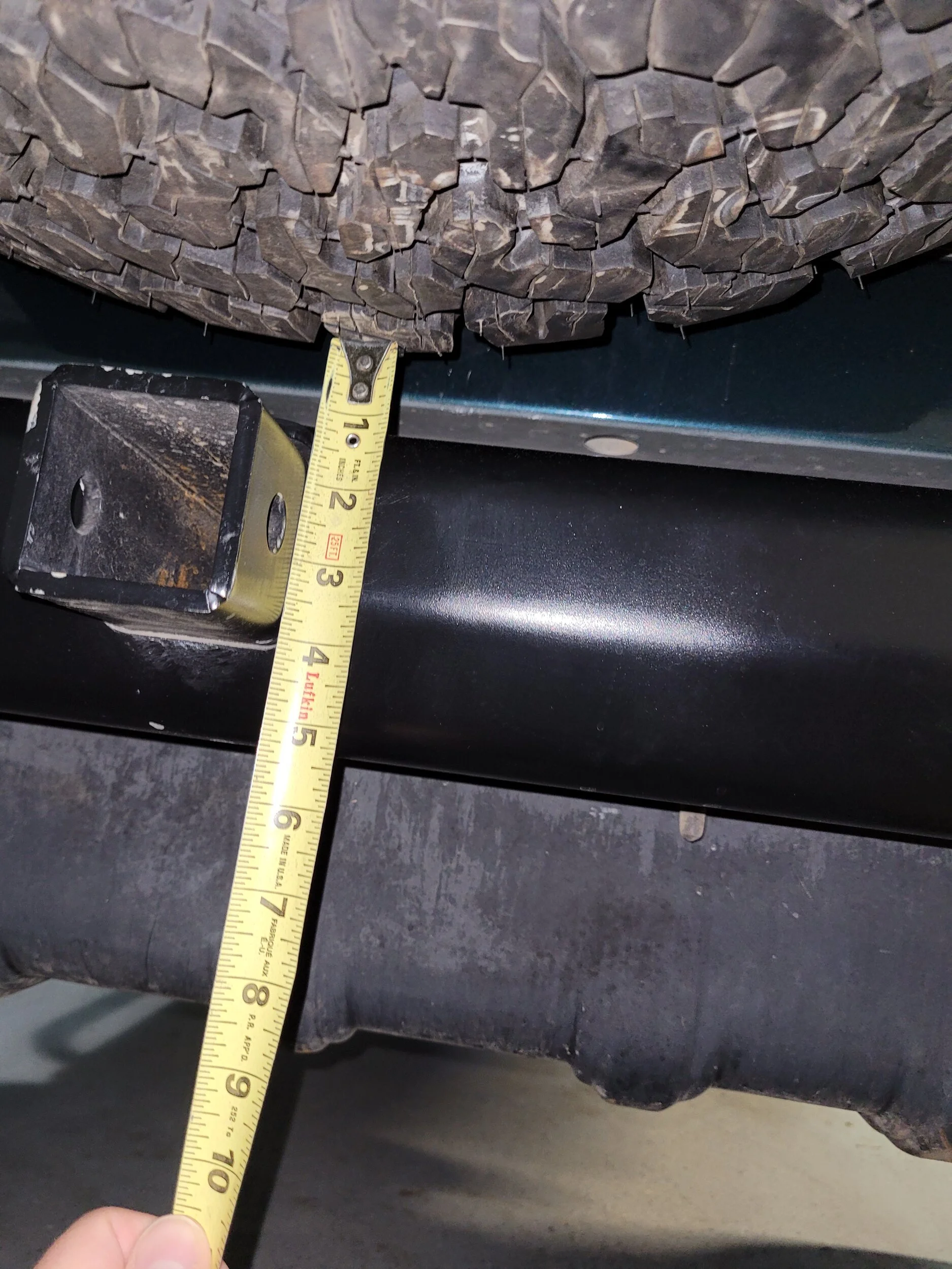

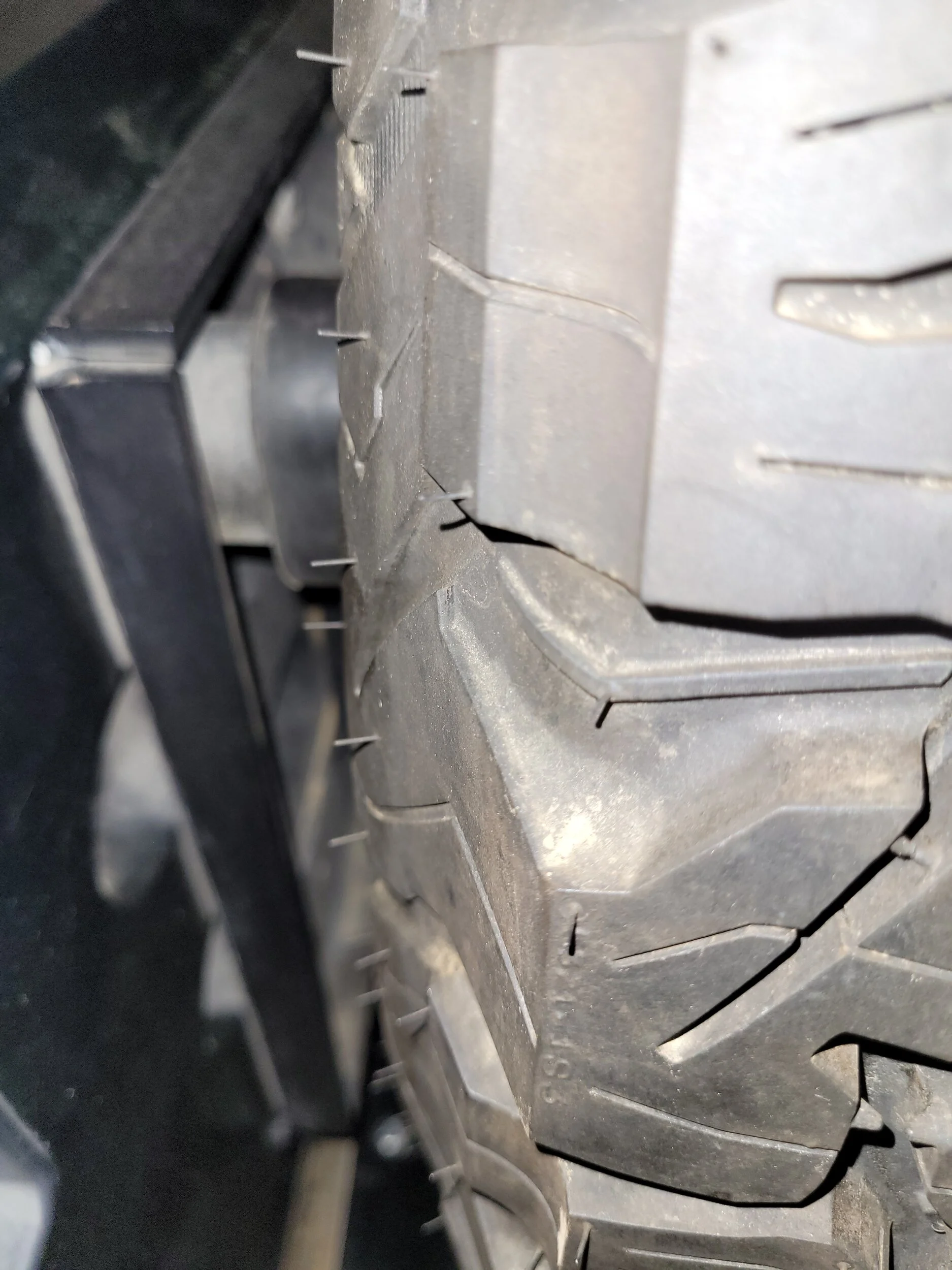

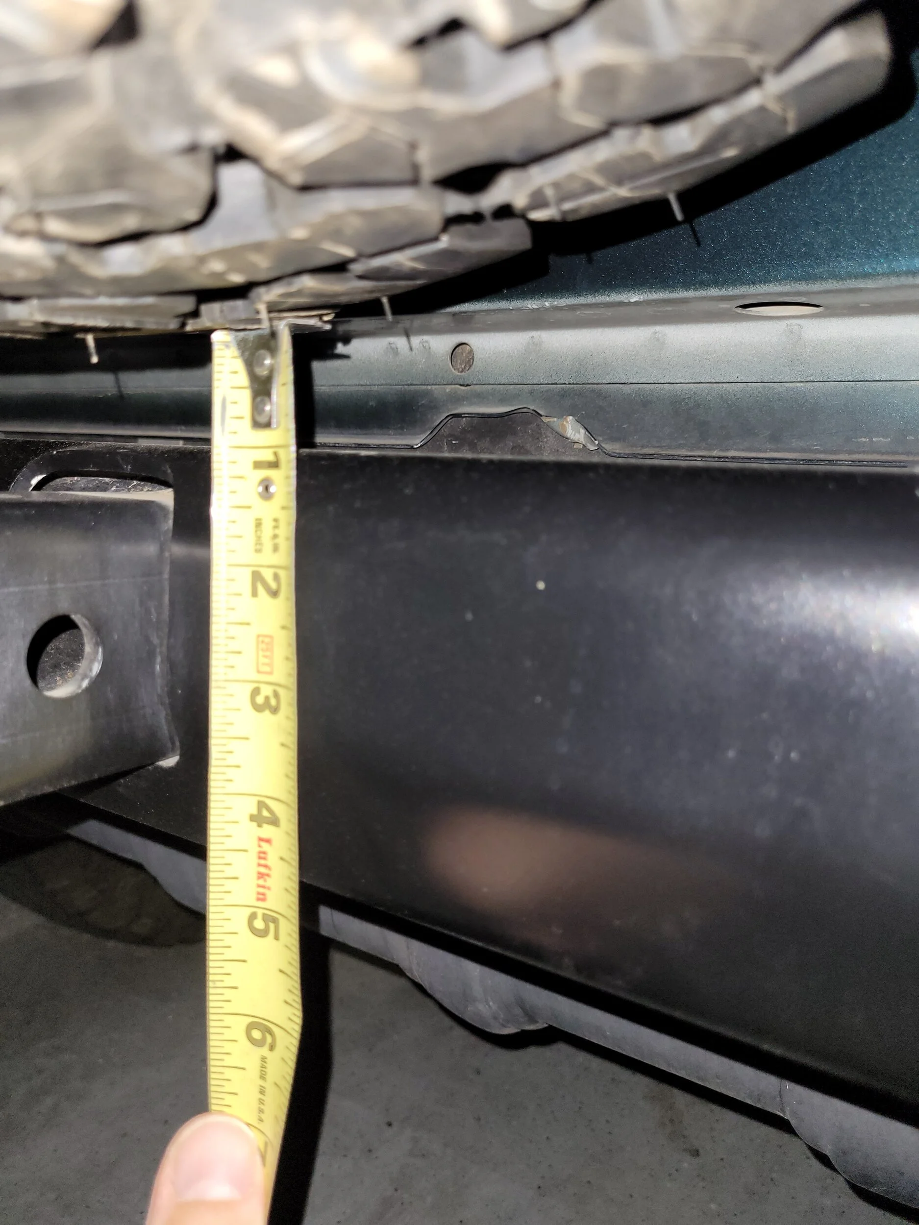

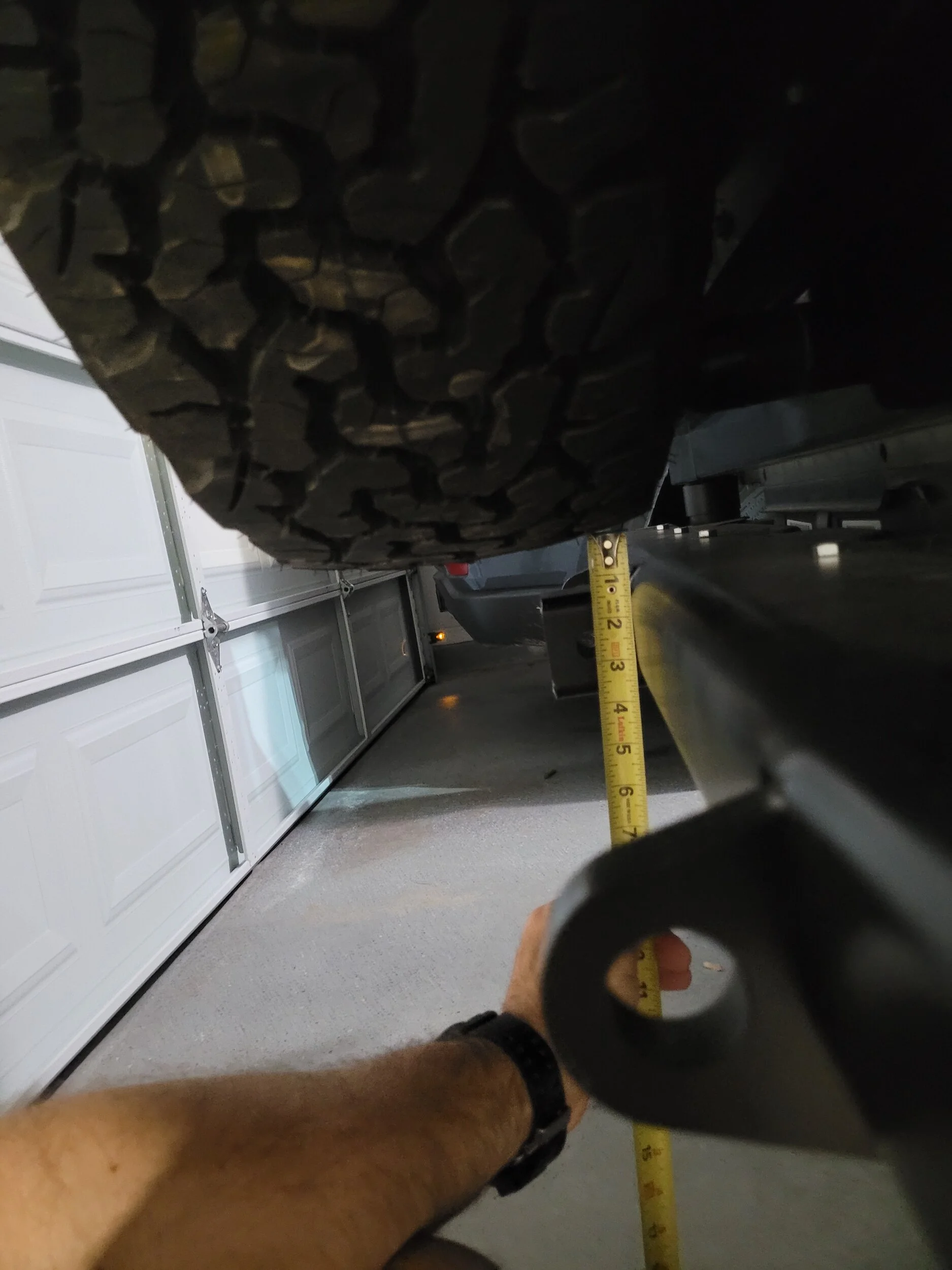

Thank you both. Pictures are great. Based off of these it should be tight fit. but, i think i'll try it without the extra brackets for now. A little rub/resting on bumper aired down might be better than putting it up and further out.
