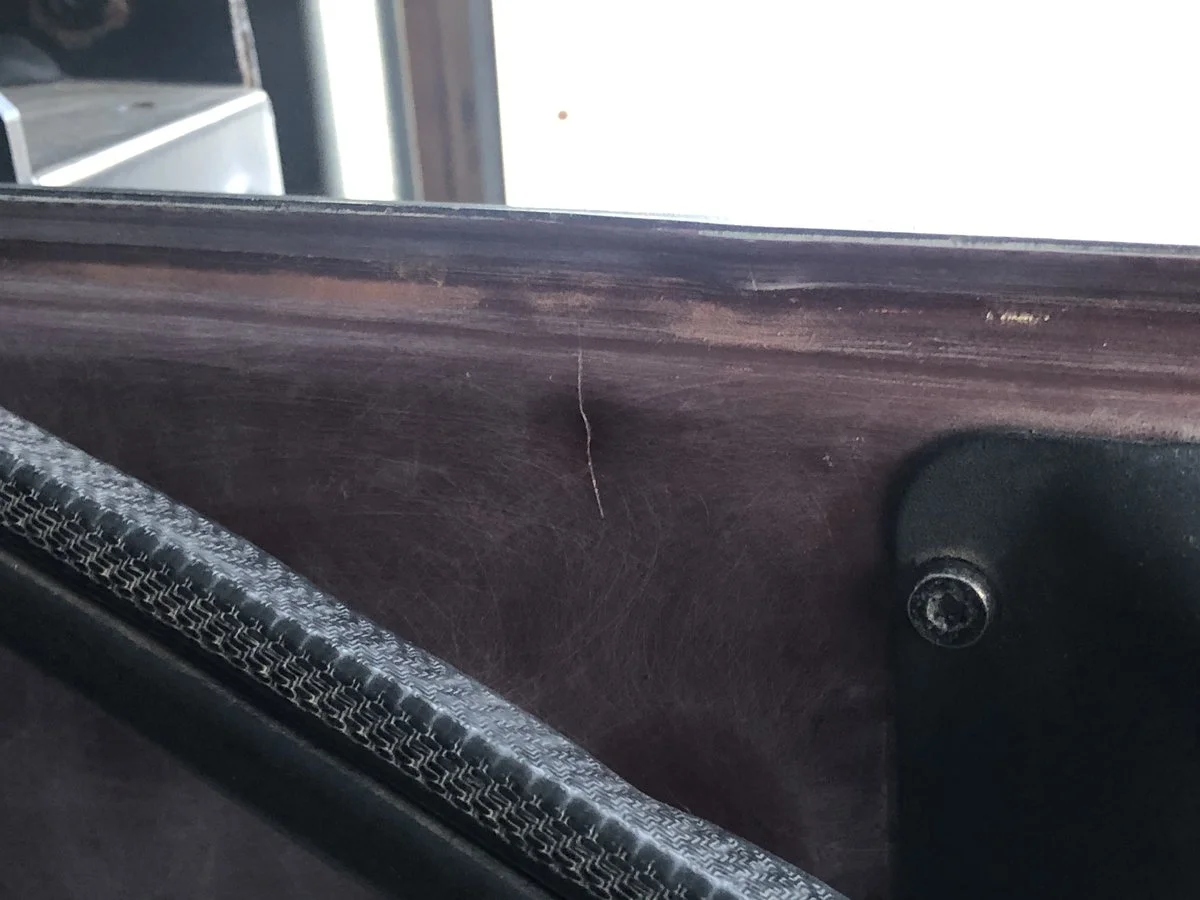

I’ve had mine for about a year and starting to notice some cracking on the tailgate between the latch and bracket.
I suspect it’s possible I hit the spare at some point. Don’t remember it but certainly possible.
Im still happy with the product but something to watch.
My door cracked in the same spot with 31on it with the stock hinge/mount setup.
I think it's from hitting something, not the size of the spare.

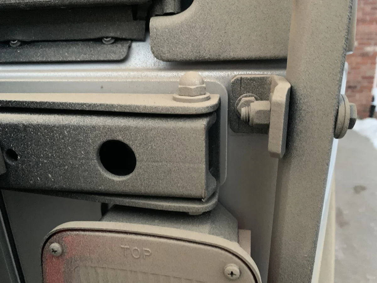

Yes, I cut down the passenger side top rear bracket. Then I used a large 3/16 backer plate on the inside.
Here are some super dirty pics I took when I got home tonight. Also, upgraded one size in bolt diameter to increase clamping force.

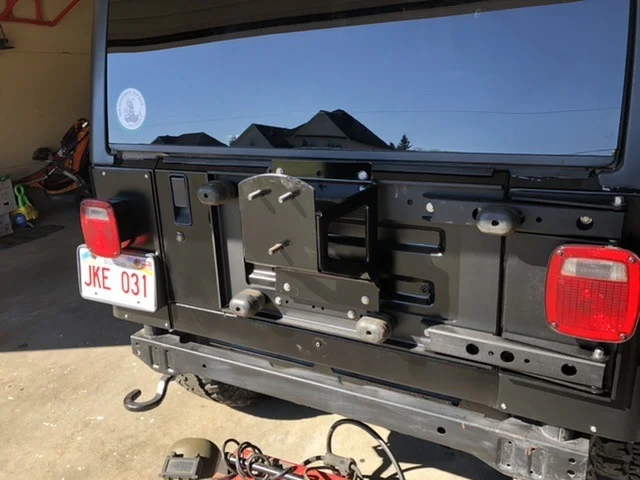

I just took apart the stock carriers and bumpers to do a once in 21 year inspection, clay bar and waxing of the tailgate. Now would be the right time to add the hingesIMG_20200217_143538.jpg
