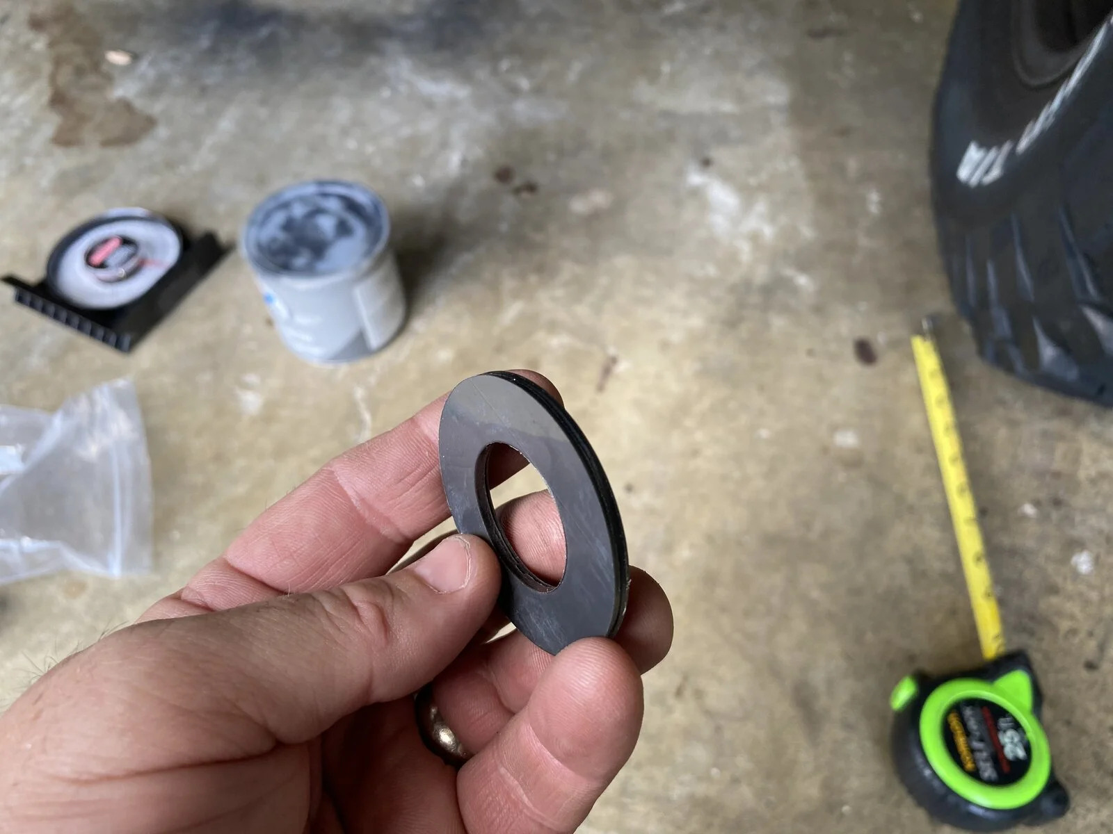

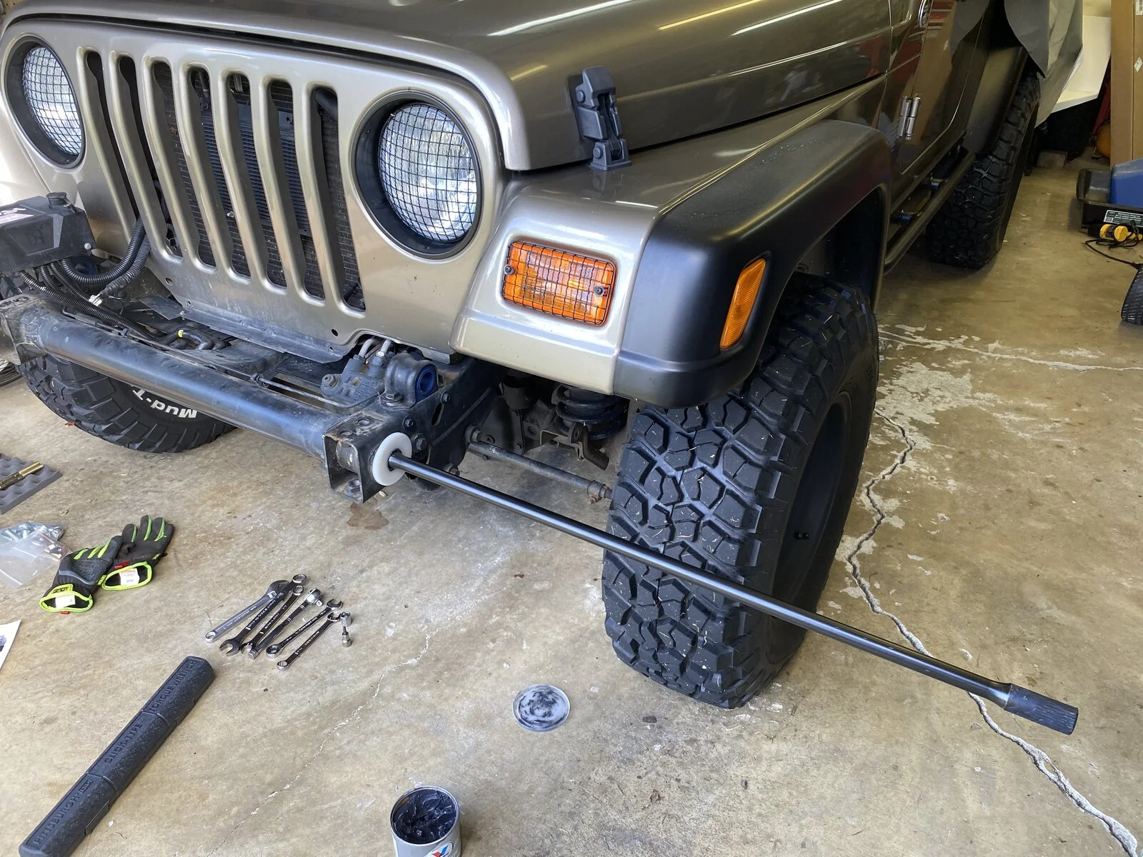

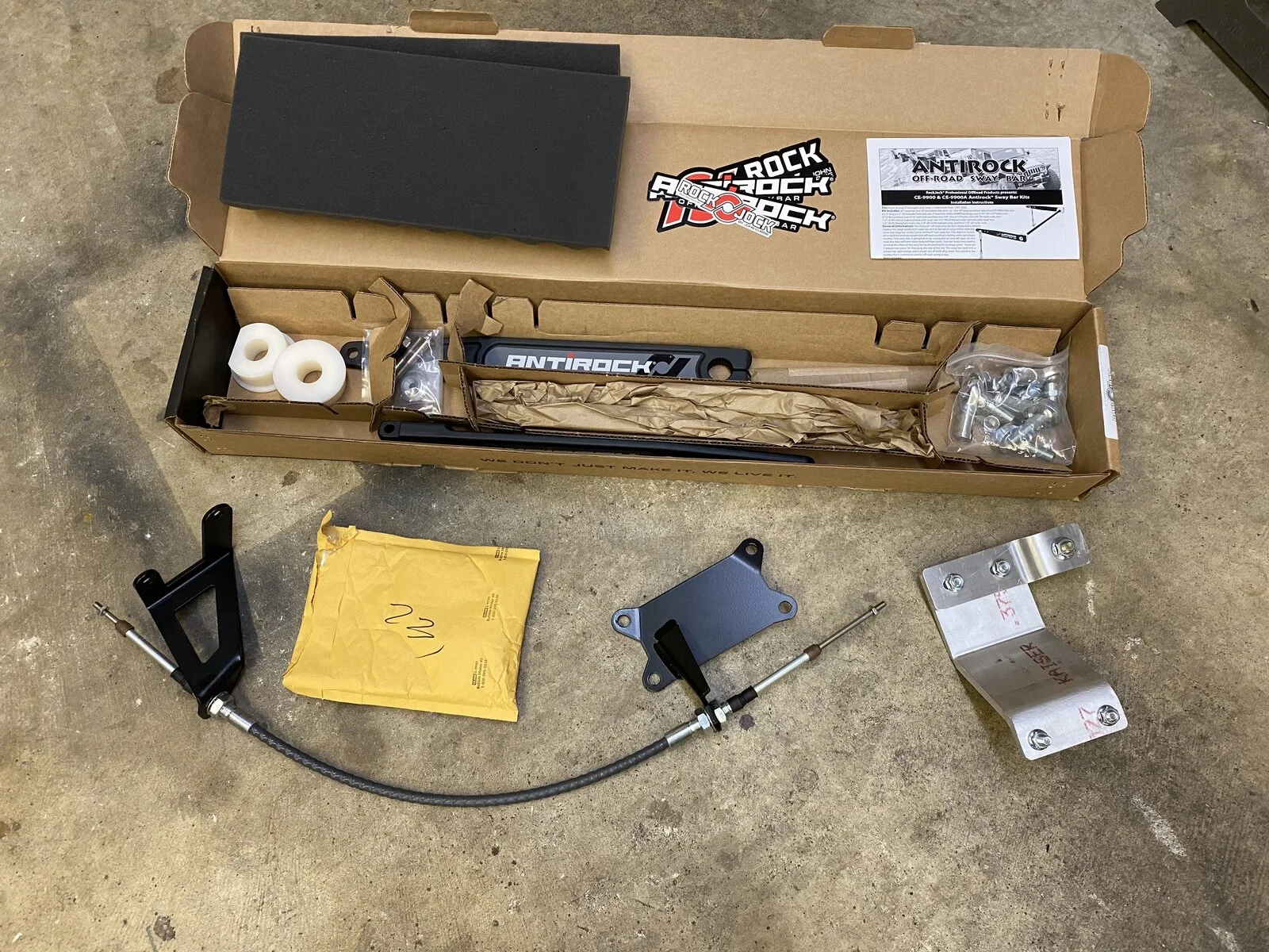

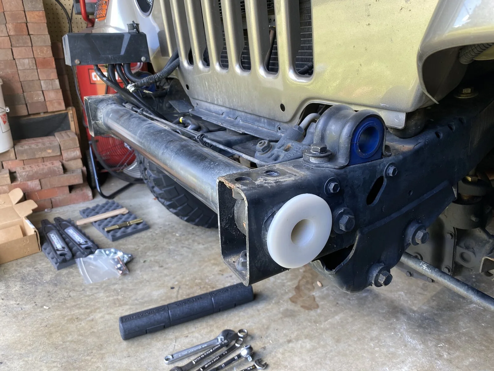

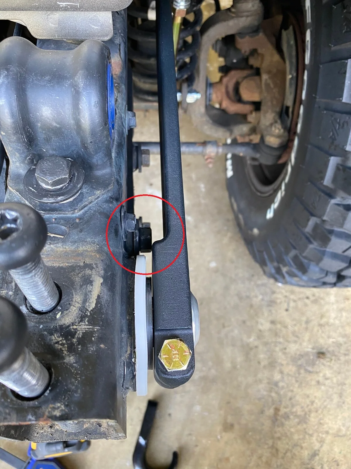

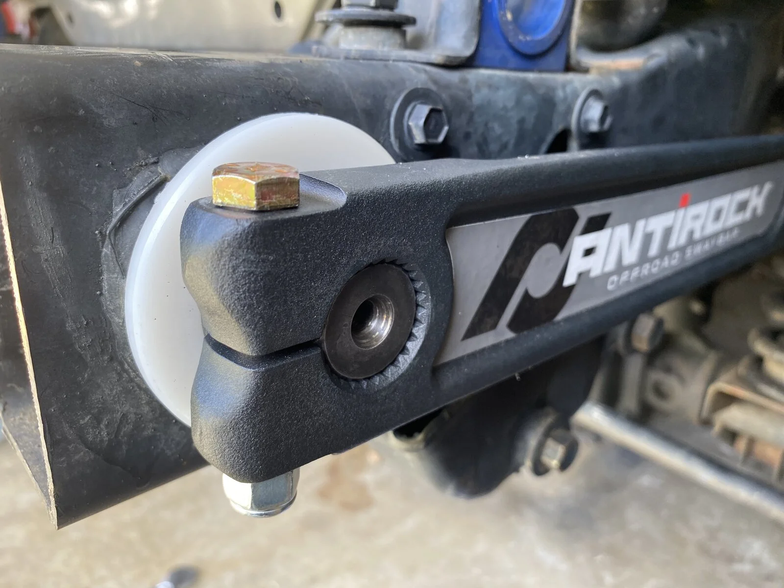

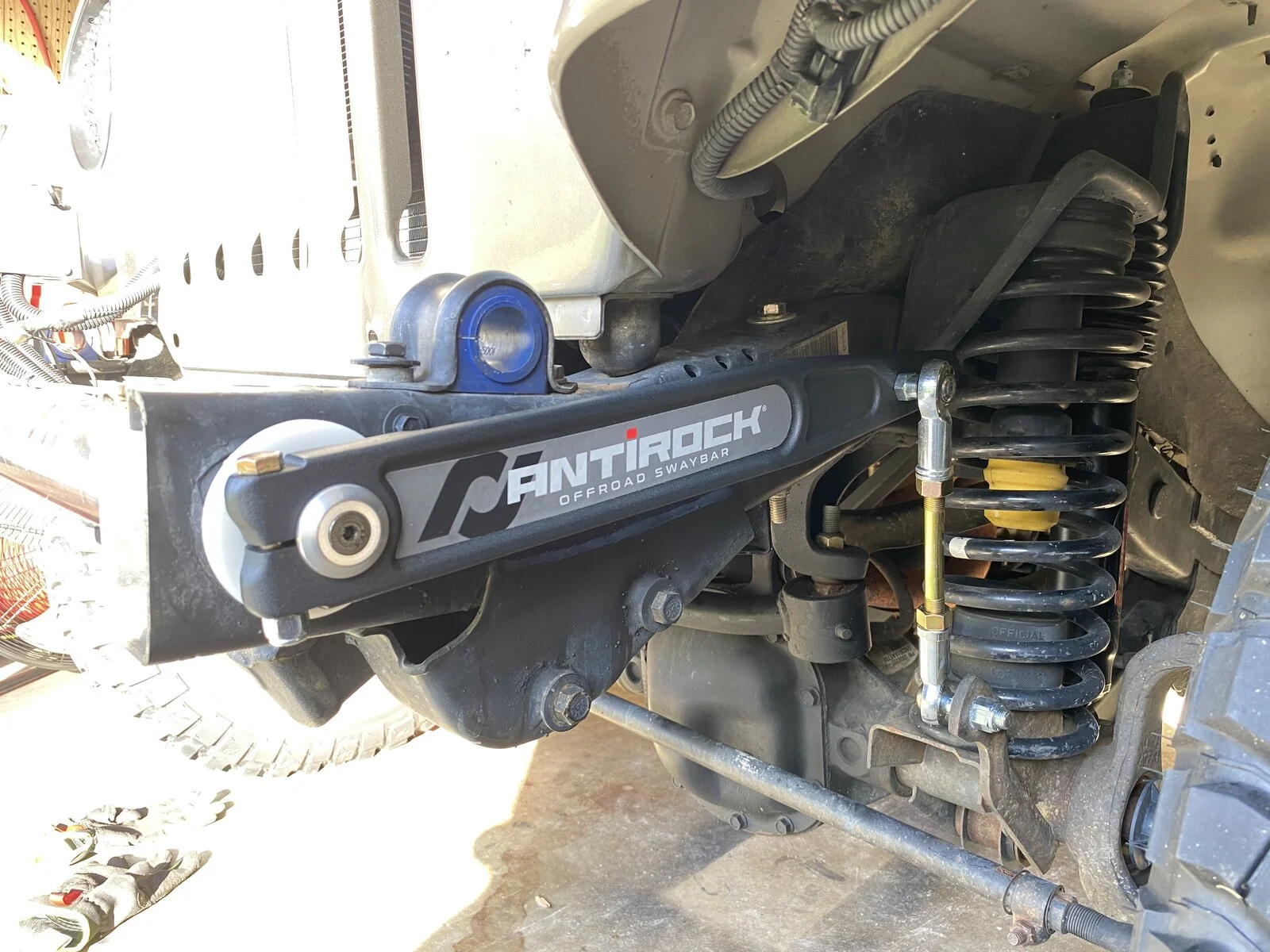

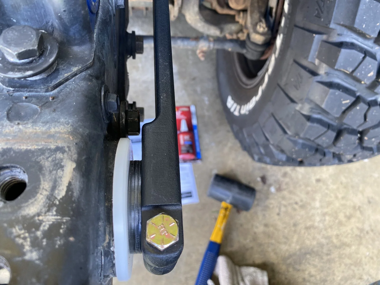

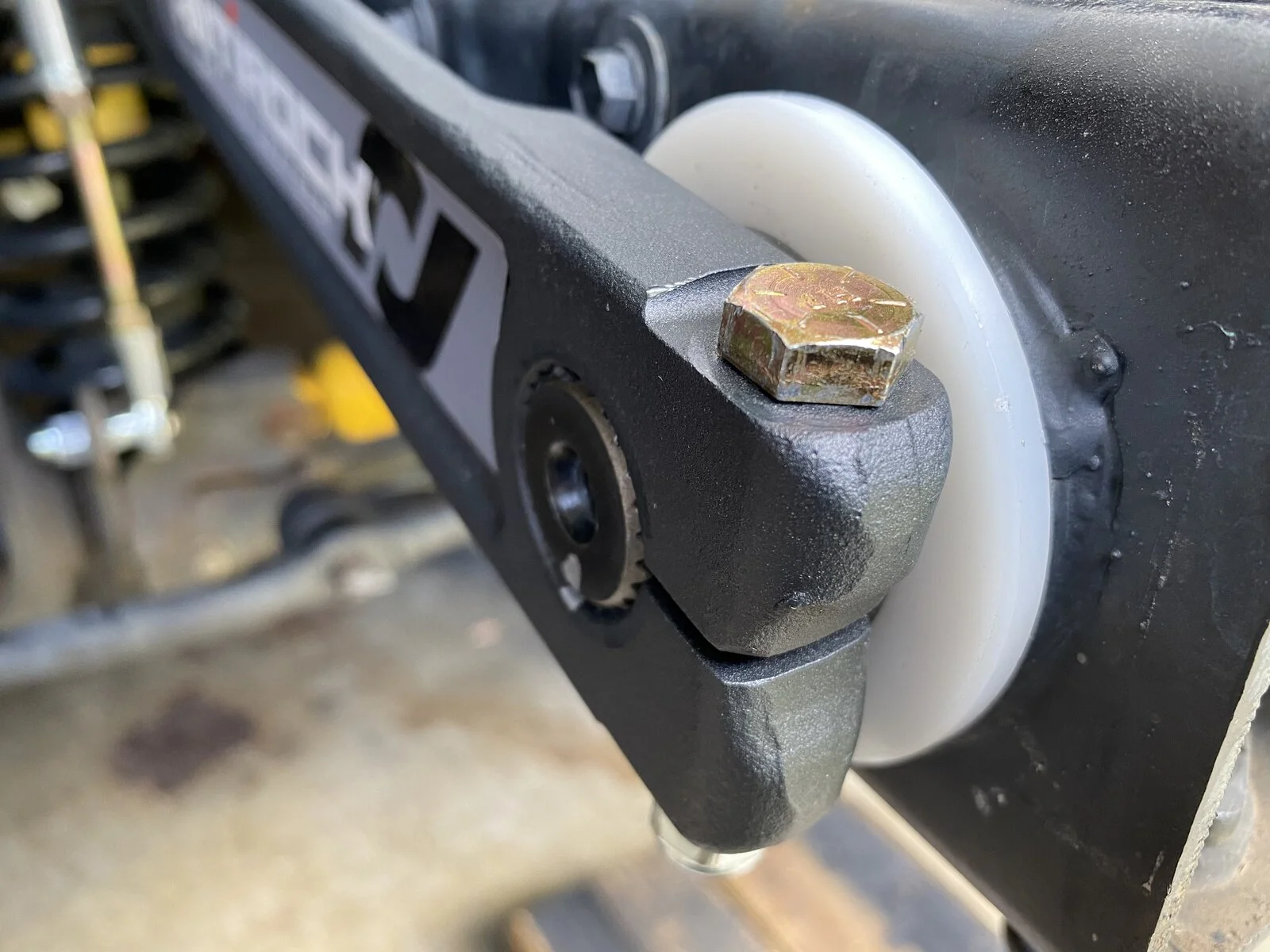

Got the Antirock installed. I used some hard plastic spacers that that I seen @mrblaine recommend putting between the arms and the white bushings to keep the arms all the way out on the ends of the torsion bar. (McMaster-Carr P/N 91545A390) I actually put two per side and the arms are just slightly past flush with the end of the torsion bar, but I donā€™t think it will hurt anything.
I set it on the forward most setting today. Iā€™m going to try the rear setting tomorrow and see which one I like the best.
View attachment 201863View attachment 201864View attachment 201865View attachment 201867
View attachment 201866View attachment 201868
Remove one of the spacers and get the arm flush. You need to maintain all the spline engagement.
Reactions: MountaineerTom
The arm isn't contacting this bolt is it? Hard to tell from the picture.
Reactions: Alex01

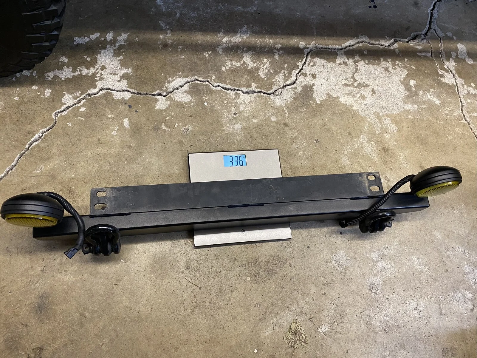

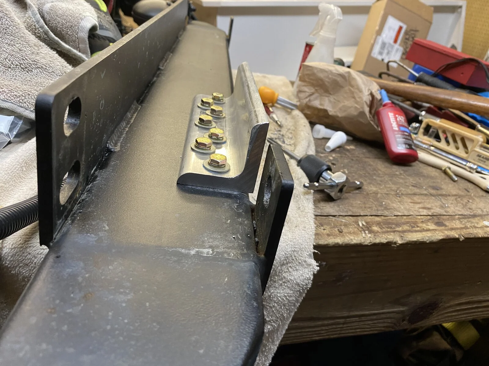

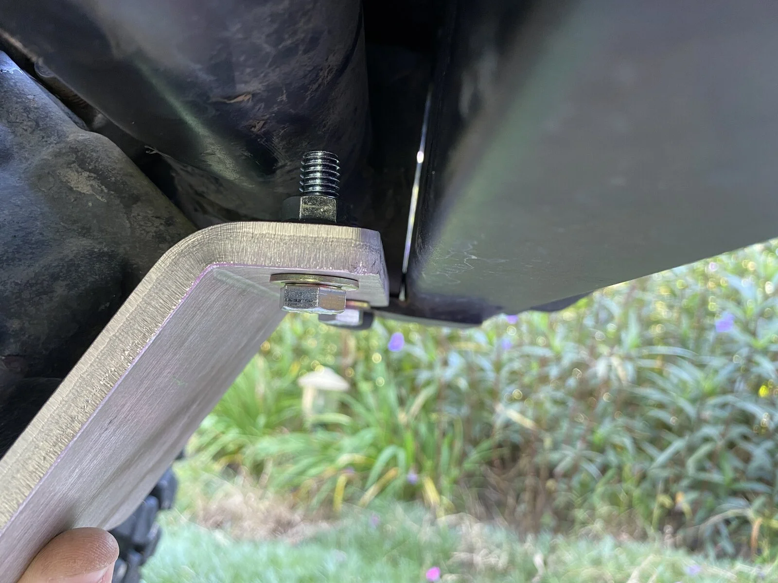

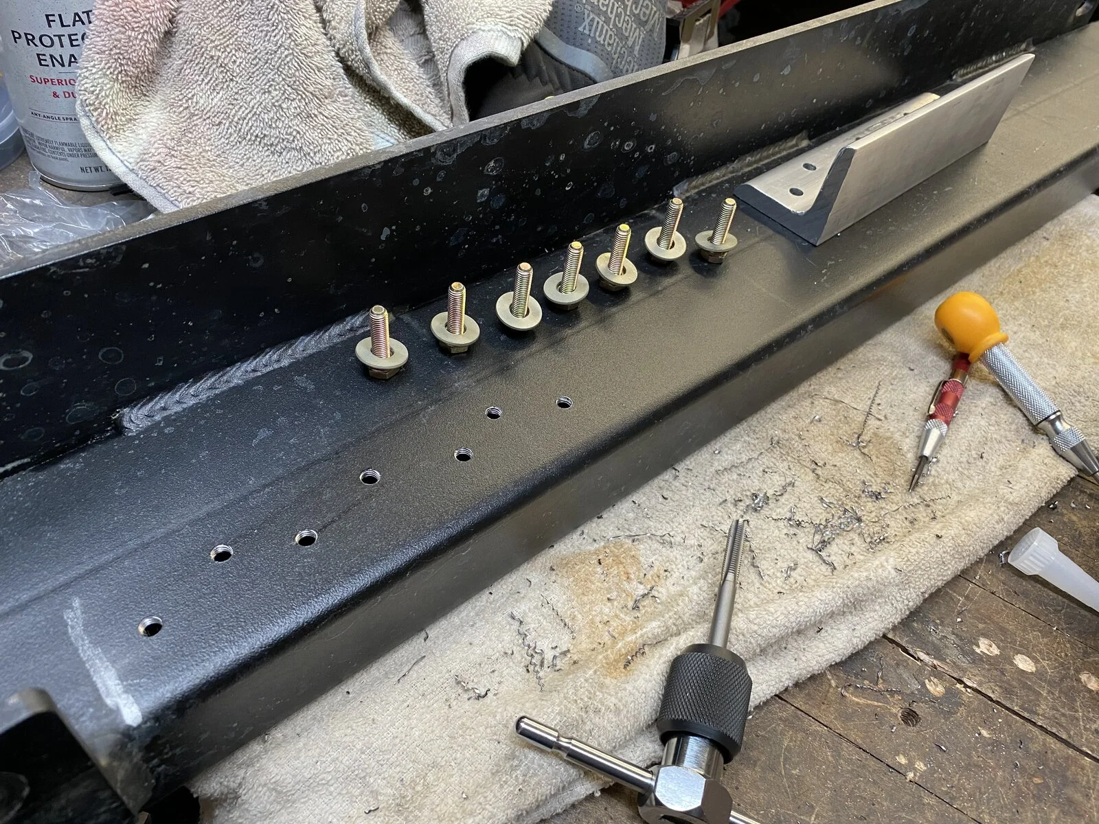

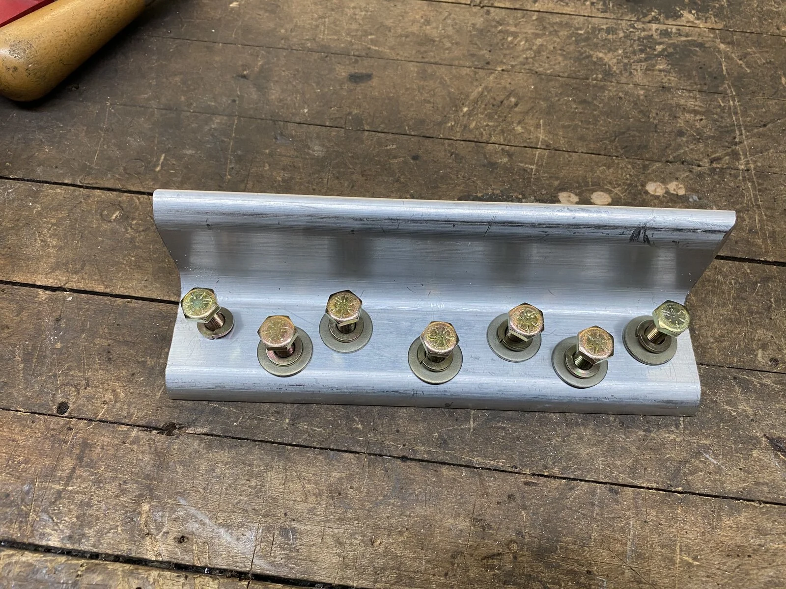

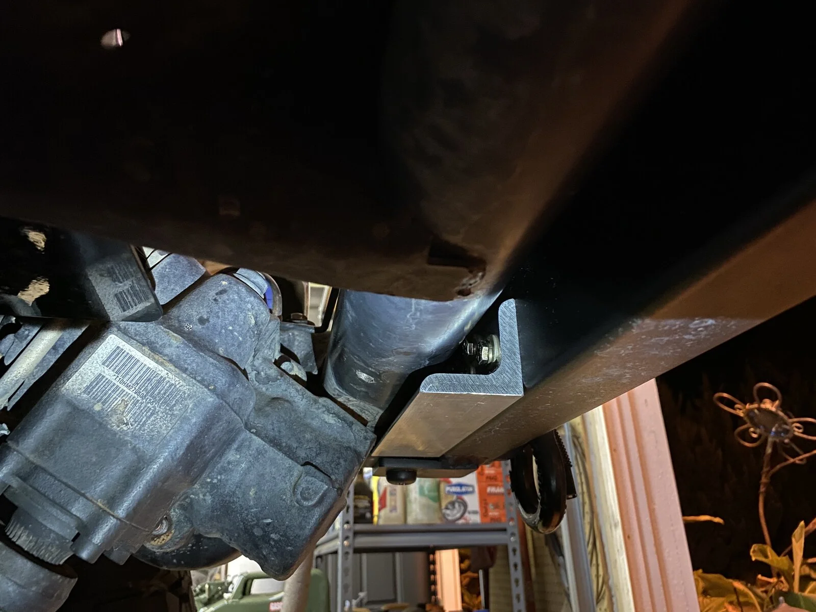

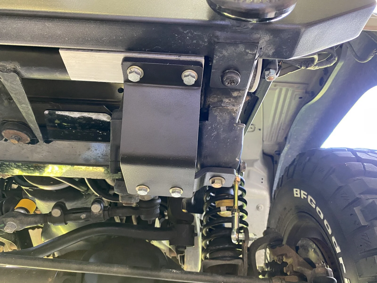

I made a bracket to put on my LOD front bumper so that the Savvy steering box skid will mate up to it. Thanks again to @mrblaine for the hardware tips. Got this much of it done and plan to finish it up tomorrow.

Nothing wrong with that.
Got the steering box skid installed.
An easy way to get the serrated nut to line up right the first time is to run a zip tie up through the hole and out of the opening in the corner and slide the nut down it.
