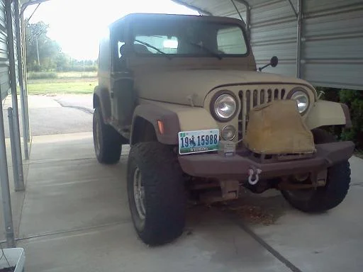

Jerry, I have had one on the side of my jeeps for 30 years, just bolt it to the passenger fender. If you get hit on the driver side, Kaboom. I used fender washers and about 3/4" tubular spacers to clear the antenna. I use the Military blitz mounts and cans...
