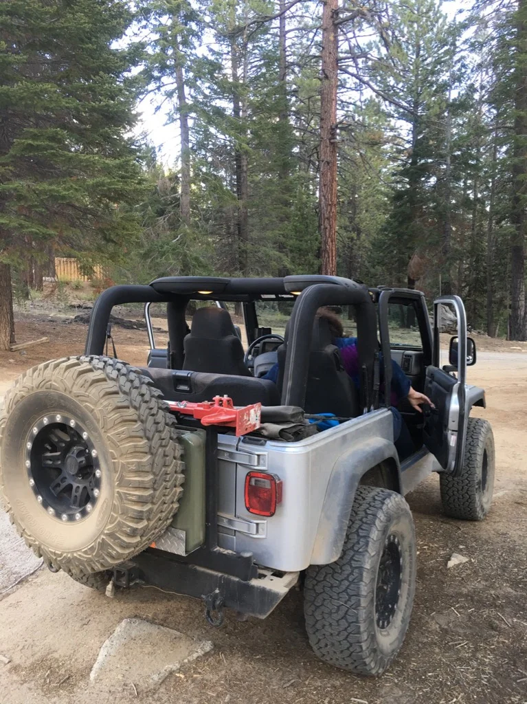

They seem to be out of stock. No fuel smell whatsoever. Very durable. I have two that I mount to my tire carrier. But, only when we are going somewhere I might need the extra fuel. I have yet to have needed them. I generally only carry the spare tire for any other driving and not the other junk. However, I feel much more confident when my gauge starts towards empty in the middle of nowhere and I have that extra fuel.
I got the bumper from a friend. It appeared that Nate’s 4x4 had almost the same bumper. Sadly, their site no longer works, perhaps they closed up shop.
I have Nate's rear carrier with the Jerry can option (Very different than what is in your picture). Except for the trailer spindle hinge, every part that makes it what it is is poorly designed. Over the last 5 years, I have cut off and remade every meaningful part of the carrier.

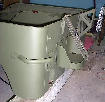

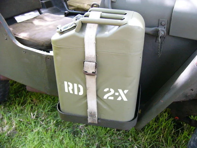

Nonsense. Jeepers have been mounting jerry can holders to jeep bodies in front of the doors since WWII. Typically the cans were mounted in the rear but If done correctly the side of body is definitely strong enough.
Let' not forget that Willys used to mount spare tires to the side of the civilian jeep body as well:
As noted above in post #18, Jeff Scherb's well designed side mounts are available here: https://www.extremeterrain.com/barricade-jerry-frame-mountt-j102520.html and here http://www.retrofitoffroad.com/product-category/jeep-jerry-can-carriers/

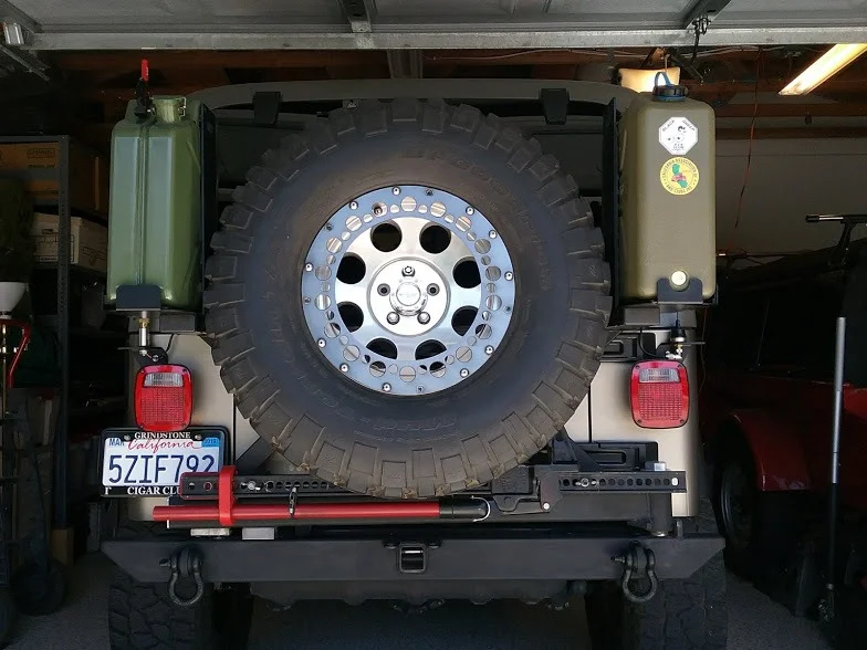

BTW, this is my jerry can solution. It isn't for everyone but it works for me.
