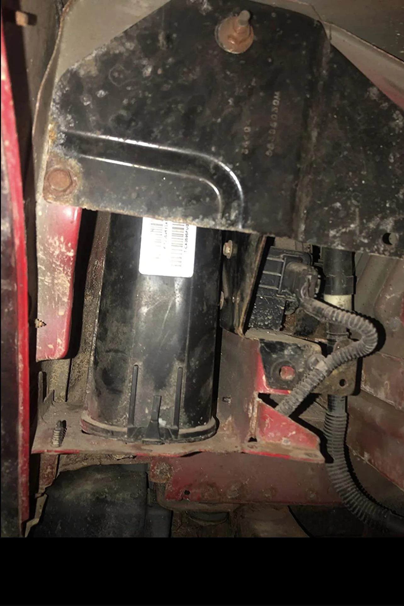

Drivers side you can access inside rear from fuel cap area
Pass side gotta jack it up, remove wheel, and remove inner fender mudguard or whatever its called.
Then remove a inner fender bracket to the right of the EVAP can, and you can get 3 of the 4 bolts on for tail light.
If you want the 4th one, gotta remove that EVAP can. I didnt bother, 3 bolts for a year and locked up solid, however if you have OCD ……
https://www.jeepforum.com/threads/rear-03-evap-canister-removal.463542/
I used a socket on a small drill with an extension
Heres the pic of the inner passenger rear fender after removing that plastic mudguard panel
Iirc that top black plate is what I also removed to gain entry to the rear pass bolts coming in

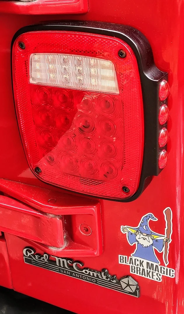

I had the same problem and ended up using a suitable quantity of black MS Silicone on the RHS.
Still drilled (& primed) the holes nice and neat and slotted the unit on.
Dont push it on too hard, you need enough space to get a craft knife blade in there in case you ever need to get it off!
It aint going anywhere, trust me!
Dont forget to add some reflectors or your will fail your WOF, they were built into the old units in NZ models.
