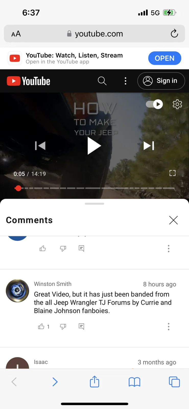

“banded”???? ”fanboise”????
don’t know who it is, but they need to re-take Spelling
