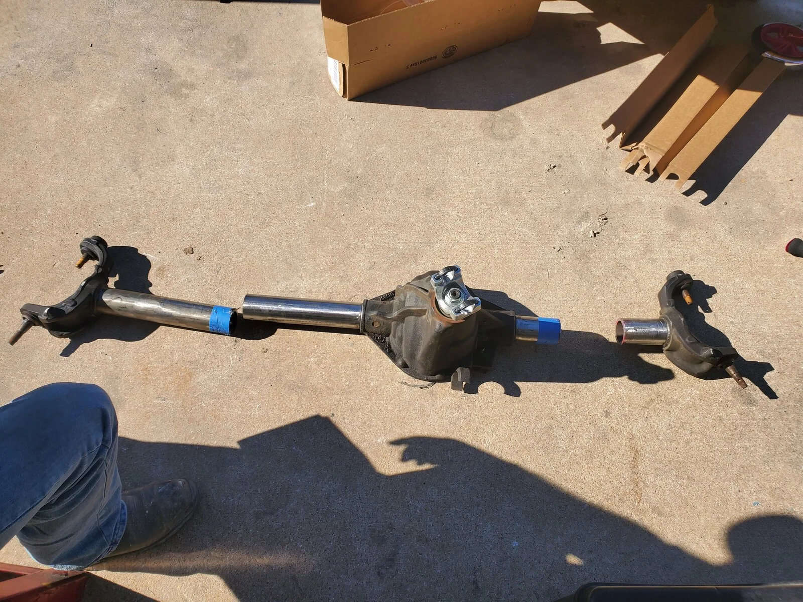

B00mb00m The Church of Cutting Brakes of Atlas-Front Digs Supporting Member Ride of the Month Winner Joined Jul 26, 2019 Messages 3,498 Location Washington Dec 23, 2020 #22 softballnrd27 said: View attachment 212488 Click to expand... See JK axles are so weak they can just break into pieces sitting on the ground!! Assuming you're doing external sleeves? Are you running Coilovers in rear? Looks like your spring won't sit in the frame bucket area in rear.
OP softballnrd27 TJ Enthusiast Supporting Member Joined Sep 7, 2017 Messages 134 Location Harker Heights, TX, United States Dec 23, 2020 #23 Yes external sleeves, Clayton truss, Artec c-gussets. A lot of work but less than 1/2 of what an upgraded housing would have cost. Trying to find ORIs in stock but coil-overs will be ordered within the next week or so if I can't find ORIs.
