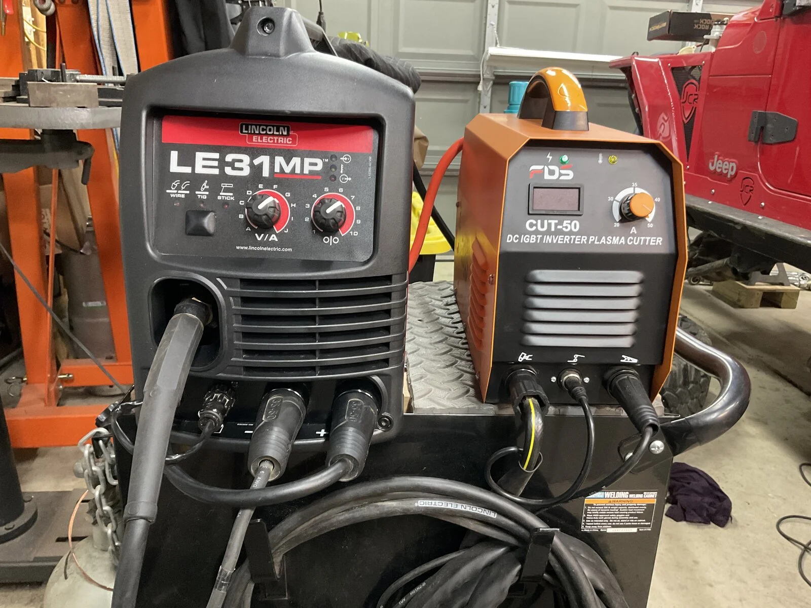

After all day trying to get a nice MIG welder and no find any else than HB or boxed stores machines one of our customers offer me his Lincoln LE31MP i exchange of an RGB Pixels Christmas lights setup. So far is OK. Can’t wait to have Argon gas and test the TIG side.
Thanks all for the suggestions. If the LE31MP doesn’t cut it I will go with the ESAB rebel 241.
