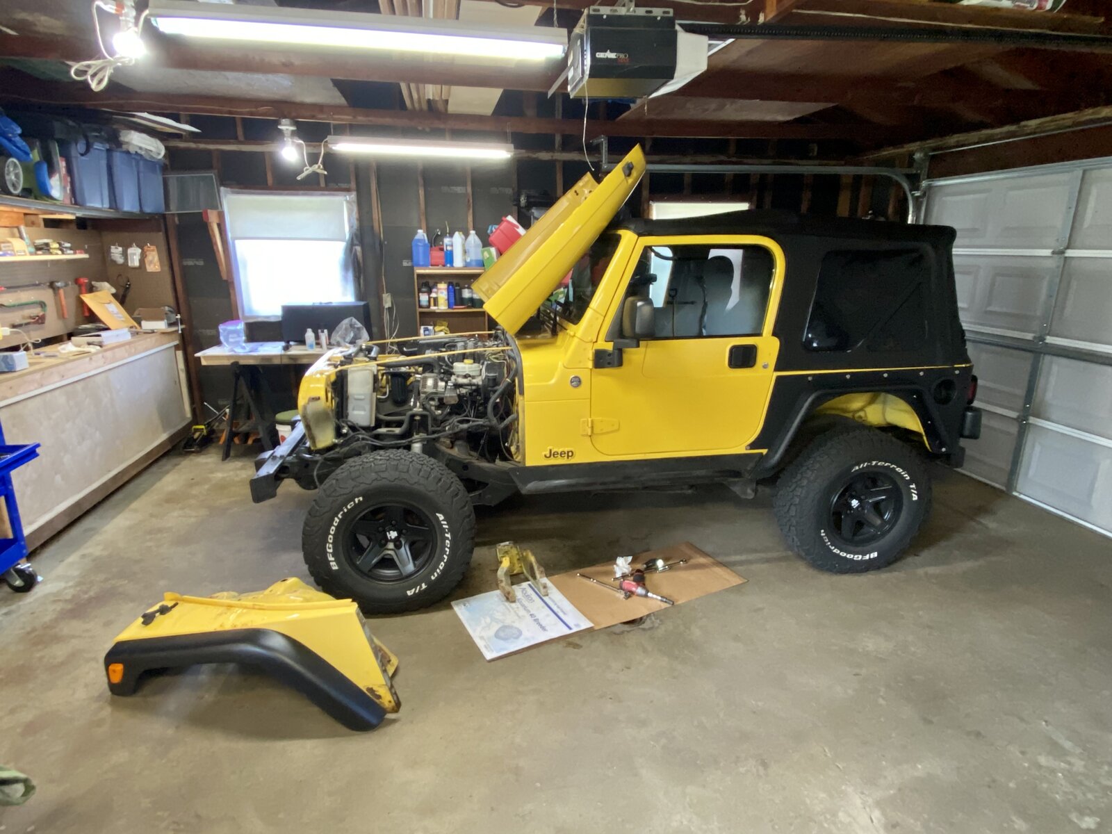

I installed the corner armor and a set of Smittybilt 3” rear fender flares and then decided to attack the front fenders since the shoddy repair was bubbling up and rusting again.
This was when I decided to just get the parts I wanted instead of making more compromises I wouldn’t really be happy with.
I new that I wanted to swap out the stock fenders for a flat style but I don’t care for most out there. MetalCloak was the one real exception so I pulled the trigger and ordered a pair of overline fenders with 4” flares. The quality is fantastic and the look is so badass.
They have a larger wheel well so the rock sliders that were on the Jeep when I bought it were now too long. Extending past fender. Instead of replacing them I just cut the overhang off with grinder and made it work.
I thought it would suck but it looks good IMO.
